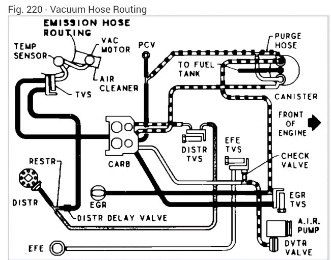

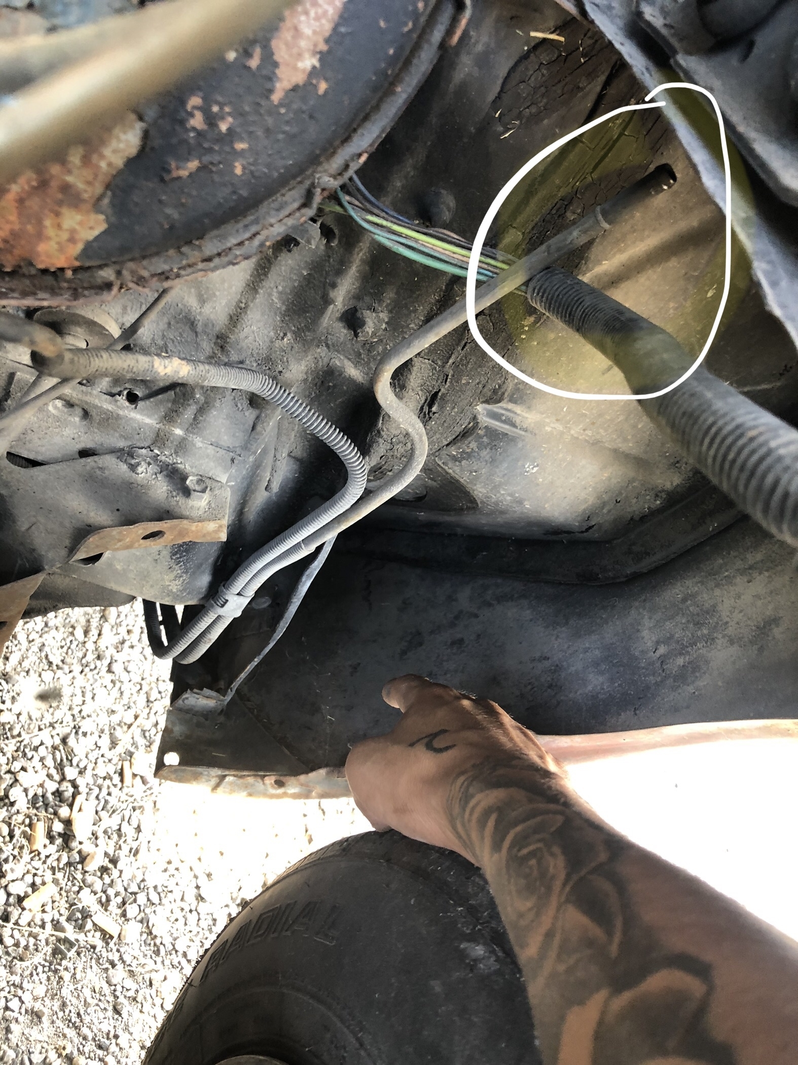

In the white circle line is the vapor fuel line and I don’t know where it connects too. Can someone help me with figuring out where it is supposed to go?
In the diagram it says fuel vapor canister but there is no such thing as a canister that looks like that for my car.

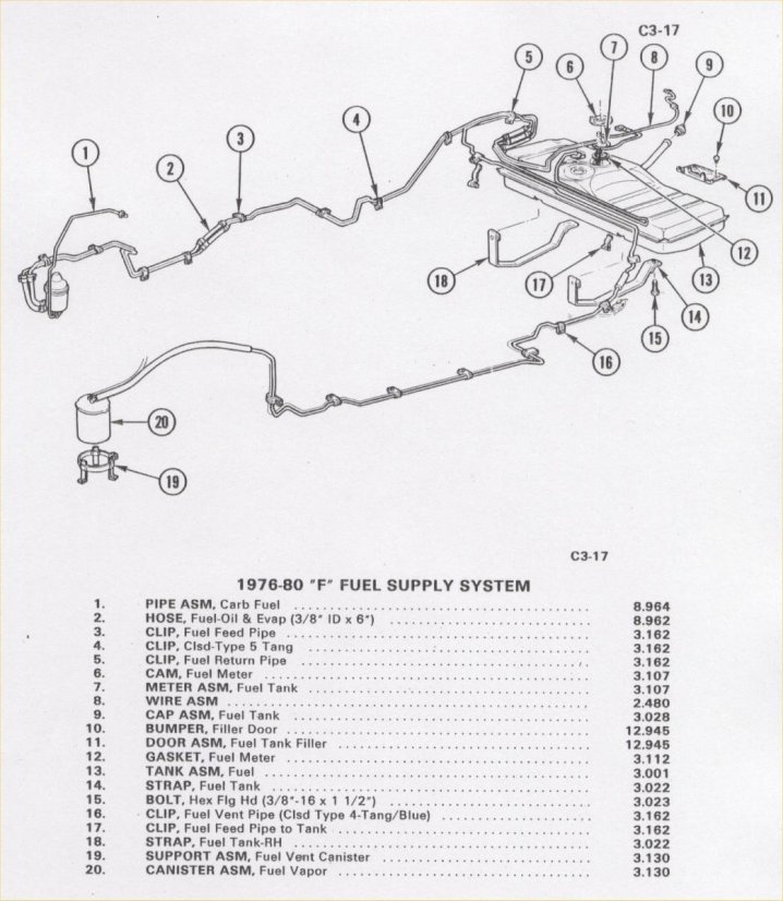

It's hard for me to tell where I'm looking in pic 1. The vehicle would have come with one. It would have been located on the driver's side under the hood at the front of the engine compartment. If I recall, it would have been either near the frame or it may have sat down inside a mount.
Take a look at the schematic I attached below. See if it helps you locate it. If I'm correct, I see the transmission bell housing in the pic, so it will be on the opposite end of the engine compartment.

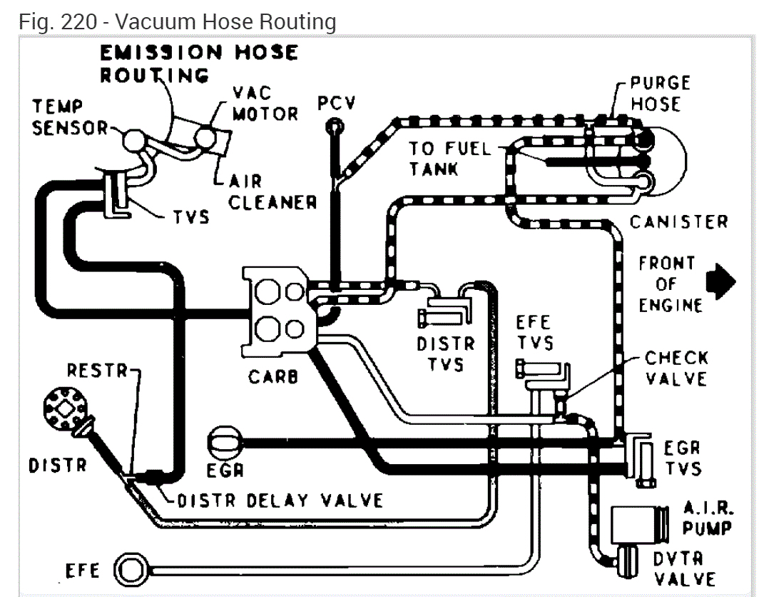

Also, could the steel line in your pic run to the vacuum modulator on the transmission?
See pic below.
