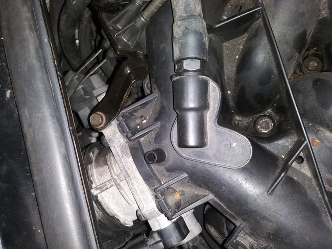

Replaced engine. I cannot find the vaccum line that goes on the back of the intake manifold near throttle body. Where does thus line originate? And what is its function?

Here is a photo.
Jul 23, 2020 at 7:04 PM
MVANN74
  • 65 POSTS
That port just to the left if the PCV valve.
Jul 23, 2020 at 7:05 PM

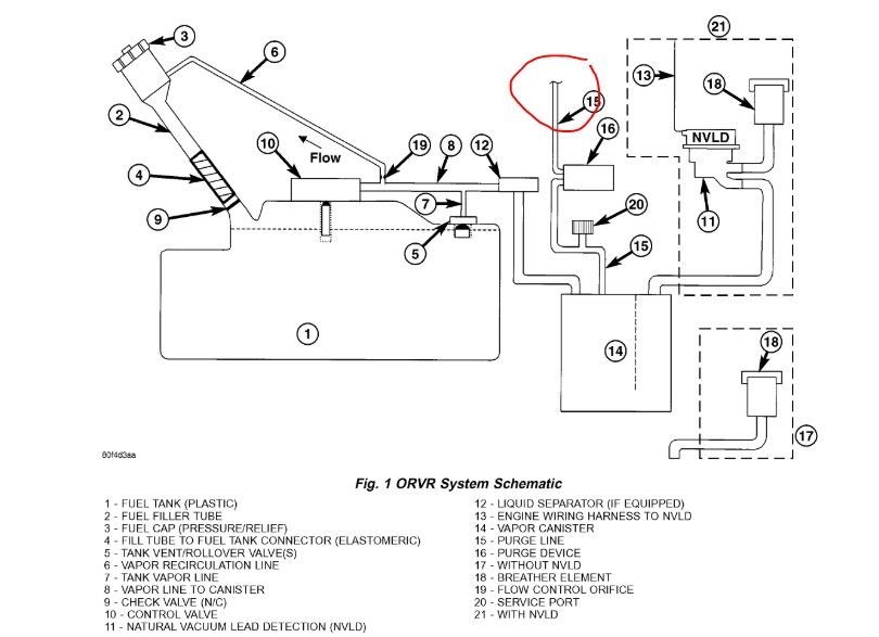

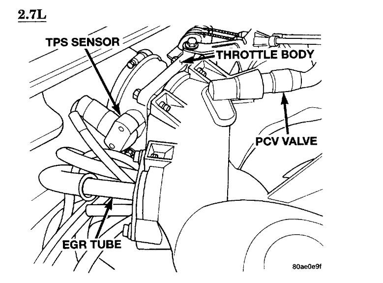

That looks like the line that goes back to the fuel tank for the evaporative system.
Look for a loose line that goes back to the back of the car.

I found it. Had to remove the intake manifold to get to it.
Thank you for the advice.
