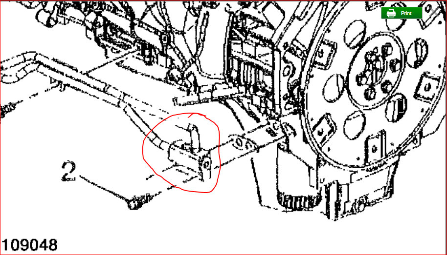

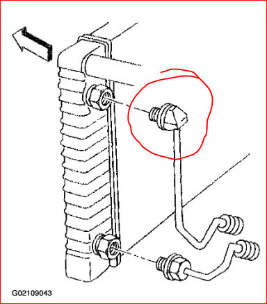

I need to know where I can drill into the aluminum block at the end of my oil cooler lines that mount to the oil pan on my Chevrolet lq4 so I can plumb in a mechanical oil pressure gauge.

Hello again.
I have attached two pictures. If you follow the Upper cooler line from radiator (circled) to the adapter block that mounts to the pan that will be the pressure side of the two. Hope this helps.Thanks again for using 2CarPros.
Danny-
Sep 30, 2018 at 2:23 PM
WHITE03SILVERADO
Thanks I figured the return line would be the best place to get a reading
it made more sense to measure the oil pressure going into the motor rather than the pressure of the oil leaving the motor.

Hello again.
Yes, you would get a higher P.S.I. reading under pressure than at the return. Hope this helps.Let us know how things work out. Be careful when drilling/tapping with the shavings.Thanks again for using 2Carpros.
