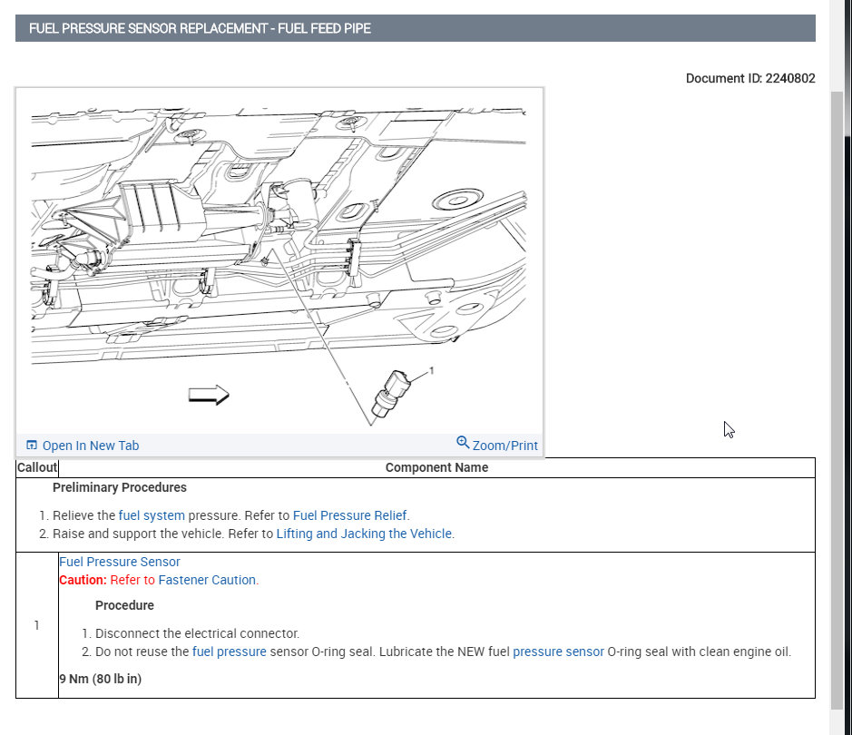

I attached the location for the feed pipe fuel sensor which is what I think you mean by the low pressure sensor.
Which engine do you have? Also, can you have the vehicle scanned for codes to find out if that confirms a fuel pressure issue?
If you can't pull codes, just stop by a parts store as most of them do it free of charge. Thanks

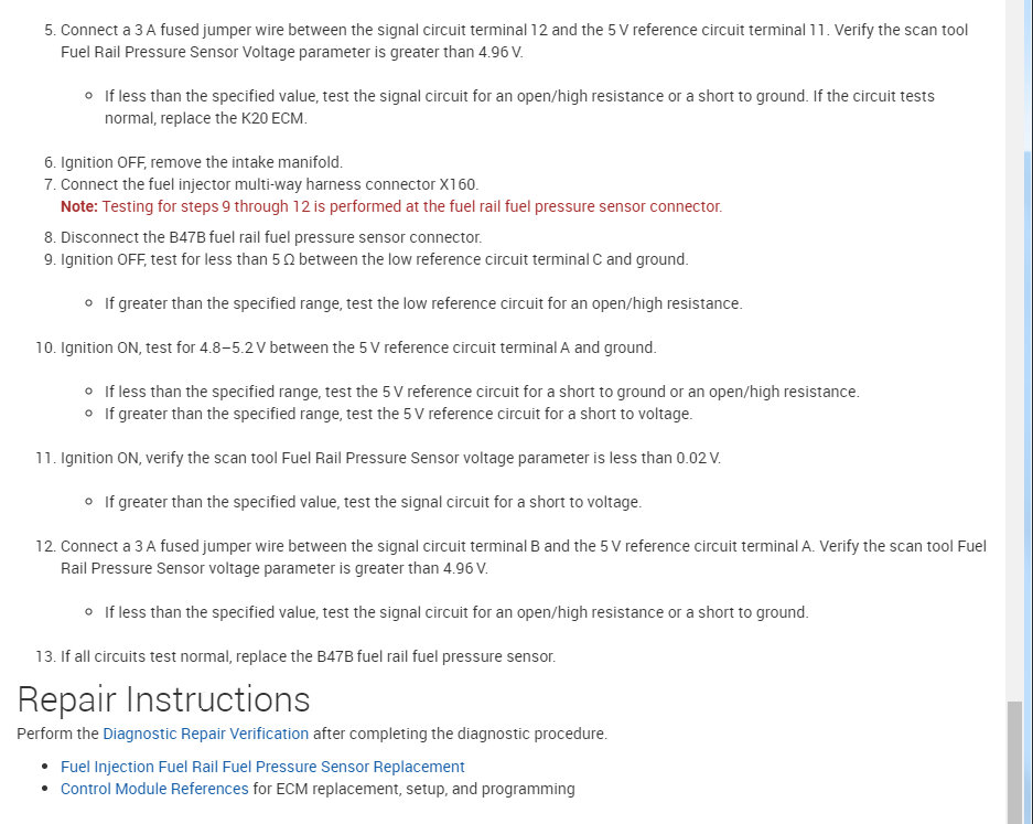

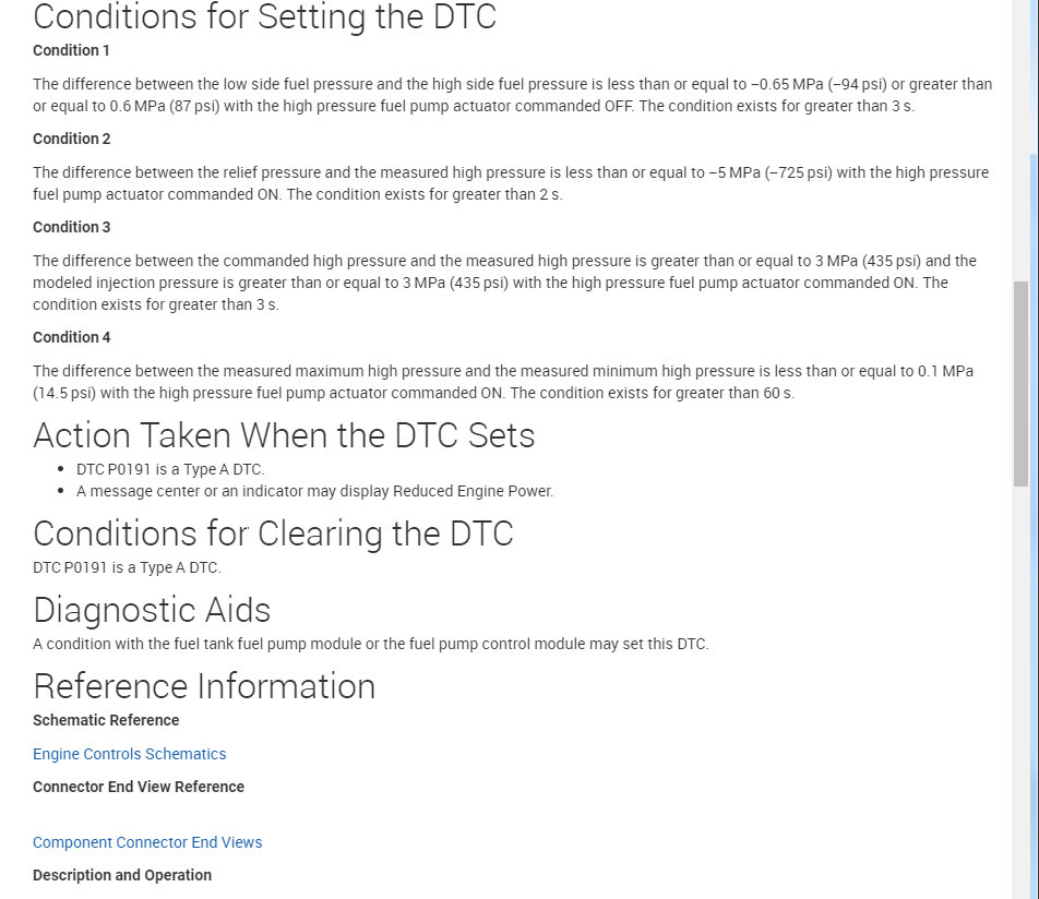

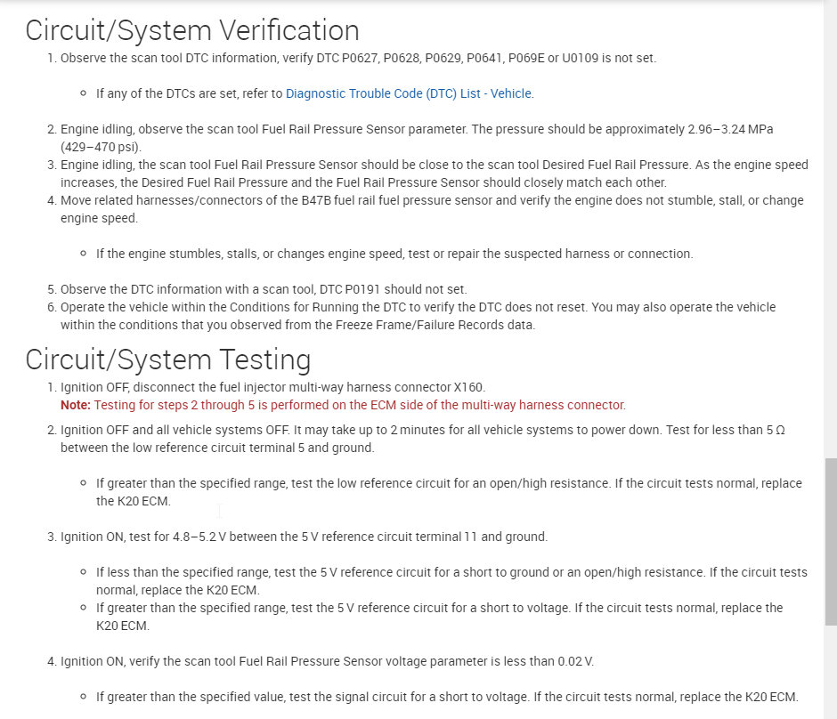

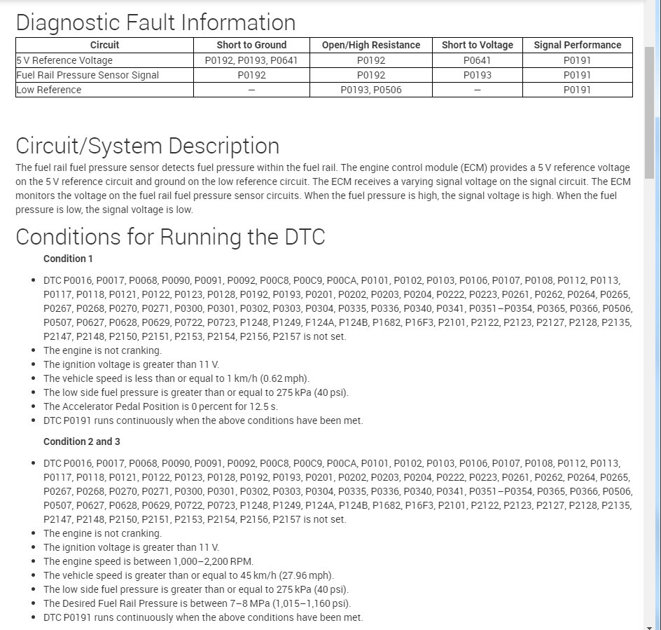

Here is the diagram for the P0191. The P0016 is related and is actually mentioned in the description.
Basically this is finding to great of difference between the fuel pressure sensors.
The testing is attached so we need to run through this and see what turns up.
Let me know if you have questions and what you find. Thanks
