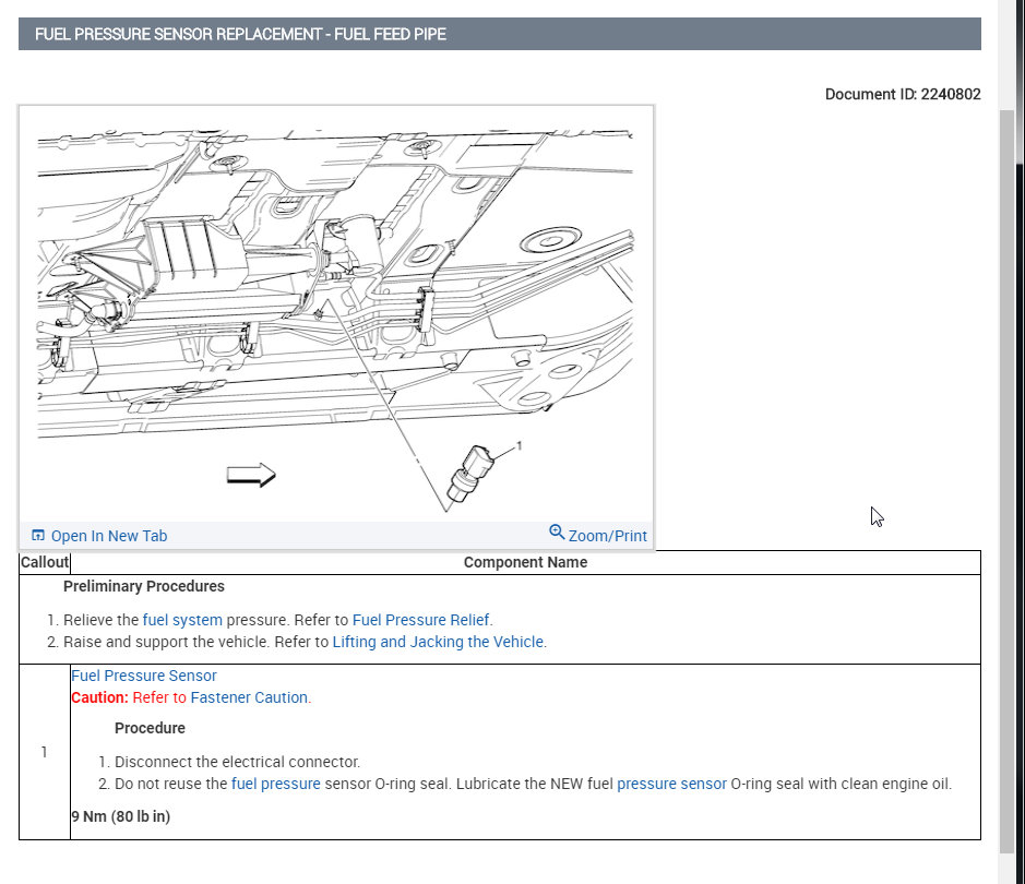

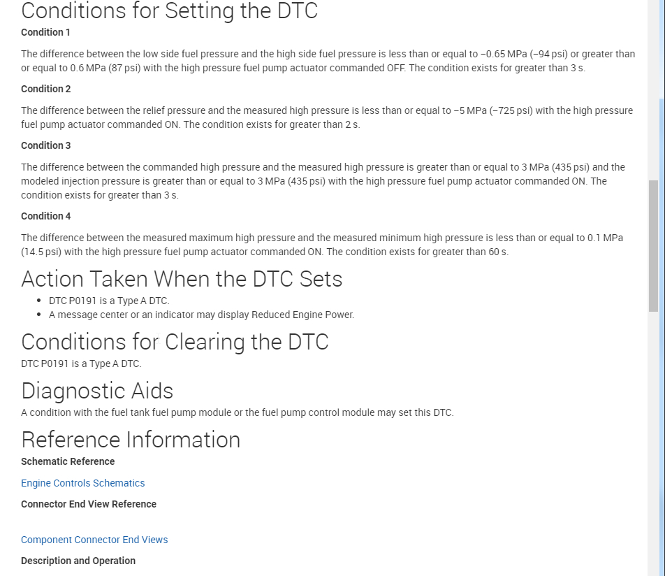

I been having trouble with my car.. It shows the check engine light when am driving it wont go faster then 40 or it will stall and at a stop it will shut off.
Mar 28, 2020 at 11:27 AM
I attached the location for the feed pipe fuel sensor which is what I think you mean by the low pressure sensor.
Which engine do you have? Also, can you have the vehicle scanned for codes to find out if that confirms a fuel pressure issue?
If you can't pull codes, just stop by a parts store as most of them do it free of charge. Thanks

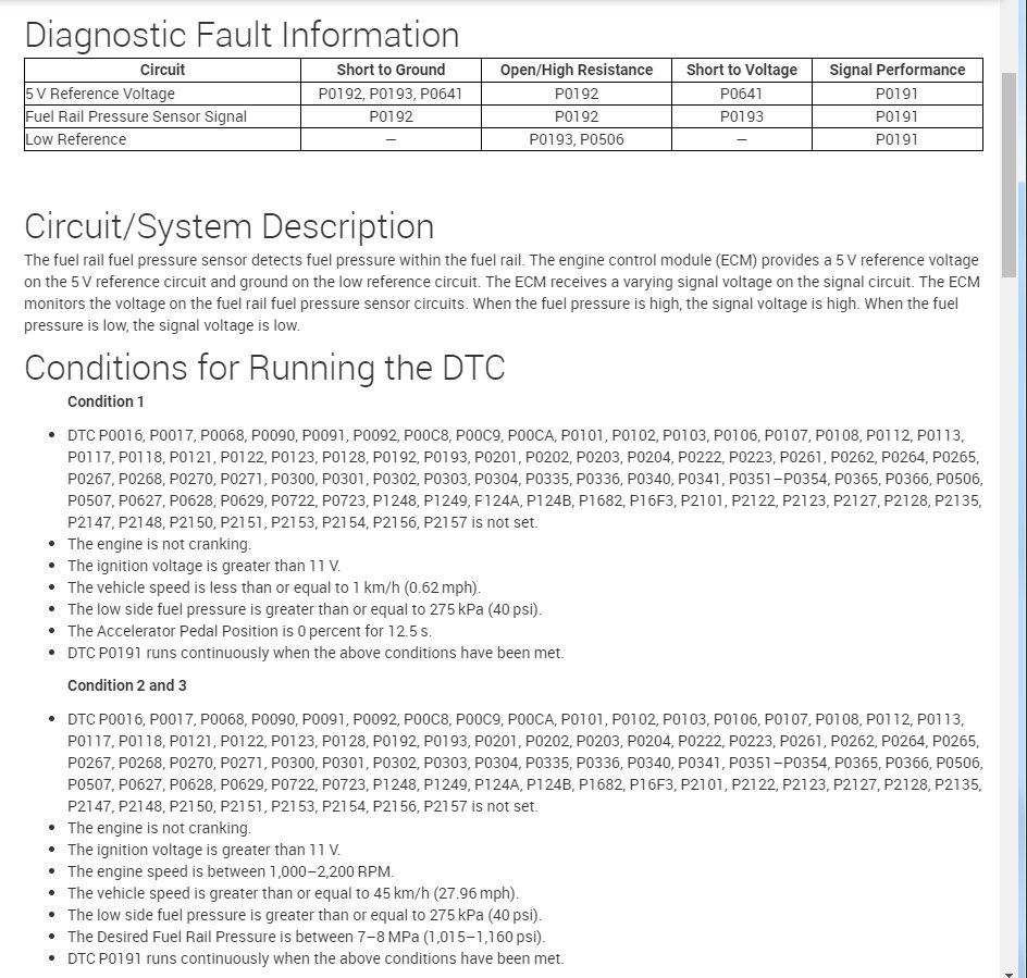

Sorry for the late response.
I have 2.4-liter, flex fuel.
The codes they gave me are P0191 and P0016.
Thank you for helping me out.
Mar 29, 2020 at 7:33 AM

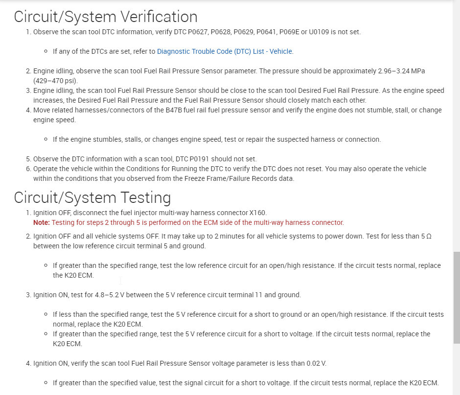

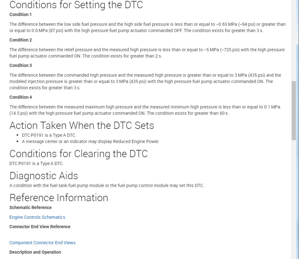

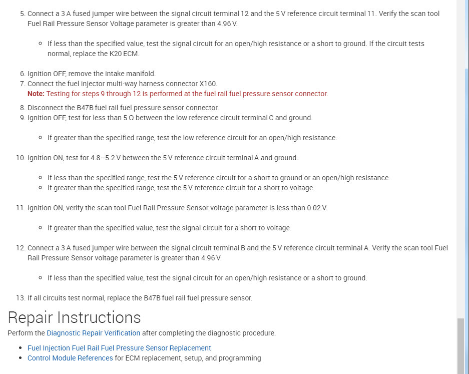

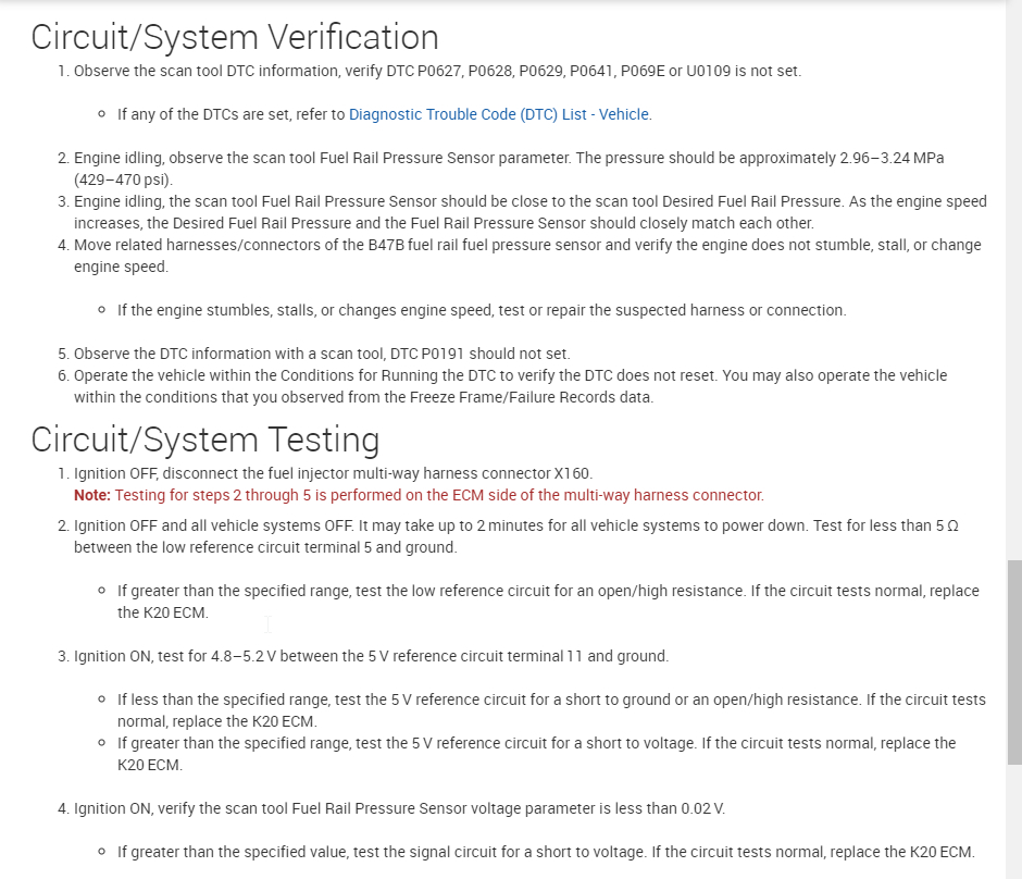

Here is the diagram for the P0191. The P0016 is related and is actually mentioned in the description.
Basically this is finding to great of difference between the fuel pressure sensors.
The testing is attached so we need to run through this and see what turns up.
Let me know if you have questions and what you find. Thanks
