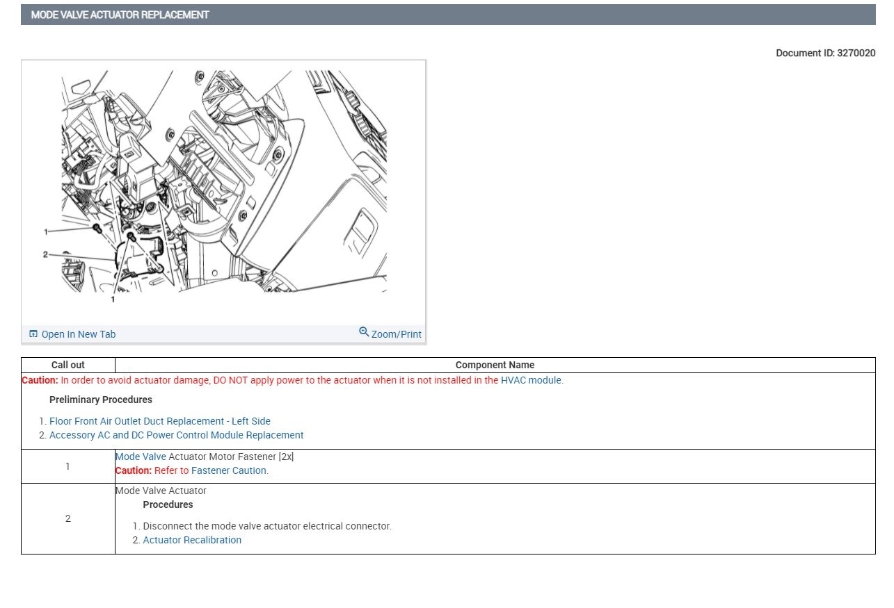

Where can I find the mode door actuator?
44,000 MILES • 5.3L • V8 • 2WD • AUTOMATIC
TJROTTLER
Floor air does not blow when selected.
Dash and defrost air blows fine when selected.
Mar 1, 2022 at 11:40 PM
Good afternoon,

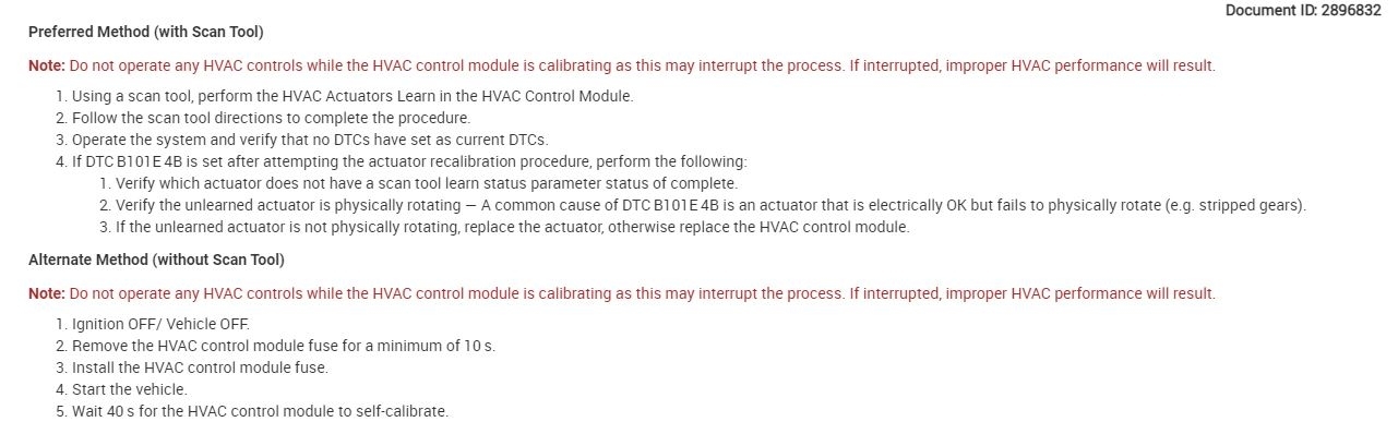

I attached the procedure for you below. It is under the dash and fairly easy to replace. Let me know if you have any other questions. Check out the diagrams (Below). Let us know what happens and please upload pictures or videos of the problem.
