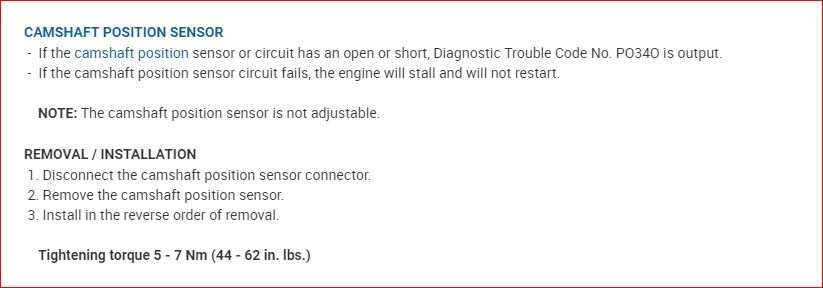

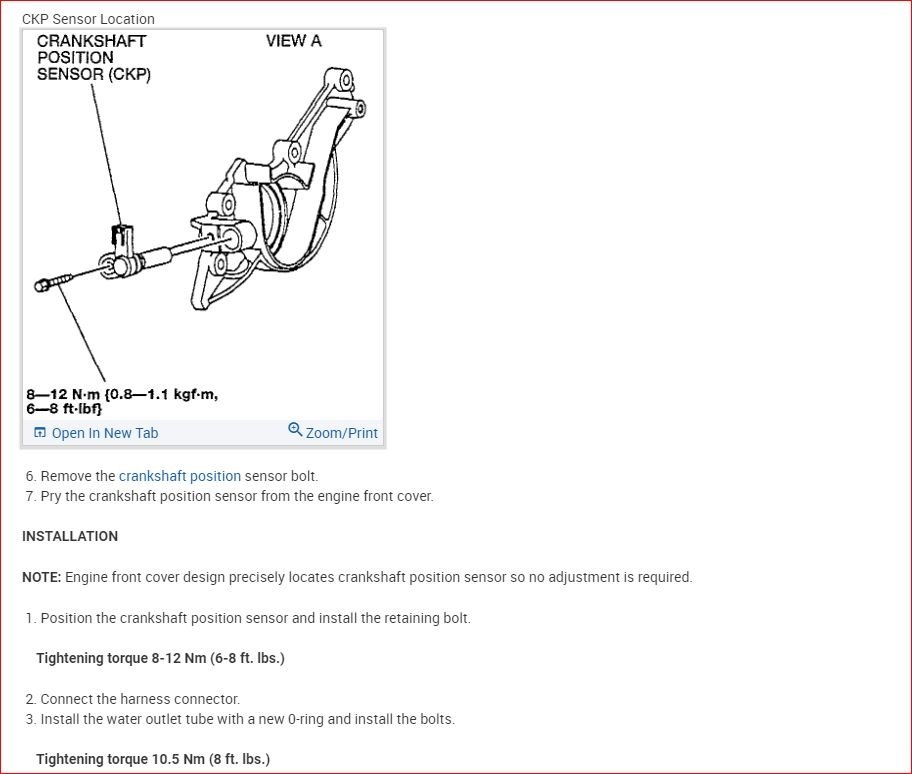

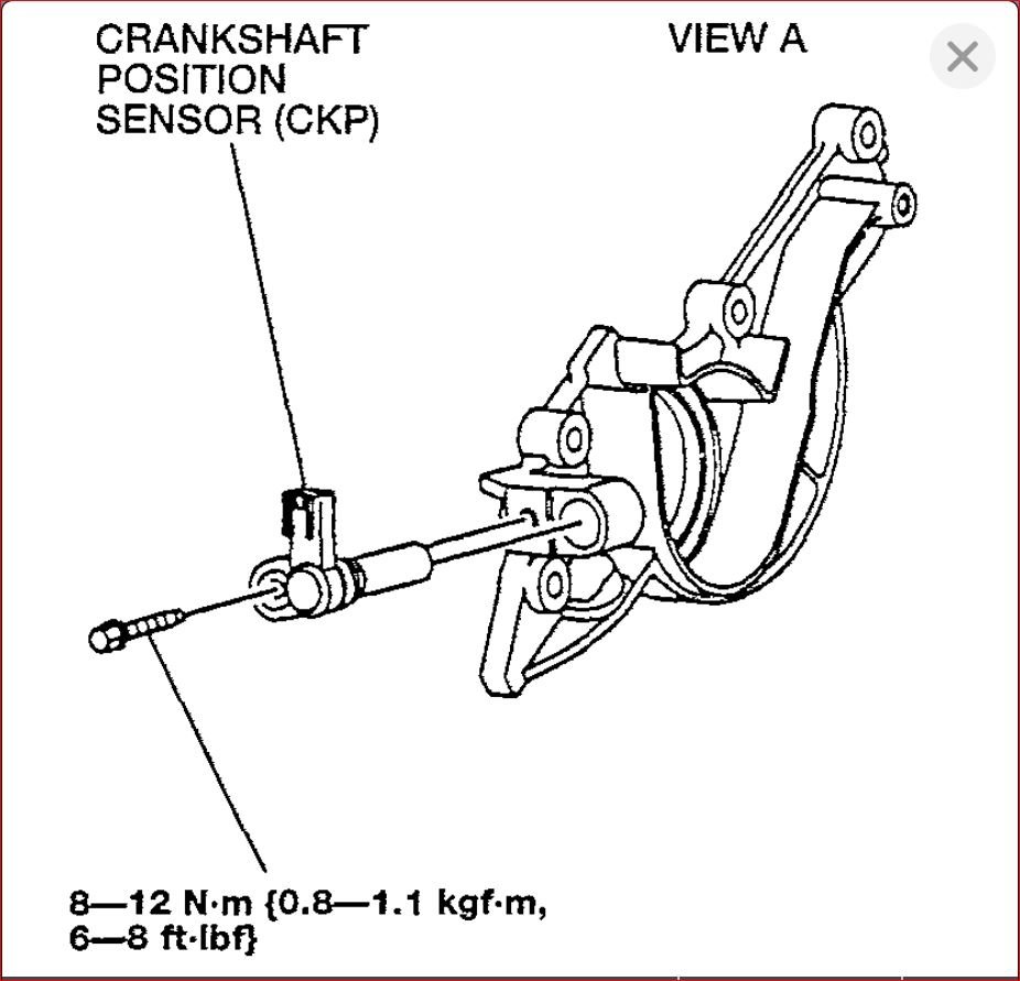

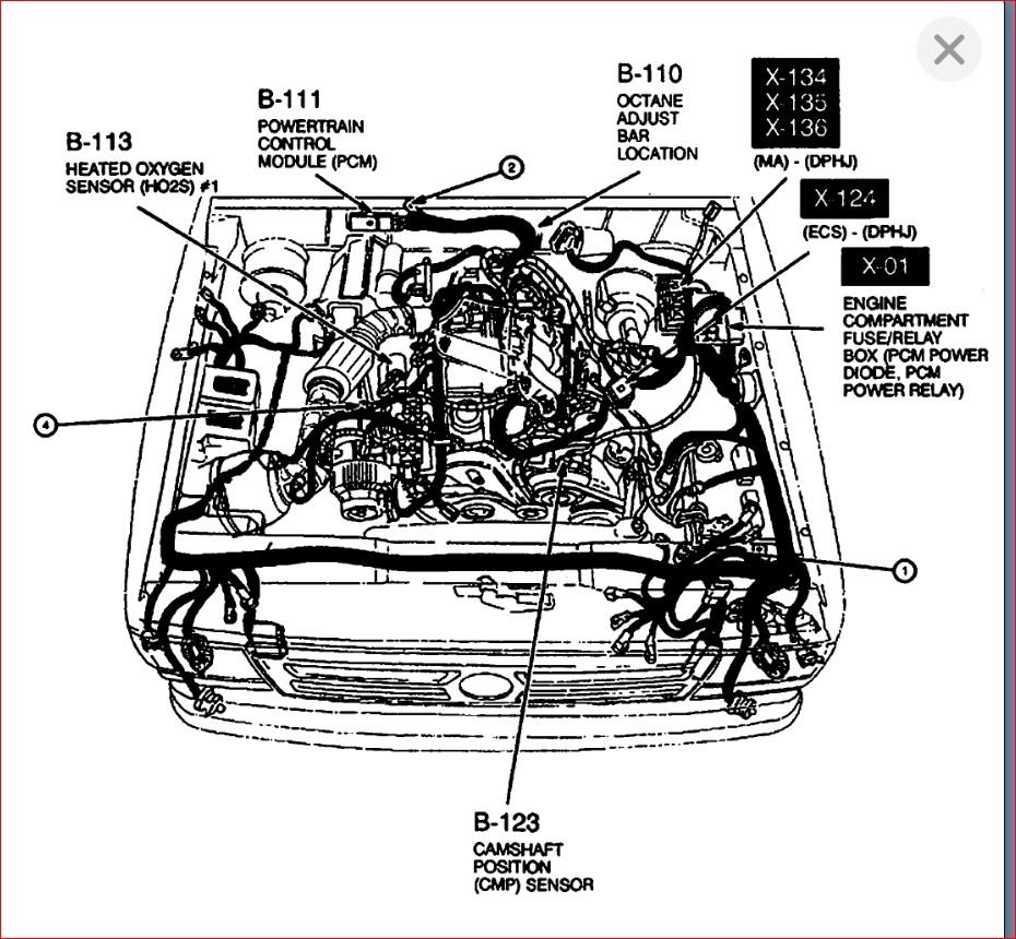

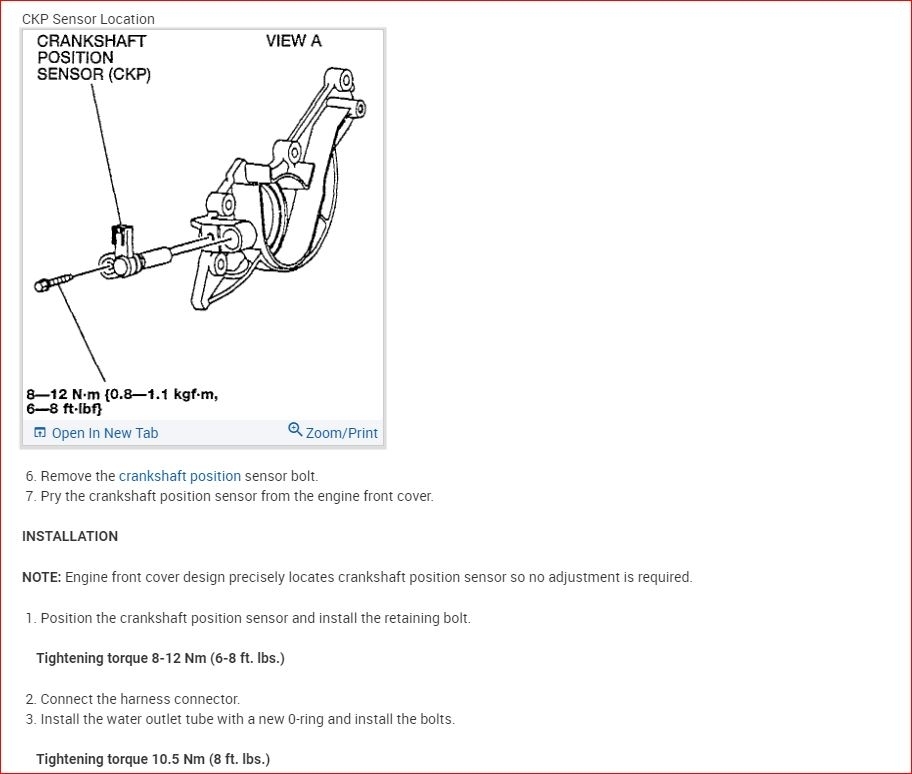

I'd like to know where crankshaft position sensor plus cam position sensors.
May 31, 2019 at 6:46 PM
Hi Jeff,
Here are both locations and the procedure for removing and installing both. Please let me know if you need something else. Check out the diagrams (Below). Please let us know if you need anything else to get the problem fixed. Thanks
Jun 1, 2019 at 5:20 AM

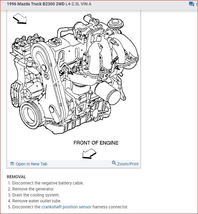

Removal & Installation (B2300)
Disconnect negative battery cable. Remove alternator. Drain cooling system and remove water outlet tube. Disconnect crankshaft position sensor wiring harness connector. Remove sensor mounting bolt and pry sensor
from front of engine. To install, reverse removal procedure. See TORQUE SPECIFICATIONS . Ensure coolant level is correct.

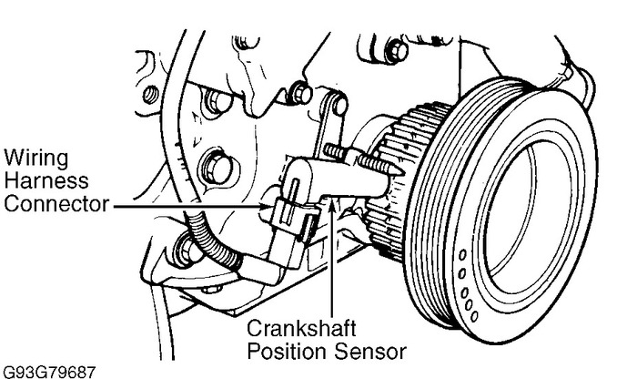

How do you remove the Compressor/Power steering/idler pullg bracket?
Dec 25, 2020 at 1:17 AM (Merged)
BLUELIGHTNIN6
  • 16,542 POSTS
need to remove PS drive belt and use pulley remover to remove pulley from pump. hold pump and rotate nut on pulley remover. remove pulley, pump from bracket then bracket.
why are you removing this for anyway? if you're replacing the crank sensor then you don't need to remove it..just remove the drive belt and crankshaft pulley. remove outer timing belter cover and rotate keyway on crankshaft to 10 o'clock position. make sure vane window of inner and outer vane cups are placed over crank sensor, remove crankshaft hub. remove sensor mounting screws and slide wires out past timing belt cover and remove sensor with wire harness retainer.
