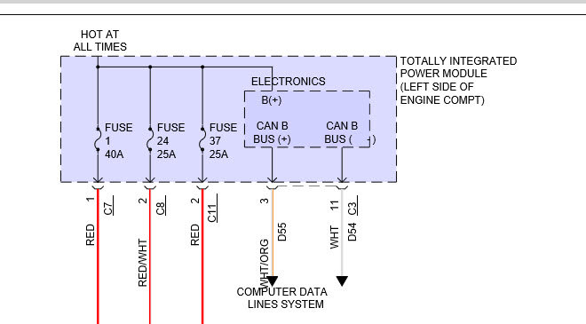

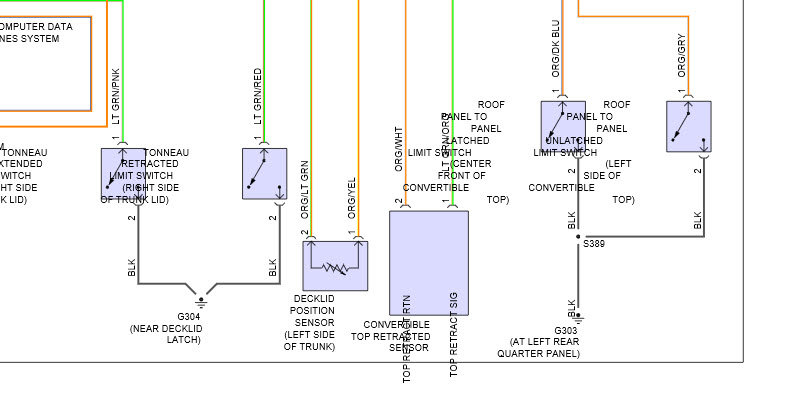

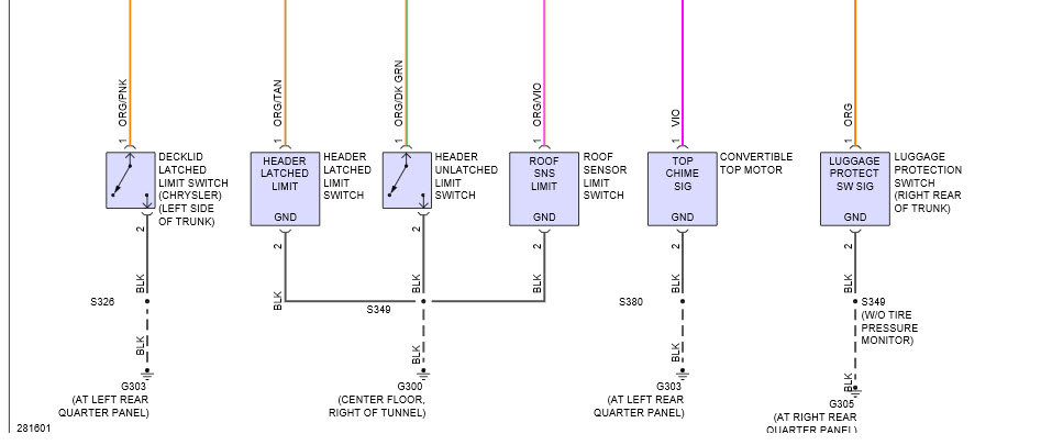

Top is stuck in the half way open position. I have a top malfunction message. How do I clear that and how do I check the micro switches?
Aug 20, 2016 at 10:41 AM
HMAC300
  • 48,601 POSTS
you are probably more than likely have to have a mechanic with a scanner scan this, as I do not think jumping the limit switches will work. but see pictures. but check fuses in tpim as well as it can be that too or a can bus problem.
