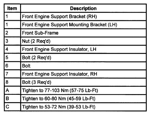

Where are the motor mounts located?
1998 FORD TAURUS
141,000 MILES • 3.0L • V6 • 2WD • AUTOMATIC
KRAZYKELLY71
Need to get locations of mounts?
Aug 22, 2023 at 7:16 AM
  • 110,244 POSTS

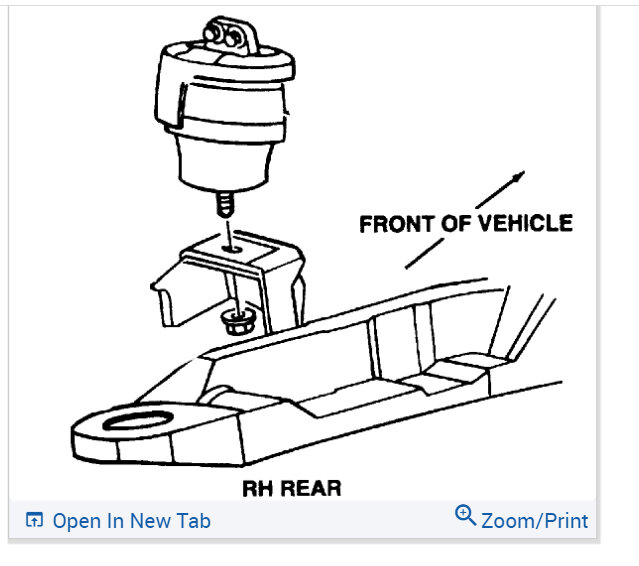

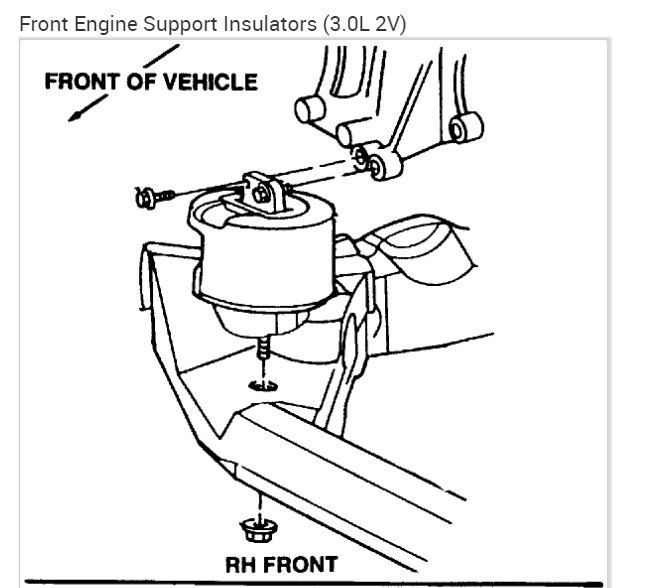

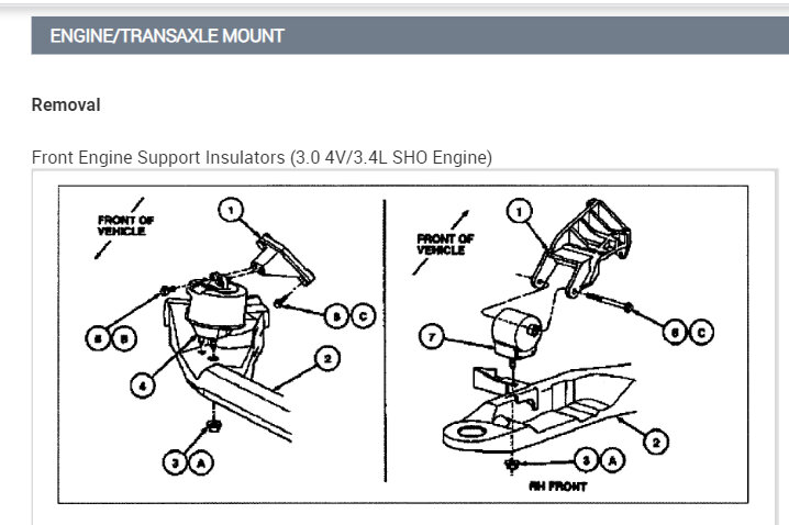

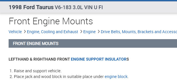

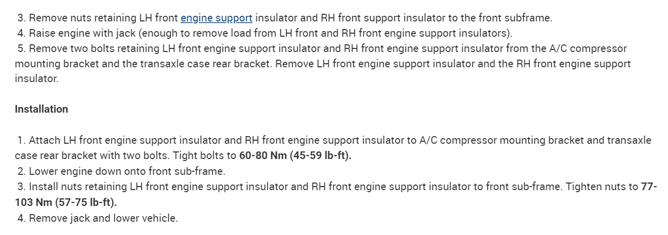

There are two at the front of the engine mounted to the subframe. When I say the front of the engine, both mounts will be on the right side (passenger side) which the front faces. Pics 1-4.

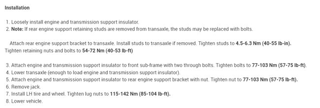

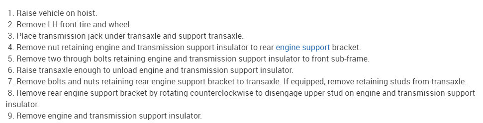

Next, there is one mount at the rear (engine/transmission mount). Pics 5-8 are the directions for replacing it.
Let me know if this helps or if you have questions.
