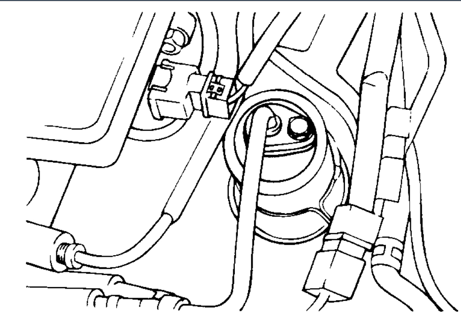

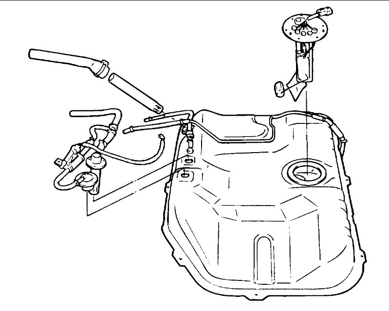

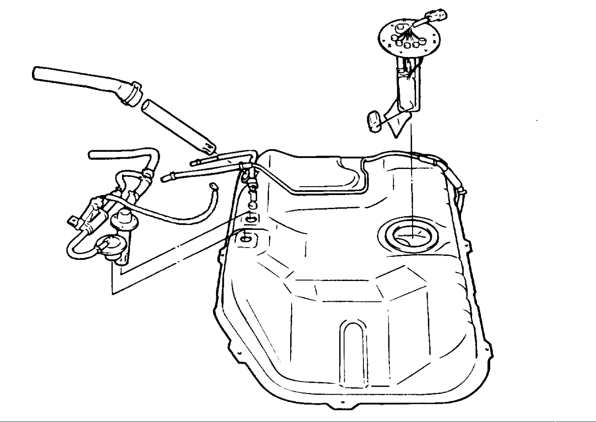

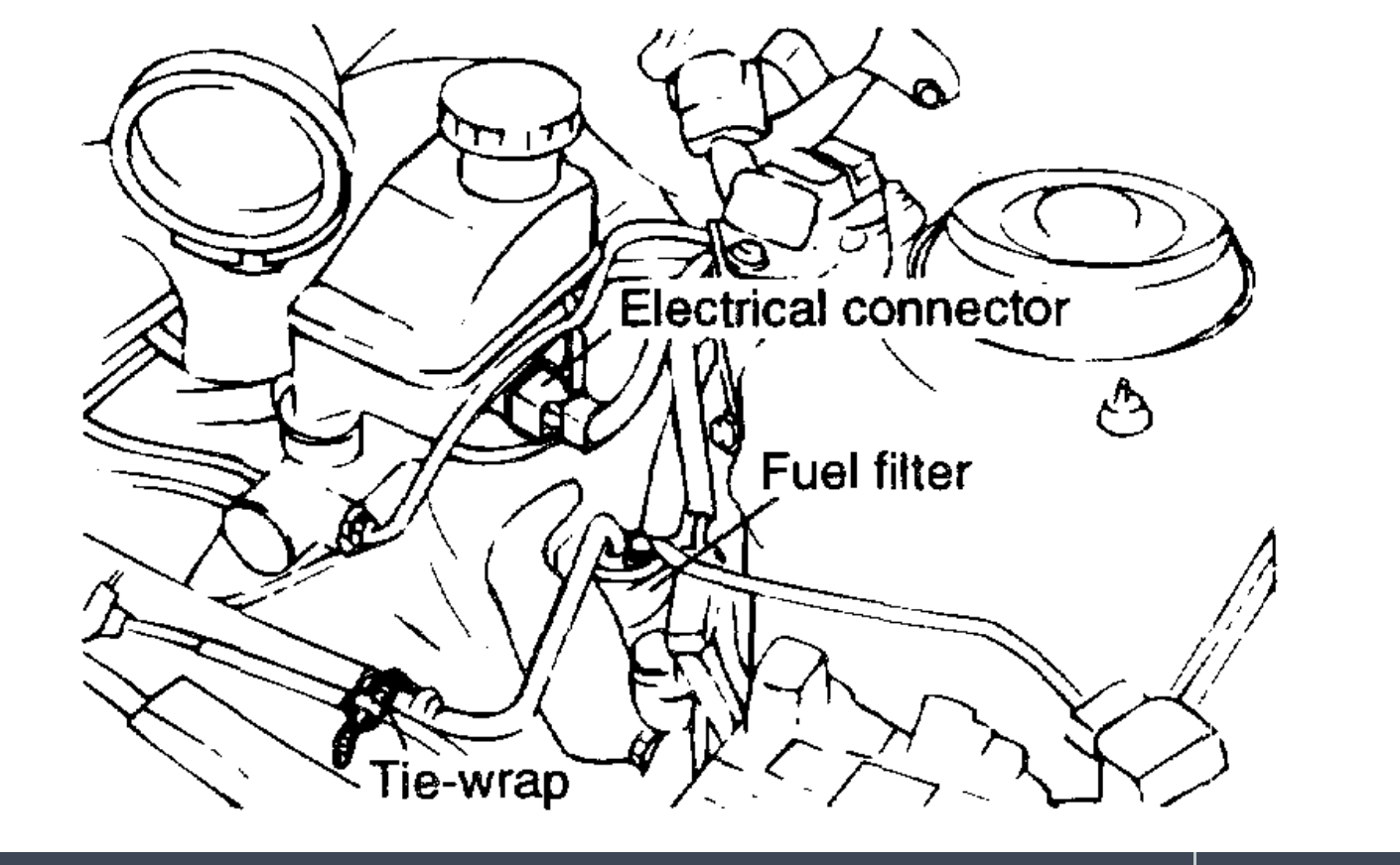

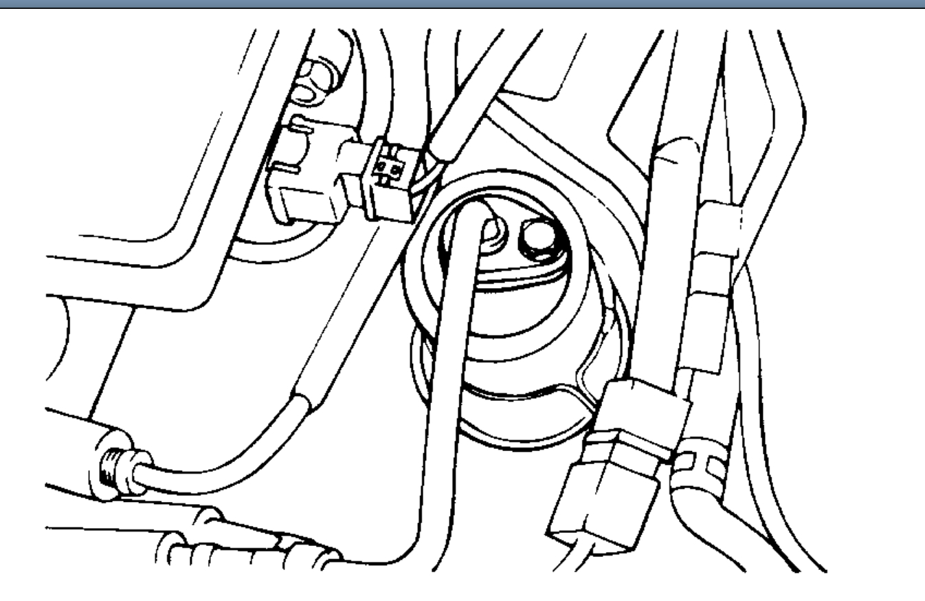

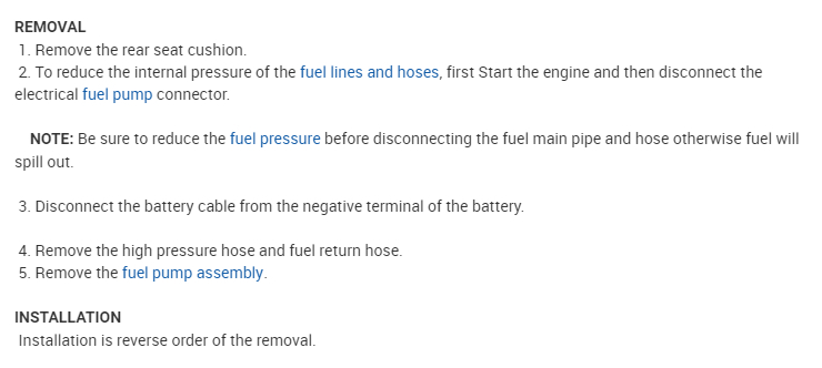

Hey guys, can someone please tell me where are both the fuel filter and pump located in my car listed above?
Jul 7, 2019 at 9:11 AM
DANNY L
  • 5,648 POSTS
Hello, I'm Danny.

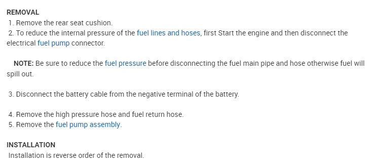

Your fuel pump and filter assembly are both mounted in the fuel tank. You can gain access by removing the rear seat cushion. Here is a tutorial showing what is involved.
https://www.2carpros.com/articles/how-to-replace-an-electric-fuel-pump
I've attached a few pictures below of its description and location.Hope this helps and thanks for using 2CarPros.

The fuel pump for your vehicle is located in the fuel tank and the fuel filter is located in the engine compartment, near the firewall, drivers side under the master cylinder. I have instructions on how to change the fuel pump and filter if you would like them and I have included some diagrams with the fuel pump and fuel filter location in the diagrams down below. Please get back to us if you require more help or just with how things turn out.

Yes, That is correct. The fuel filter is under hood as you can see by the pictures we have added. Feel free to ask any further questions if needed and thanks again for using 2CarPros.
