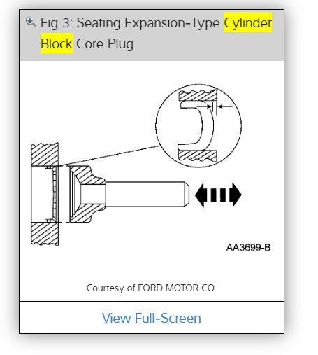

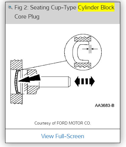

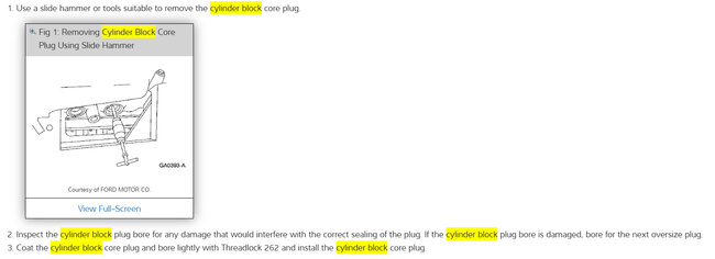

There usually is a freeze plug at the rear of the block. I don't have any images to show you, but I did find instructions on how to replace them. Also, this guide can help you pin-point the leak:
https://www.2carpros.com/articles/car-is-leaking-coolant
Check out the images (below). Please upload pictures or videos in your response to the problem so we can see what's going on to better help you.

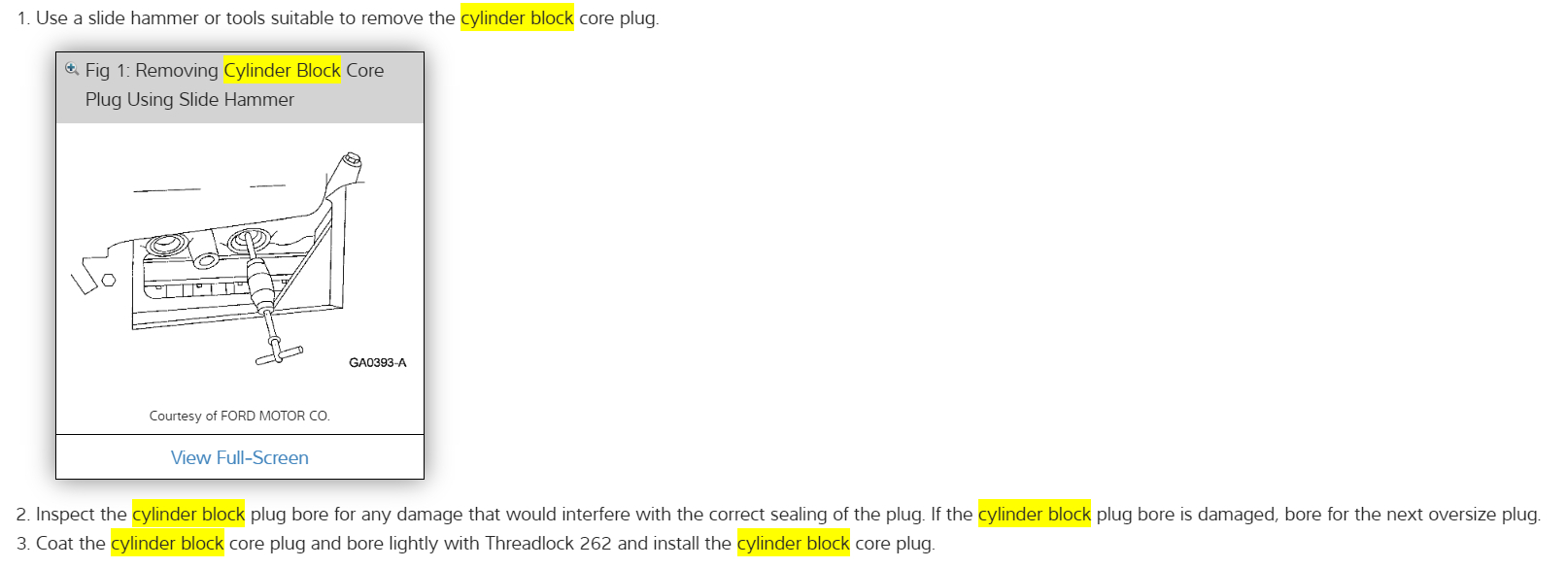

There usually is freeze plug at the rear of the block. I don't have any images to show you, but I did find instructions on how to replace them.
