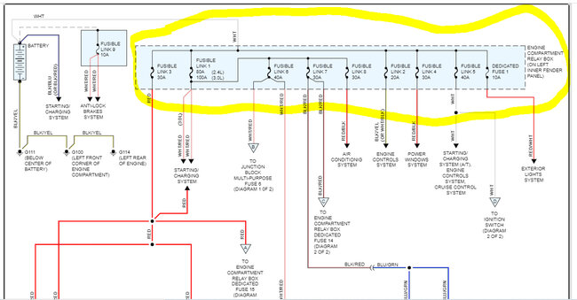

Battery installed backwards, engine cranks but does not start, where are the fuel pump relays located?
1998 MITSUBISHI MONTERO
175,000 MILES • 3.0L • V6 • 4WD • AUTOMATIC
MICHAELMARTIN
MEMBER
1 POST
Customer put battery in backwards car, starter turns but engine will not start.
Oct 29, 2022 at 12:54 PM
✓Experienced Mechanic
110,244 POSTS

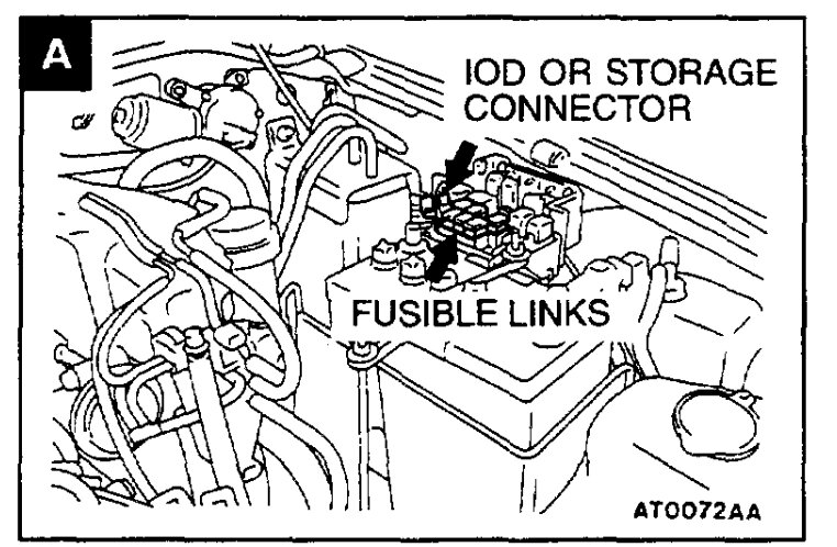

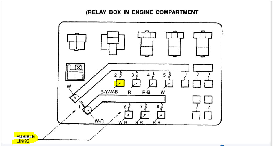

Have you checked and confirmed all of the fusible links in the under-hood relay box are good? If you haven't, that is where I would start. Fusible link number 2 is for the engine control systems, so that is the first one I would check. See pics below.
