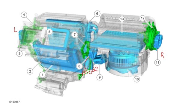

The driver's side and rear vents are blowing hot air while the passenger side is blowing cold and I believe I need to change them all but am having trouble locating the ones on the driver's side.
Jul 31, 2025 at 10:15 AM
STEVE W.
  • 15,349 POSTS

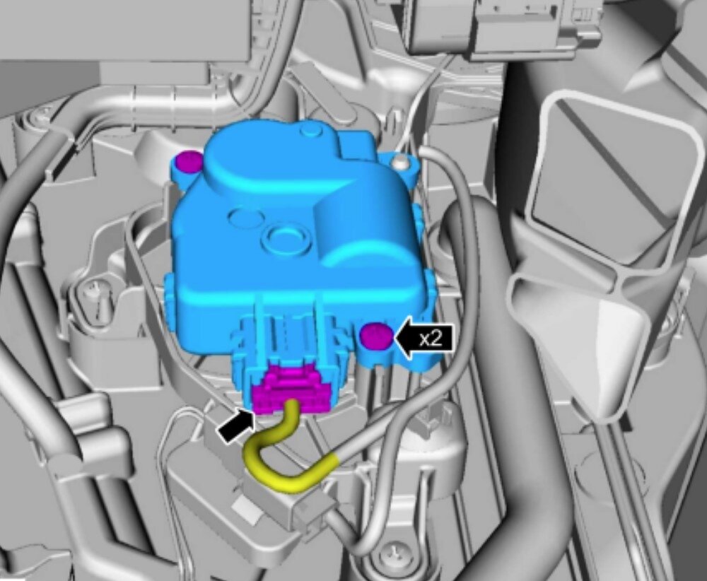

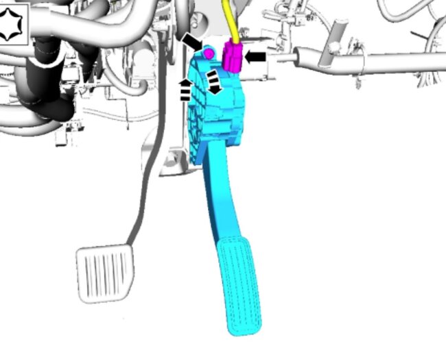

If the right side is working but the left side, isn't you should be able to change only the left side. There are only the three actuators as in the last image. For the left side you remove the throttle pedal and look to the right of it on the HVAC case and the actuator is there. Remove the screws and the electrical connector and reverse the process to install the new one.

How do I get to the mode?

I changed the left one out but the driver side and the back vent are still blowing hot air.

Ok, I was able to find the mode and changed it out and it fixed the issue. Thanks!!!!
Aug 2, 2025 at 7:13 AM
STEVE W.
  • 15,349 POSTS
That's strange. The mode actuator would be the one in the middle (8) and it just selects where the air goes, not the temperature of it, or is that what you meant originally, that you couldn't select where the air went and not that you couldn't change the temperature? Either way, glad to hear you found the issue.

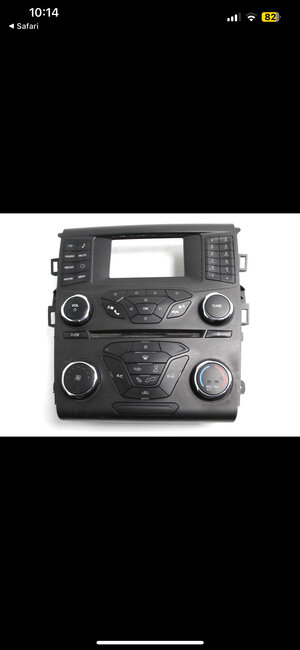

I haven’t tried the gauges yet but I did get it back to blowing cold air. My climate control button has been acting weird too and isn’t responding properly. I’m starting to think there’s an electrical issue. The air speed button is fine but the climate control button acts very wonky.
Sep 2, 2025 at 4:08 AM
STEVE W.
  • 15,349 POSTS
That is possible, there are a lot of electronics behind those buttons. Might be worth it to get one from a salvage yard and see if things change. If it was blowing cold it may not be the refrigerant system but the controls. Do you have the automatic system (Set it to 70 and it does the rest) or the manual controls? They use a few different parts.

For that one you still need a scan tool to pull the FICM build info out of the current one and then put that into the replacement. Why they want everything to be a computer is just annoying, Especially for heater controls... Also look up all the options your vehicle has, Ford made different FICM assemblies for each option! At least with the manual controls it drops to three possible units.

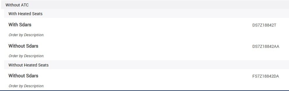

It’s been kinda difficult finding the radio part for my year (2016), would going up one year be possible if it’s the same part ?
Sep 20, 2025 at 12:39 PM
STEVE W.
  • 15,349 POSTS
Have you looked on ebay? It looks like there were 3 units available with the manual temp controls. One with heated seats and satellite - DS7Z18842T One with heated seats but no satellite - DS7Z18842AA And the base version with no sat or heated seats - FS7Z18842DA
Search using those and there are a bunch that show up.
