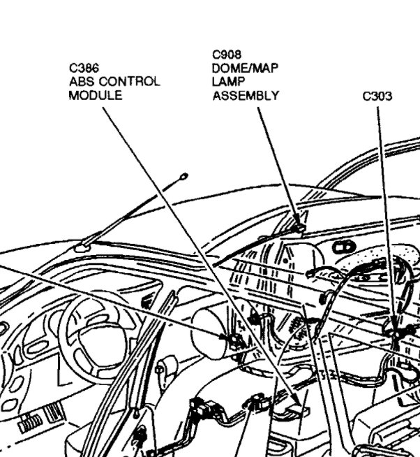

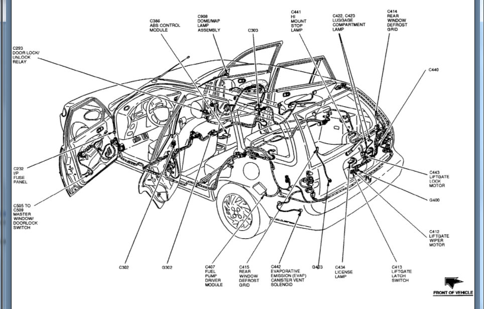

Can I get a electrical diagram for the ABS circuit and where is the ABS control module located?

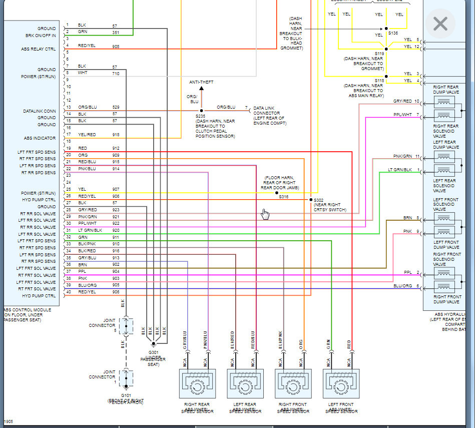

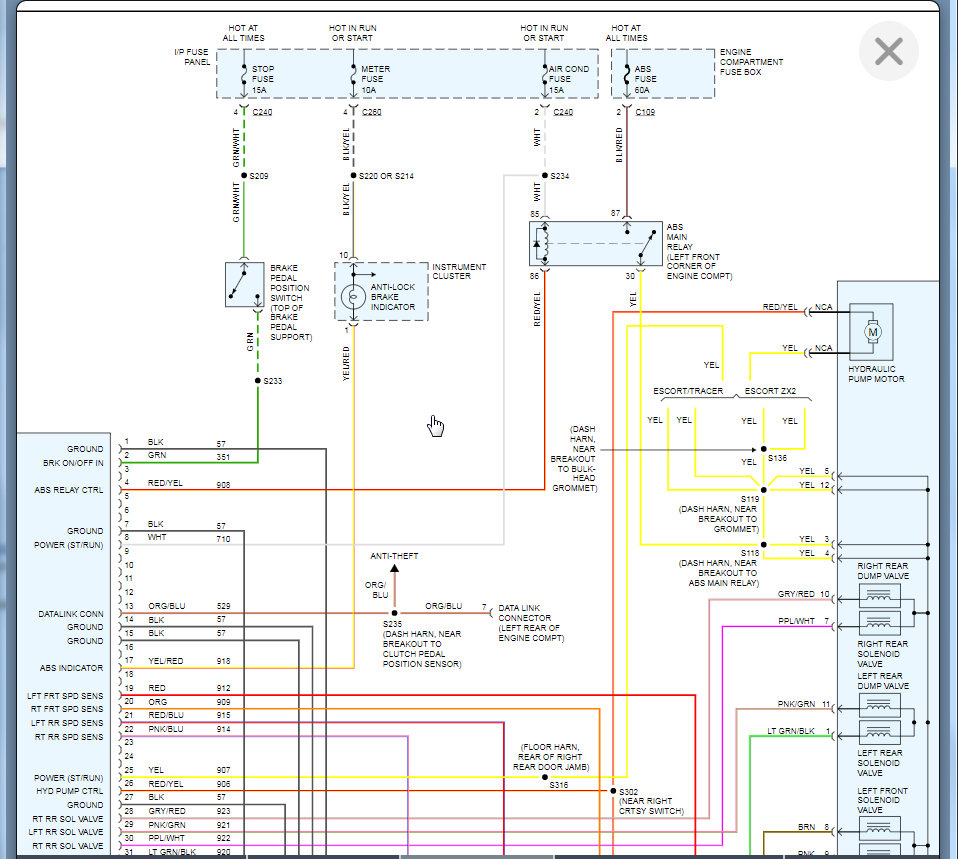

I went and examine the ABS hydraulic modular, remove the connector going to the motor, tested it for voltage found none! Here i am just curious as i am thinking that when i press on the brake peddle i should be getting some type of sound, if the ABS system is being engage.
Question can i get some help? And can i get the electrical diagram for the ABS circuit? And where is the ABS control module located on these cars?

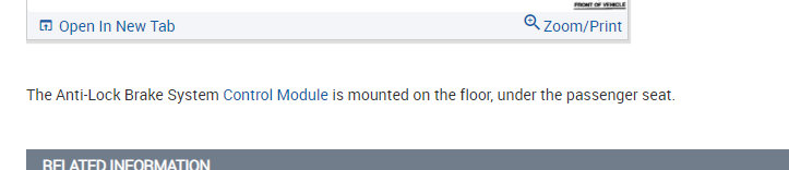

Sounds like you found a possible issue there so we need to investigate this further.
Let's check for power at the module then make sure the fuses are intact.
Below is the info on where the module is and the wiring diagrams that will give you the wiring info that you need.
Please run through this info and let us know what you find. Thanks
