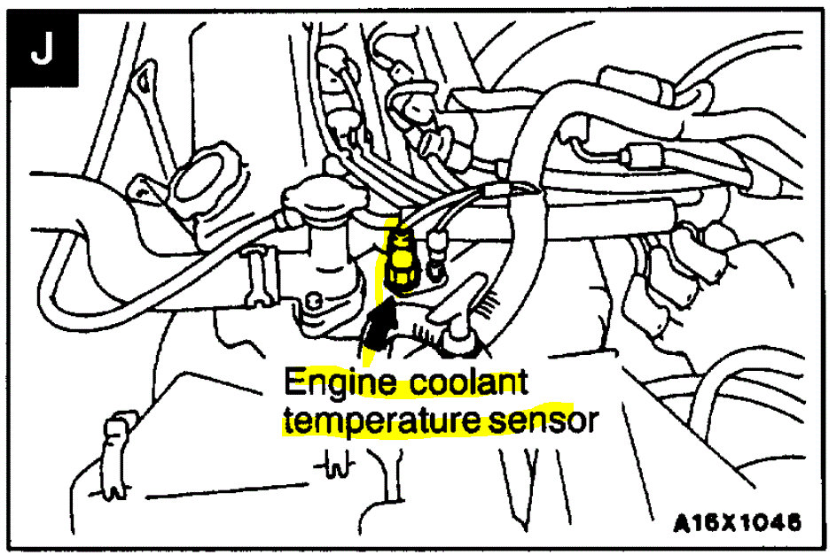

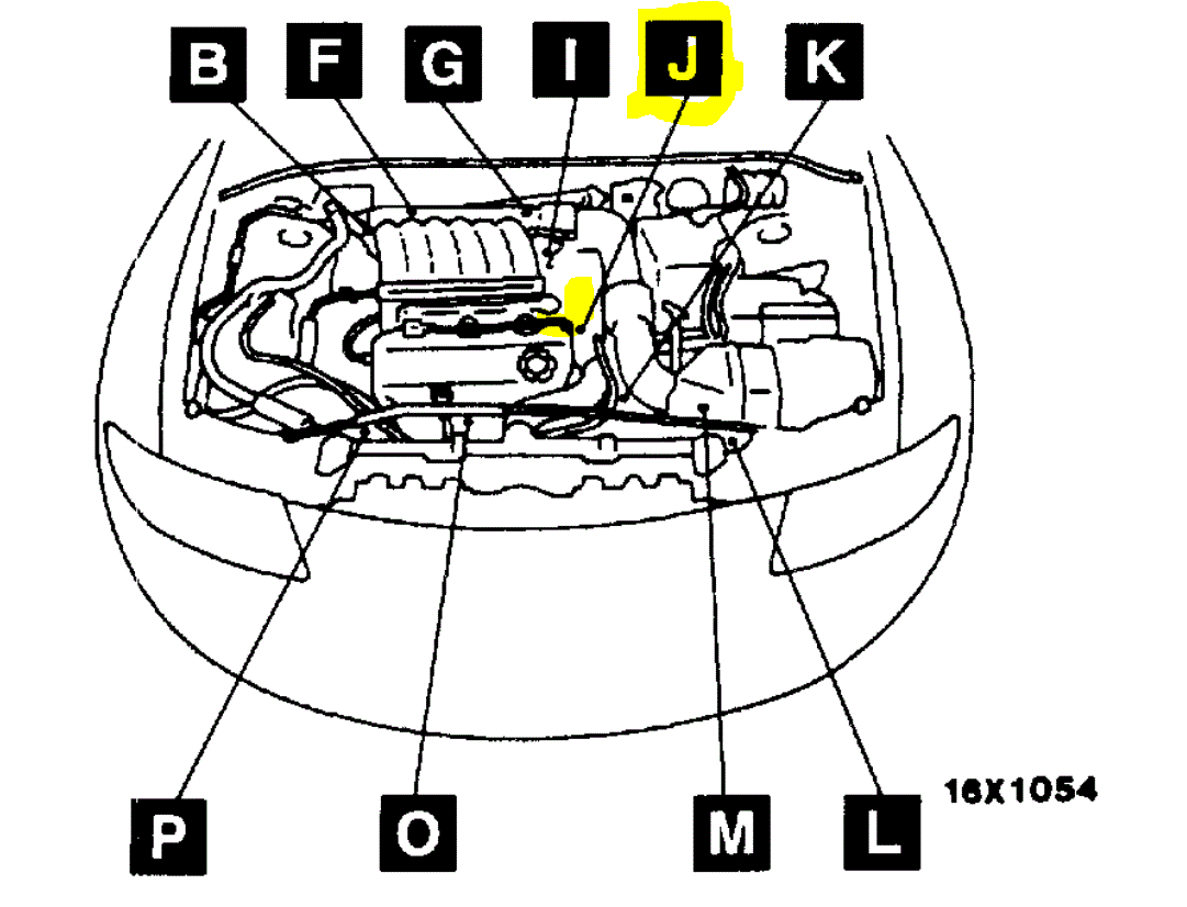

where a sensor is engine coolant temperature sensor?
1998 CHRYSLER SEBRING
76,000 MILES • 2.5L • 6 CYL • 2WD
MICK LANDRY
i need to know where the engine coolant temperature sensor is located..
Mar 25, 2022 at 10:45 AM
  • 110,240 POSTS
The ECT is located behind the thermostat housing. If you take a look at pic 1 below, it gives an approximate location. Pic 2 shows the sensor.
If you are replacing it, here is a link that explains in general how it is done:
https://www.2carpros.com/articles/coolant-temperature-sensor-cts-replacement
When you install the new one, you need to use a sealer on the threaded portion of the sensor. Here is the part number for the OEM sealer used but you can use something other than is comparable.
MOPAR Part No. 4318031
