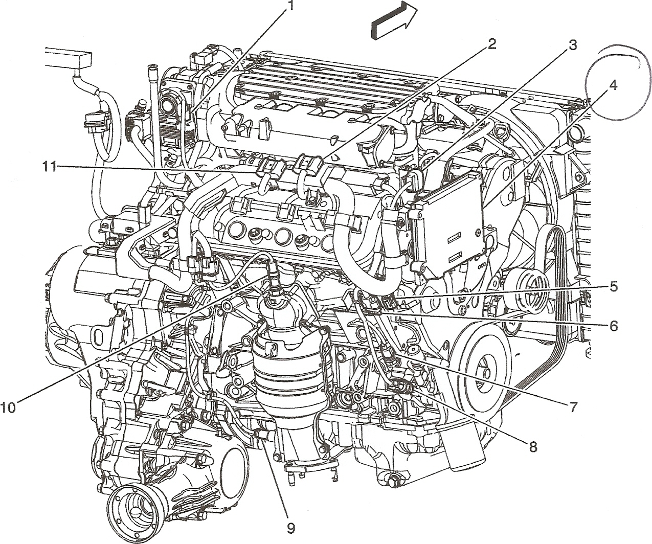

I have an 2006 Saturn Vue with the Honda 3.5 v6 it has just under 75,000 on it. I need to replace the ECM module can anybody tell me where the ECM module is located on this engine?and is it easy to remove? I am getting a used one from a 16,000 mile truck that was rolled, will this module once installed have to be reprogrammed by the dealer? Or can a mechanic do it? Any help would be appreciated! Thank you.

Hello. The location of your power-train control module is in the engine compartment, mounted near the right strut tower, beneath the air duct. It will have 2 connectors. After you replace the module, the replacement module will have to be programmed so the information in the new PCM will match your vehicle. (Be sure to disconnect the negative battery cable from the battery before disconnecting and removing your PCM. Reconnect the cable after the new PCM is installed.) The PCM is number 4 in the picture.

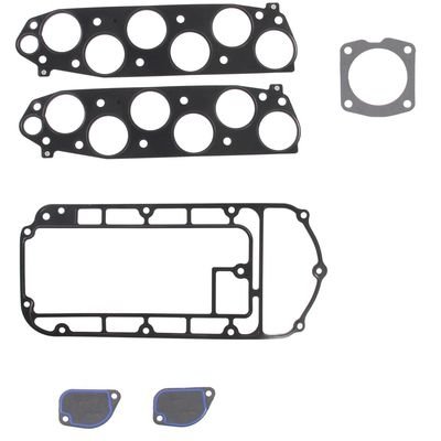

Denny, do both manifold gaskets have to be replaced? i just checked some listings for this part it shows a set of 2, each one has 3 pear shaped holes in it. Is that the right gasket set? Or is there only one? Can you possibly send me a picture or specs of this gasket? I was on the rock auto site they have a few listings for this and are all the same. It's a 2 piece set with the 3 pear shaped holes in each! Any more help is much appreciated! Thanks Nick

I can't find any good pictures that show the gaskets on the vehicle. However, I did locate the Fel-Pro gasket kit part number. ( MS96409-1) This is the kit with all of the intake manifold,spacer, and plenum gaskets.
