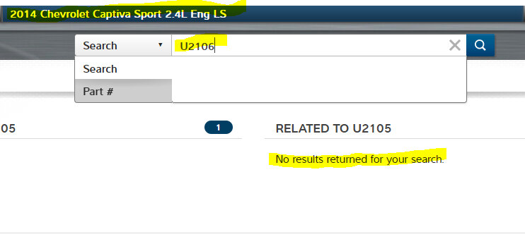

When shifting to Reverse, Service Traction Control and Service Stabil track lights come on?
130,000 MILES • 4 CYL • 2WD • AUTOMATIC
AREIANN
When I shift in to Reverse the transmission has a hard shift and kind of lurches a little then I get a few lights that pop up on the dash and a message that says Service Traction Control. The doors are usually locking and unlocking while the transmission shifts and then when it all stops a "Service Stabil track" message comes on. I used a Zurich scantool and the Chevrolet ABS has code U2106-00 "Lost Communication with Transmission Control Module"
What could be causing this? I seem to recall a similar issue happening about 5 years ago. I don't remember exactly what was replaced because of language barrier between myself and the mechanic (my father in law's friend) so he mostly handled it.
Not sure if it matters but... I recently had to get a new Catalytic converter because the other one "went bad". The dealer gave me no explanation as to why it went bad and also didn't look into what could have caused it. I've also had both camshaft position sensors replaced within the last 5 years as well.

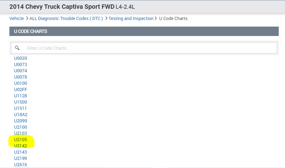

This is an interesting one. Is the only code present the U code you provided? Also, in addition to the traction control indicator, what are the other lights that turn on?
Since the code you have is related to the transmission control module, have you checked the connectors at the computers and transmission?
Here is the issue I'm having on my end. I tried to look up information based on the code you provided and according to two manuals, it isn't related to this module year. See pics below.
If you look on the driver's side door or door frame, you should see a couple of labels. See if you can find one with the production date. We have a very early or late production date that pushes diagnostics into a different year.

Hello! I didn’t see any stickers with a production date. I took the car to the shop because the problem now happens in drive as well as reverse. Will update when we find out what’s wrong.
