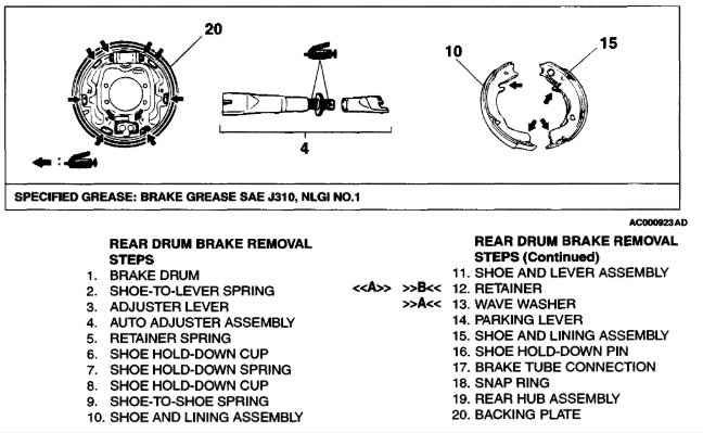

I'm replacing my brakes and want to replace front and rear hardware as well. I'm getting confused because there is the rear drum complete kit, then there are also caliper bolts/guide pins, pin boots, disc brake hardware, etc. When you're getting all this replaced at a shop, what all are they including? And what all should I have replaced, since I've been told the front and rear brake hardware is causing uneven wear?

Normally, When you go to a shop the shop advertised service just includes resurface or replace front rotors and rear discs or drums.Install front pads and rear brake shoes with labor cost.Only if the technician notices any other defects or concerns then report to customer for additional cost.Yes, defective hardware can cause multi brake problems and conditions.Also, When you see those advertised brake specials on television or roadside banners it is for the bare minimum of service.Hope this answers your question and thanks for using 2CarPros.

Hello again.
You were correct for the front. But for the rear you can get a wheel cylinder (if leaking) and drum hardware but no pin guides or boots. I've attached a picture below of the rear drum hardware for your eclipse. Hope this helps and thanks again for using 2CarPros.

KIWASABI1
  • 202 POSTS
Perfect. I replaced the wheel cylinders and did a bleed a year ago. So I'll be skipping those this time around. So I will be getting:
Front:
Disc brake hardware
Caliper bolt / pin guides
Pin boots
Rear:
Drum hardware
Thanks as always for your help, that's all I needed.

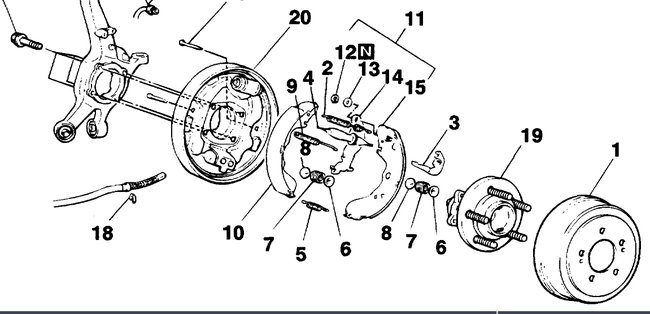

DANNY L
  • 5,648 POSTS
You're welcome!
I've attached pictures below again for reference if needed.Most people mess up by taking apart and forget how to put back together..Take a picture before tearing apart or you can use this as a reference.Hope this helps and please use us again in the future.Thanks again for using 2CarPros.

KIWASABI1
  • 202 POSTS
Thanks for that info. I should have asked about quantity originally. In regards to disc brake hardware kit, I'm referring to what's in this picture. I seem to have my answer though, the kit has hardware for 2 calipers.

DANNY L
  • 5,648 POSTS
Hello again.
Yes, the picture I provided for the rear drum hardware is a pair and will work for both sides.You can also buy a hardware kit for an individual side depending on budget or circumstances. The same can apply for your front disc caliper boots and slides.If you plan on doing both front and rear its best to buy as a set.Hope this helps and thanks again for using 2CarPros.
