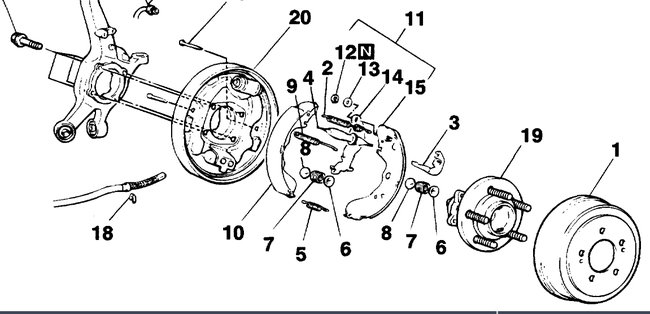

You were correct for the front. But for the rear you can get a wheel cylinder (if leaking) and drum hardware but no pin guides or boots. I've attached a picture below of the rear drum hardware for your eclipse. Hope this helps and thanks again for using 2CarPros.

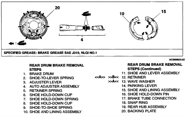

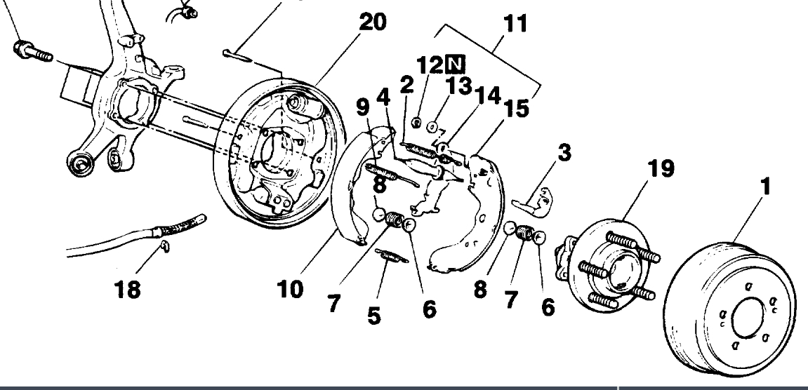

I've attached pictures below again for reference if needed.Most people mess up by taking apart and forget how to put back together..Take a picture before tearing apart or you can use this as a reference.Hope this helps and please use us again in the future.Thanks again for using 2CarPros.

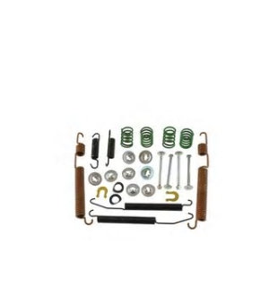

For the front you will need 4 boots and 4 pins.For the rear you will need 2 drum brake hardware kits.Hope this helps and thanks again for using 2CarPros.

Thanks for that info. I should have asked about quantity originally. In regards to disc brake hardware kit, I'm referring to what's in this picture. I seem to have my answer though, the kit has hardware for 2 calipers.

Yes, the picture I provided for the rear drum hardware is a pair and will work for both sides.You can also buy a hardware kit for an individual side depending on budget or circumstances. The same can apply for your front disc caliper boots and slides.If you plan on doing both front and rear its best to buy as a set.Hope this helps and thanks again for using 2CarPros.
