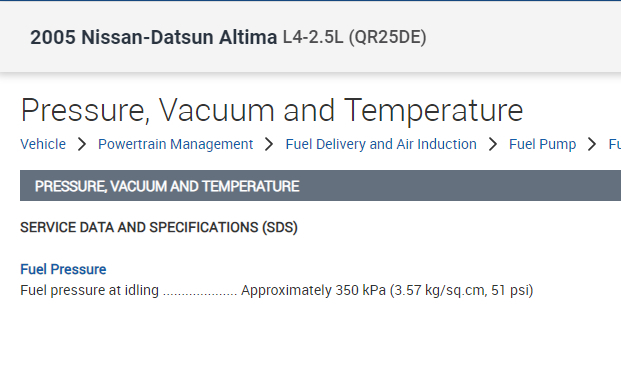

Based on that, I would recommend testing the fuel pressure to confirm it is within the manufacturer's specifications. We may simply have a weak pump.
Here is a link that explains how it's done. You will need a fuel pressure tester, but most parts stores will lend one to you.
I attached the manufacturer's pressure specifications below. Try this and let me know what you find. Additionally, when the key is turned to the off position, see if the pressure drops quickly.
See pic below.
Jun 21, 2024 at 1:08 PM

If that is the case, then the engine isn't getting fuel when it happens. I need you to check fuel pressure when this happens. If it is low, the pump is the likely problem. If it is normal, then we need to see why the injectors are not providing fuel to the engine.
I attached the directions above for checking pressure. Let me know if you have questions or if I can help in any way.
