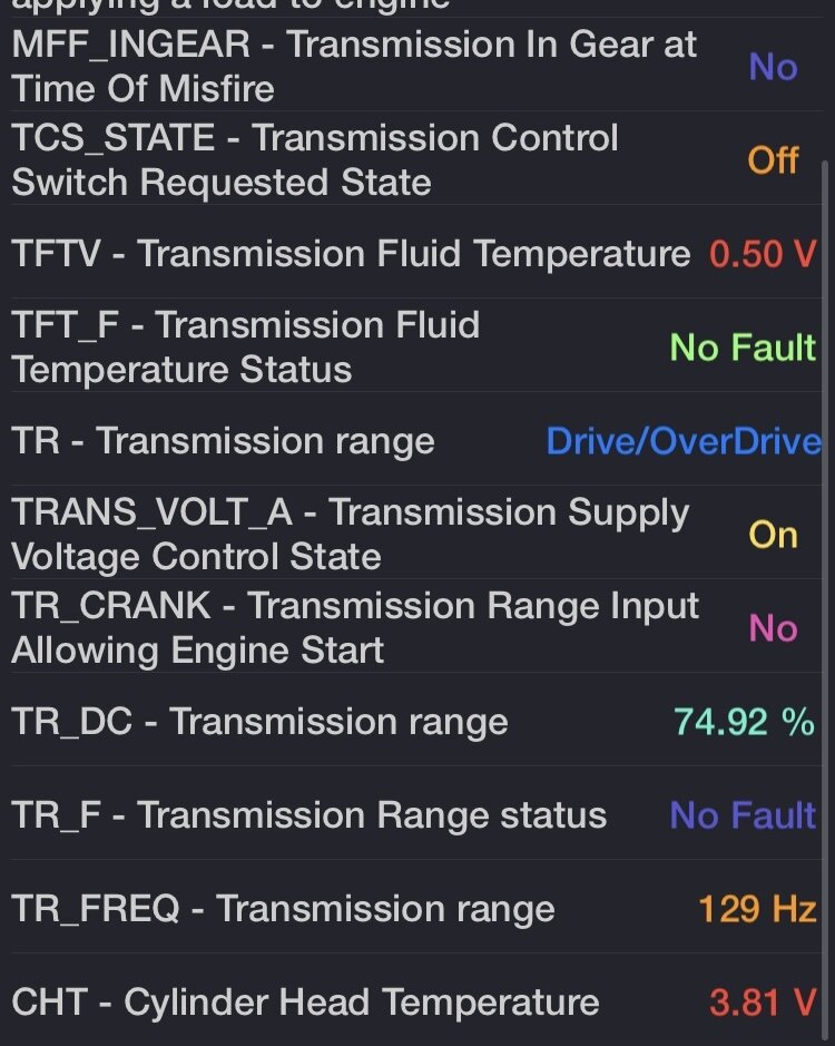

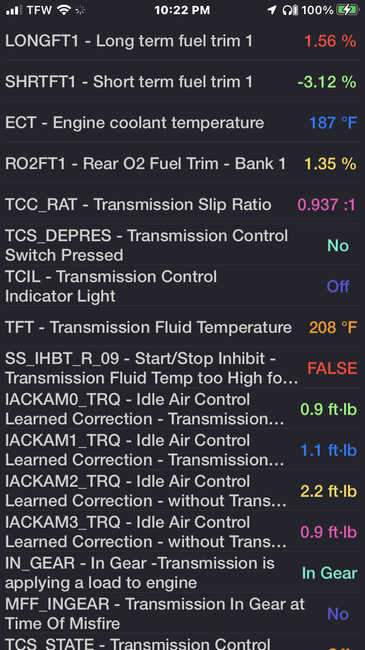

Okay, I’ve added the video of the noise, unfortunately it’s raining very hard right now when I took it. Make sure your volume is all the way up or use an ear bud so you can hear it. It sounds faint but in reality, it’s definitely not faint sounding. Also, I pulled all the transmissions od2 sensor data and attached it as well maybe that might tell you more b.

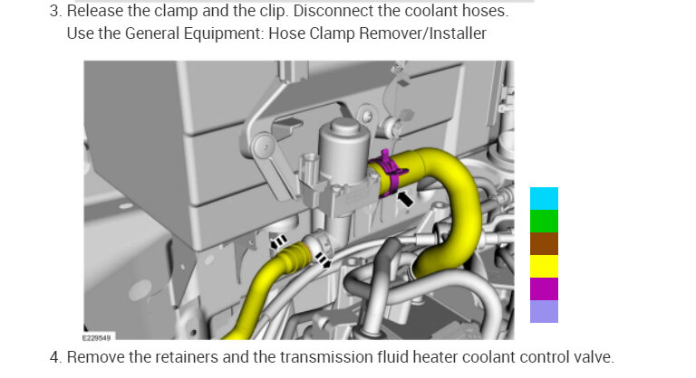

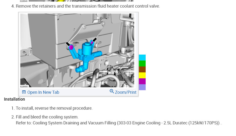

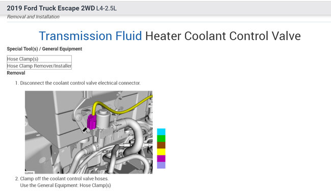

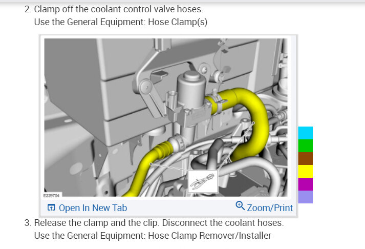

Thanks for the video. That is not a clogged filter that's for sure and the readings look normal except for the transmission temperature should be lower than the engine temperature I believe. I did notice that the transmission has a fluid temperature warmer so this might be normal. You could have a thrust bearing going out inside the transmission which means it needs to be rebuilt. Here is the fluid temperature valve for your information.
