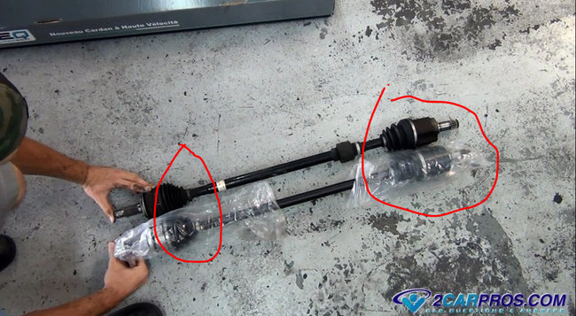

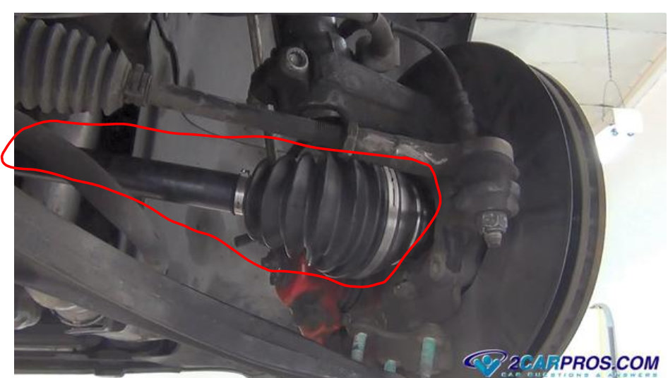

It sounds like you may have broken axle. Take a look through this link that explains what a CV axle is. There are two on your vehicle. There is one on each side of the vehicle.
https://www.2carpros.com/articles/how-a-cv-joint-works
If you look at the first attached picture, I circled the two places the joints are located on the axle. If one of these broke, it will cause what you are experiencing. In pic 2, I circled the axle so you can see location. It is behind the front wheel and goes to the transmission.
Check both of these on both sides of the vehicle.. Let me know if one is loose, or have a helper place the vehicle in reverse while you safely watch to see if one is turning and not moving the vehicle.
