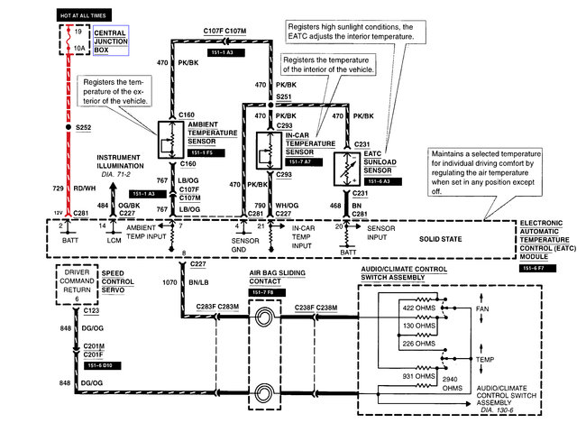

When i turn on the key the heating and air panel does not light up
13,457 MILES • 4.6L • V8 • 2WD • AUTOMATIC
JOE HODO

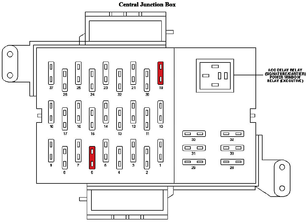

Is there a sparate fuse for the panel or when it does not light up it is shot?
The car starts up and runs fine, but the panel for heating and air does not light up and it is getting to be winter here soon. Thanks, Joe H.
Oct 16, 2019 at 6:41 AM
BMDOUBLE
  • 1,139 POSTS

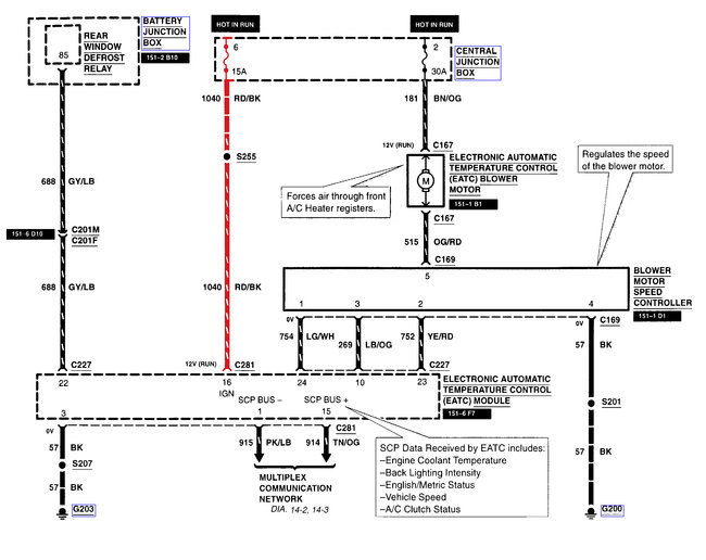

fuses 6 and 19 at the central junction box under the driver side dash will be for the HVAC control head. I have attached the diagrams and the fuse location so you can have a better idea where to look.
