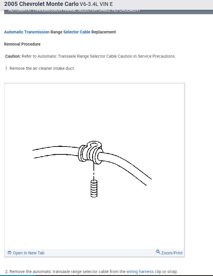

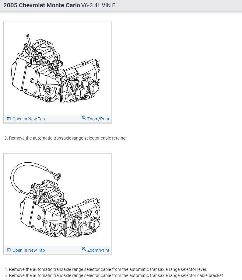

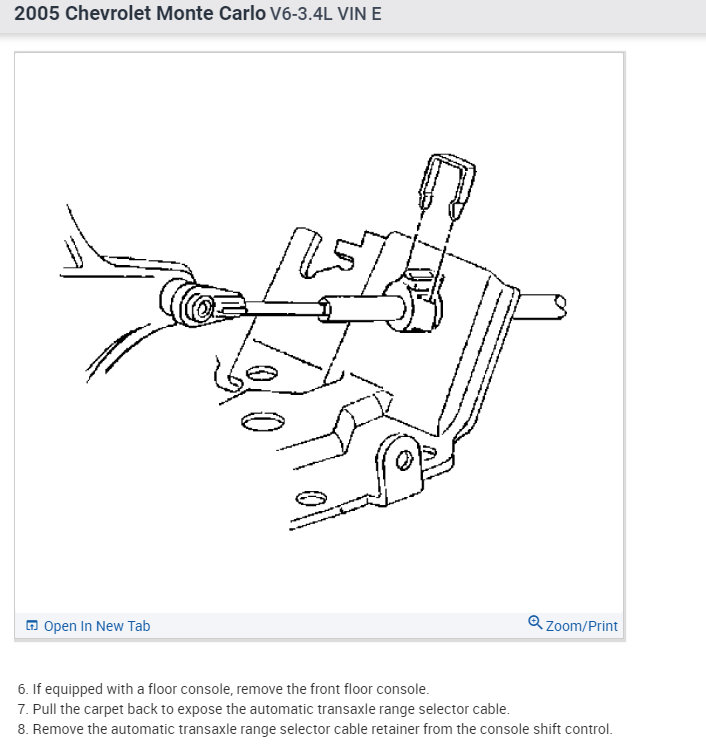

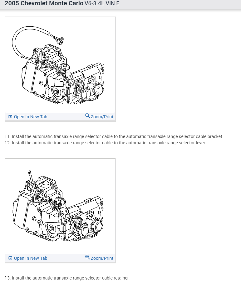

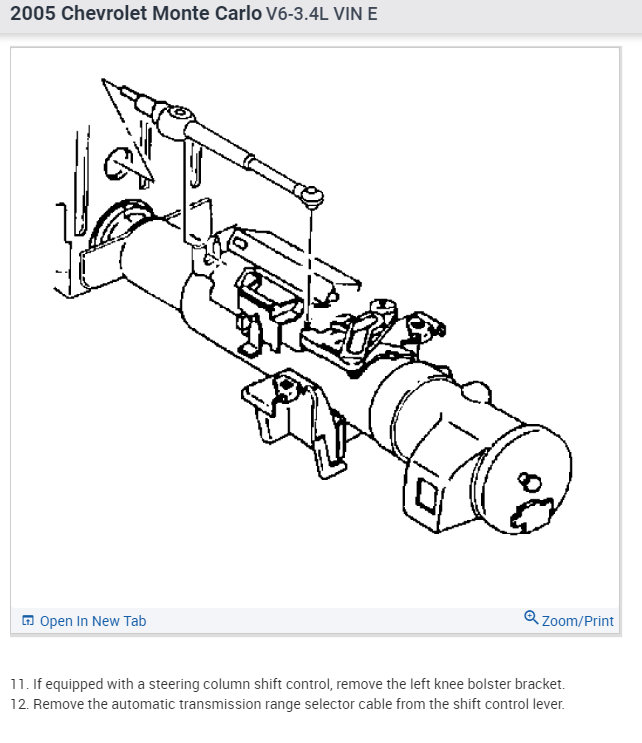

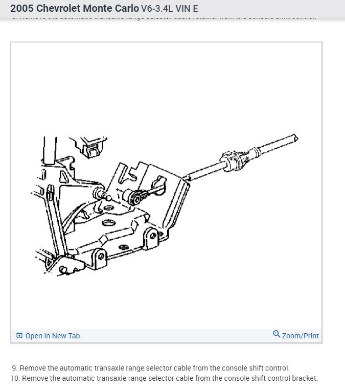

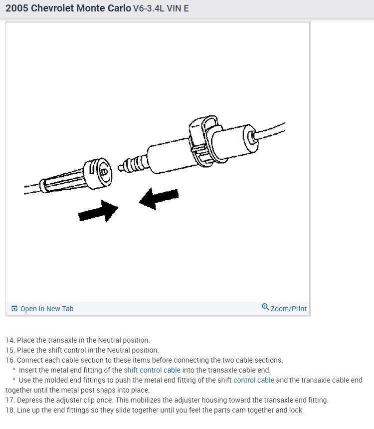

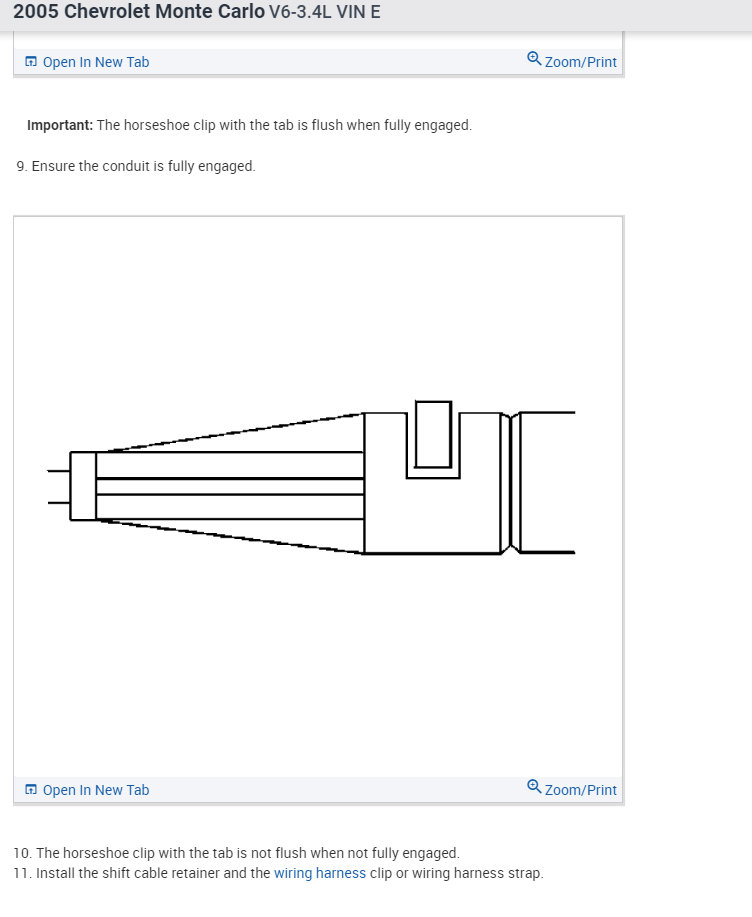

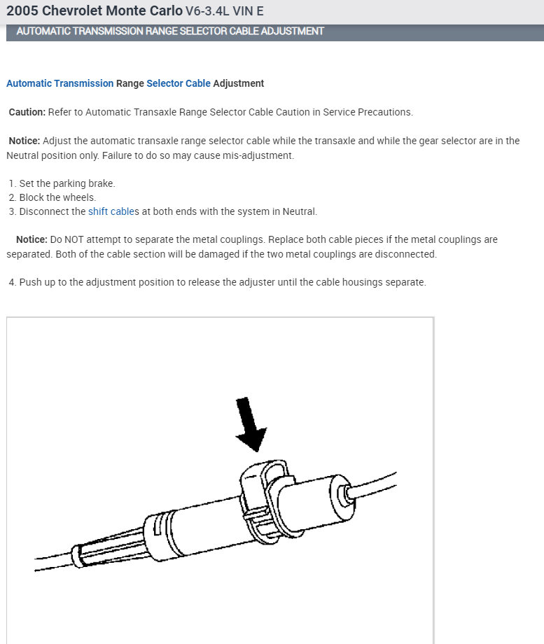

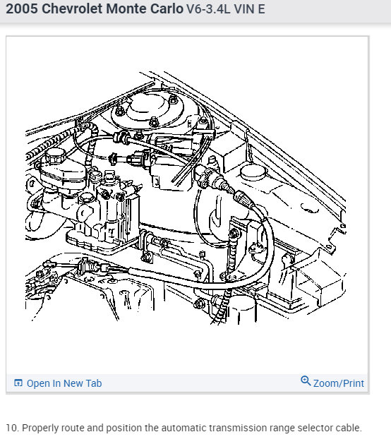

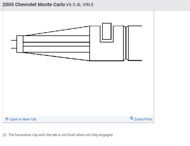

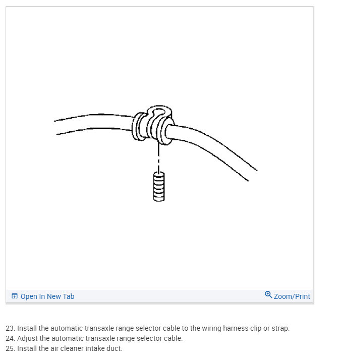

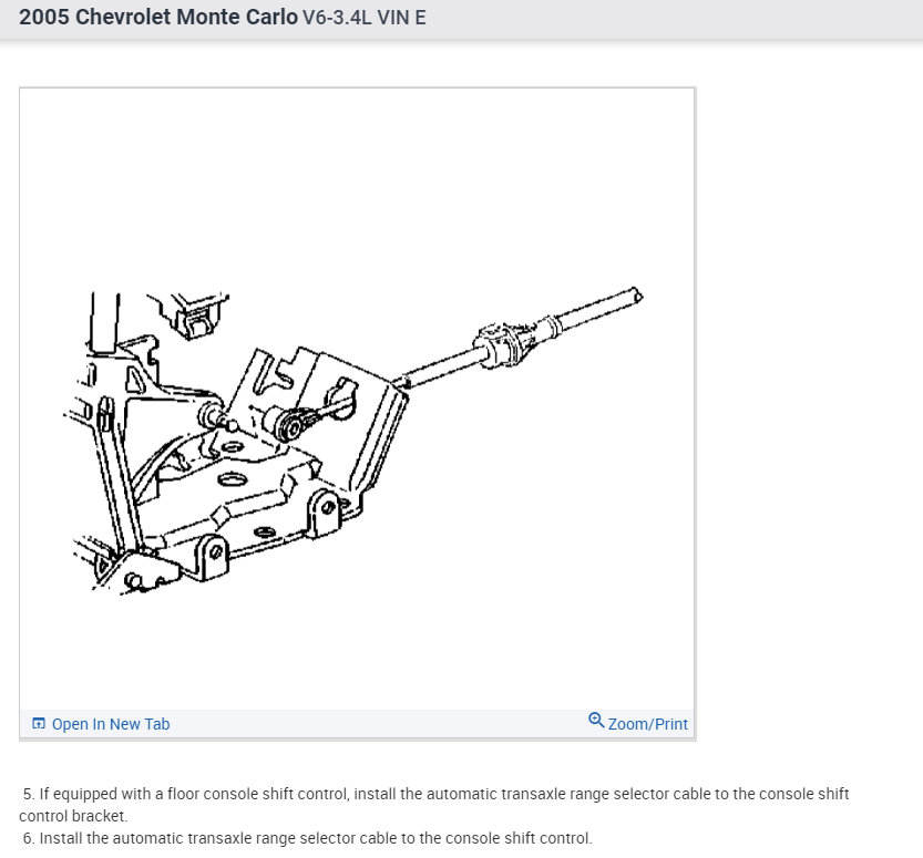

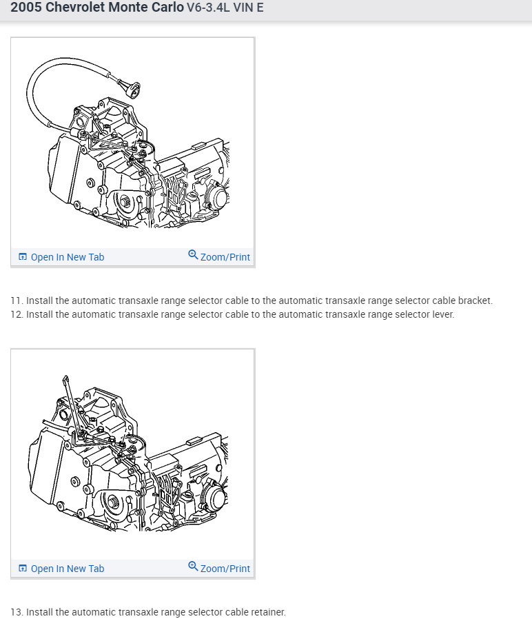

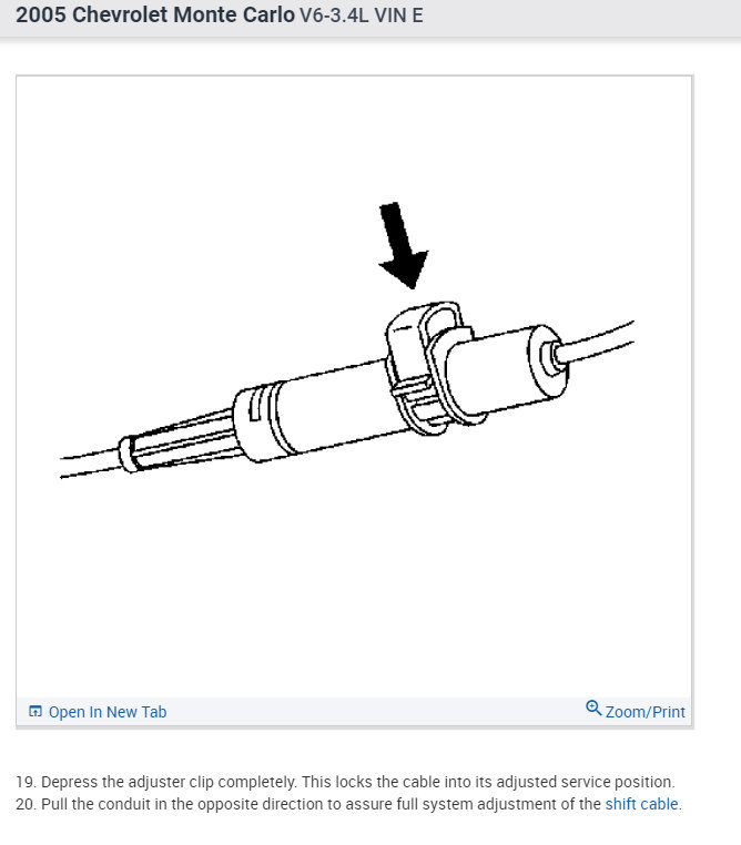

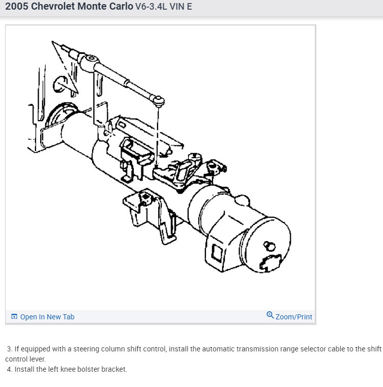

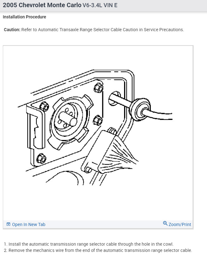

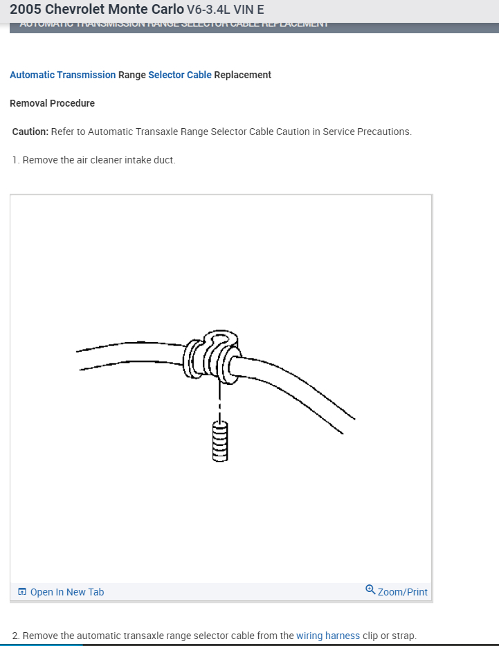

So, are you able to put it in drive or reverse or is it stuck in park?
Is it not engaging when put in drive or reserve?

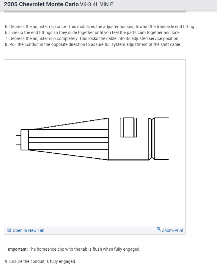

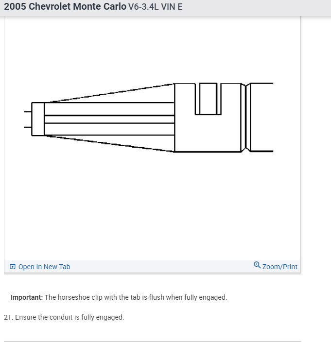

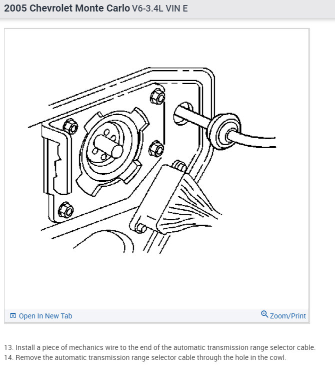

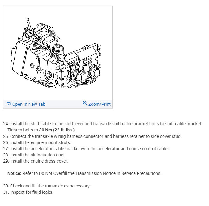

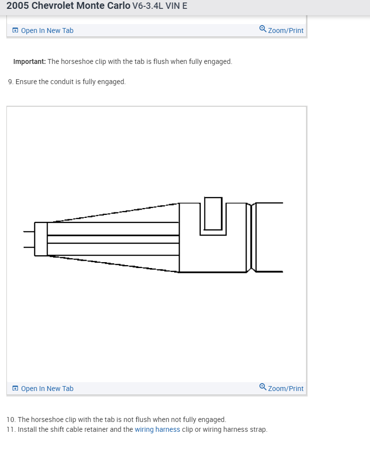

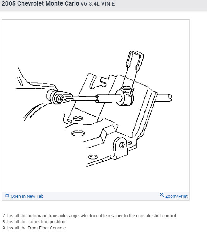

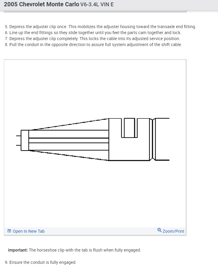

If it is an engagement issue, it could be due to malfunctioning shift cable for the transmission or a bad neutral safety switch.
It is possible that the shift cable might need to be adjusted to work properly.
https://www.2carpros.com/articles/how-a-neutral-safety-switch-works
Let me know a bit more details of what you have been experiencing and what type of symptoms did you have before this issue.
I have attached the shift cable adjustment and replacement procedure below.

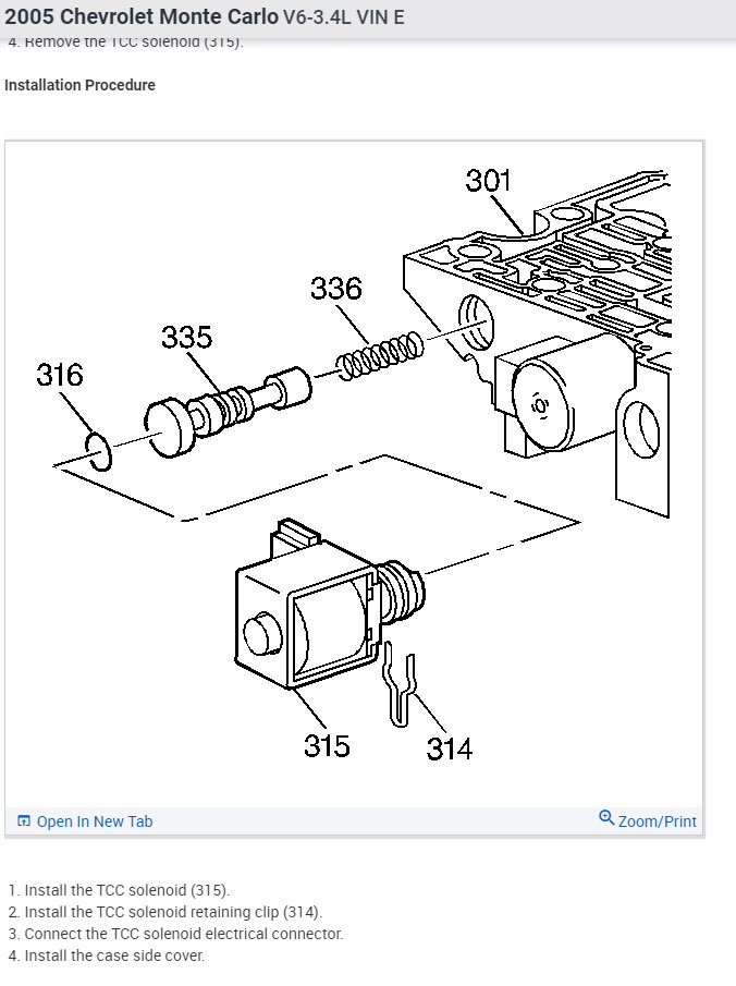

Thank you for the explanation.

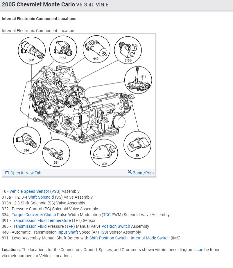

It does sound like the torque converter is engaging and disengaging.
It could be due to malfunctioning converter, or it could be the clutch solenoid for the torque converter. Faulty solenoid can trigger the engagement and disengagement of the converter.
Either of these issues will require either transmission removal or disassembly.

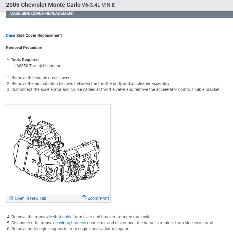

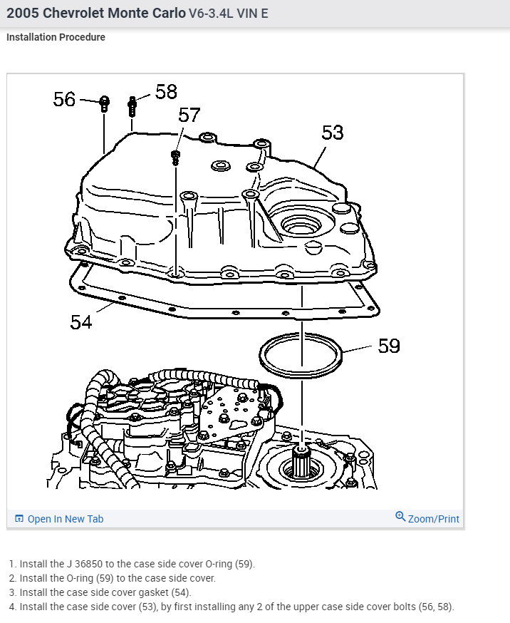

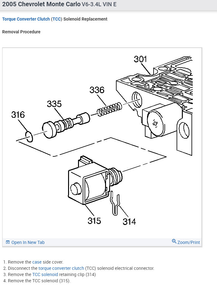

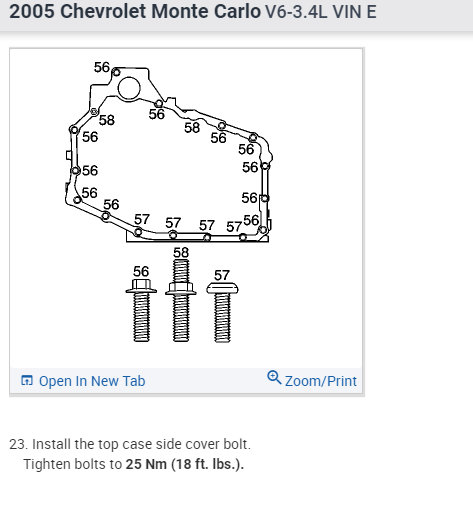

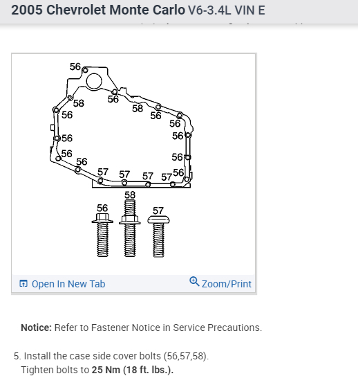

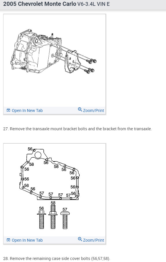

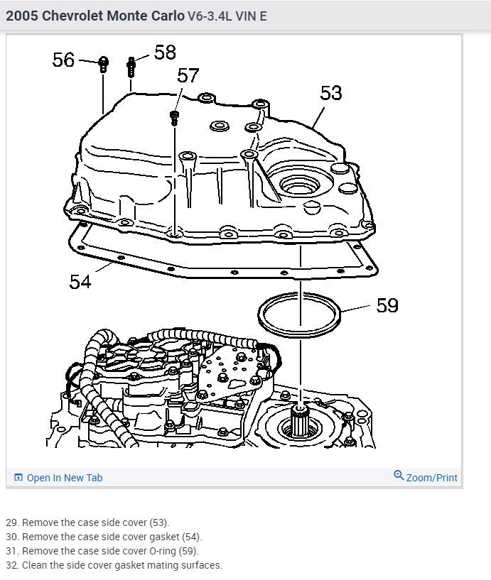

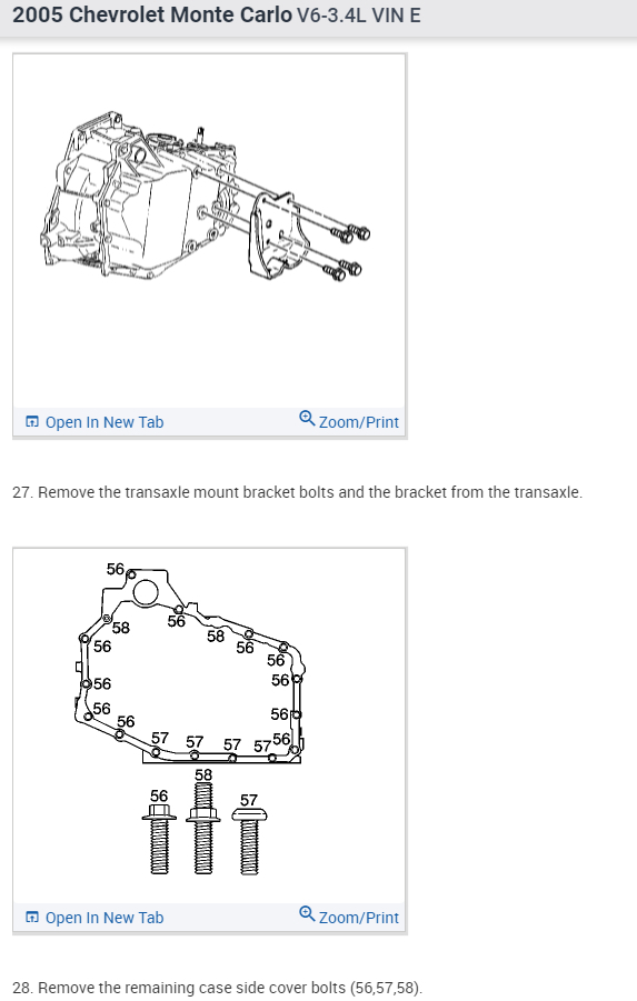

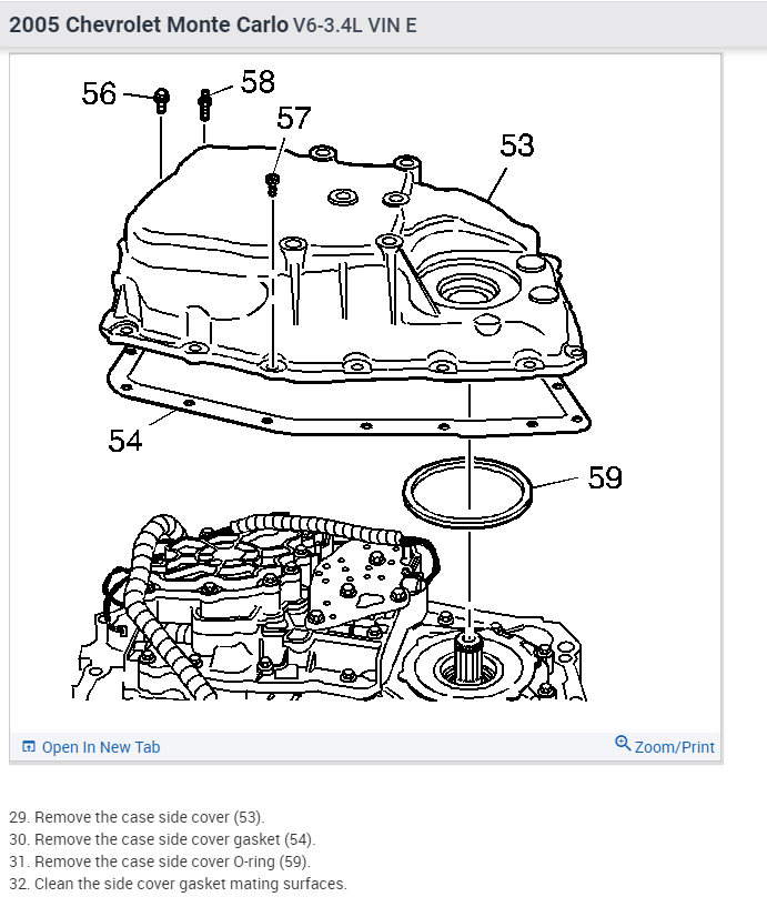

Now I was just looking up a video on YouTube and the torque converter clutch solenoid looks like I could have fixed it myself or do I have to drop the transmission to change them to the torque converter clutch solenoid?
Feb 2, 2022 at 3:37 AM
SQM
  • 6,383 POSTS

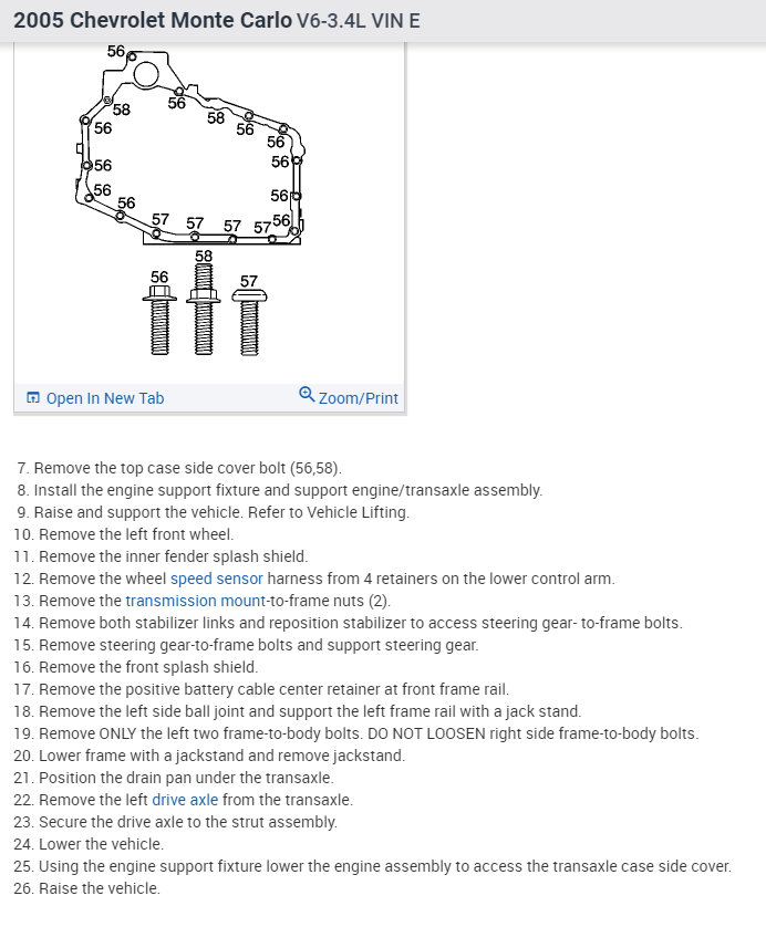

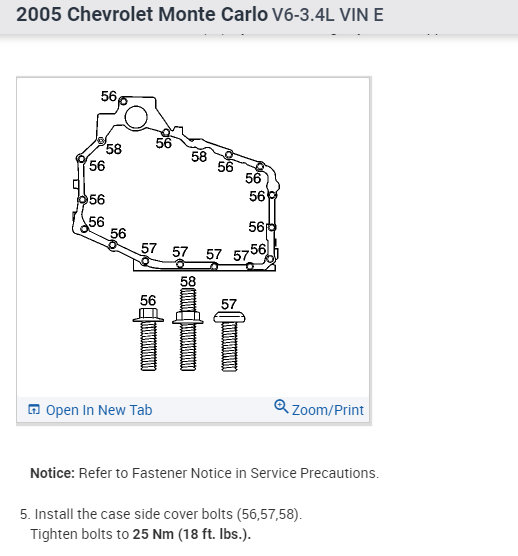

To replace the clutch solenoid, it will require removing the side cover of the transmission case.
Which can be done on the vehicle.
I have attached the procedure of how to remove the cover below for your reference.

If you are already getting a transmission and converter, the transmission will have the solenoid.
Generally speaking, when the torque converter is not engaged the engine can rev up without any movement, like you have experienced.
The solenoid acts as a gate for the flow of the fluid, if the solenoid is bad, it will not allow fluid to pass and that will lower the pressure of the fluid. Which can prevent the transmission from engaging gear.
So, either of them can keep the vehicle from moving.
