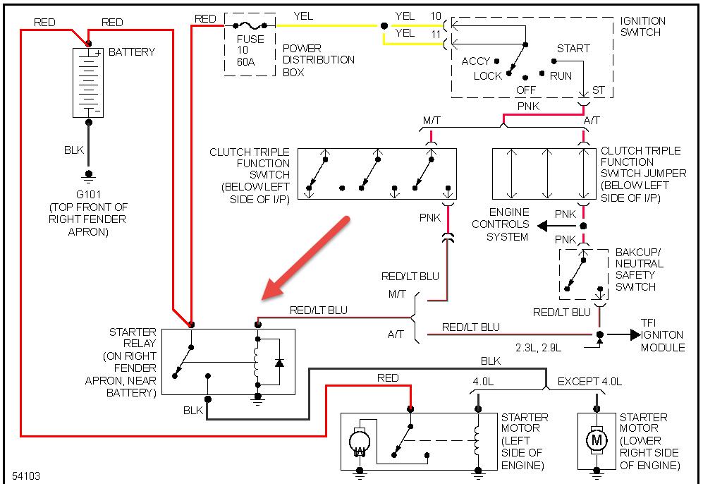

when I go to start it anything electrical dies

I replaced the solenoid but that didn't help. Fir the past few days I have had to arch the solenoid to get it to start. All the fuses are in tact.to get the power back on to the truck I have to pull both the positive and negative of fir a few seconds. The battery light is on.please help

then check for dirty terminal ends and maybe the starter relay may be going bad. where did you play with the cable ends by the relay if so then it's that oor the fusible links are going bad they are connected to relay and power up ignition switch for starting. see pic and its 'fuse 10 in power dist box

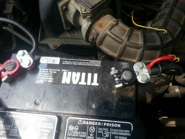

I played with the negative mostly and all the wires attached. I did bang in the positive. I did take the terminals apart and clean the corrosion.after I did all that it started 2 times in a row and now the lights don't cut out. But after the two successes I tried and I couldn't get the same results.does everything look wired correctly?

it looks ok but where does the small black wire I'm pointing to in pic go. as long as it doesn't go to the block or body then its' ok
