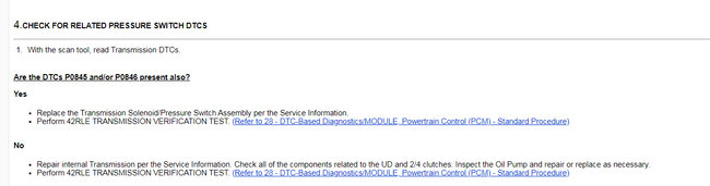

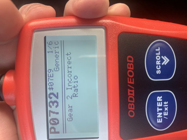

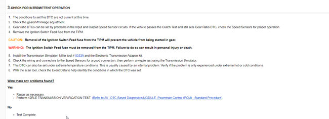

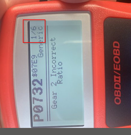

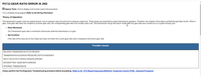

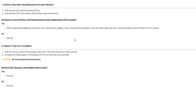

Okay, so I got a relatively affordable car diagnostics machine last night, i’ll send pictures of what it says.
Feb 27, 2020 at 12:07 PM
Yeah. That is about what I thought. However, this code is more of a secondary code so we need to look for the others that will shed more light on this for us. It looks like this is 1 of 6 codes. More than likely you have some transmission fluid pressure codes or other control issue codes. Unfortunately, based on my experience with these transmission, this code, and what you are describing, we are going to need to go into the transmission and rebuild it or replace it.
However, lets get the rest of the codes first because it could just be a valvebody issue.
