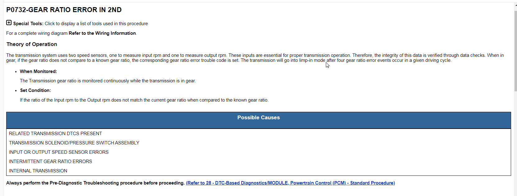

So sometimes when I’m driving down the road and tap on the brakes to slow down, the car stalls and the RPM goes over 4,000 RPM's. It fixes when I pull it over and restart the car. And sometimes the car won’t let me go over 35 MPH or 55 MPH, and the RPM's will stay at 3,000. There is also a possible rattle in my engine. This has been going on for a while. I would like to know how to fix it. Any help is appreciated!

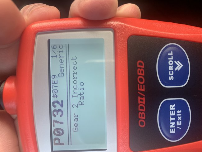

CHAZ PAYNE
Okay, so I got a relatively affordable car diagnostics machine last night, i’ll send pictures of what it says.
Feb 27, 2020 at 4:07 AM

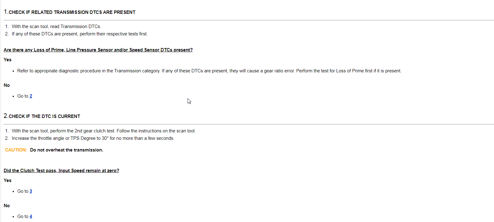

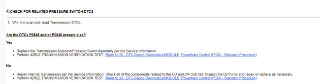

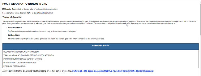

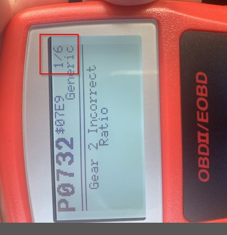

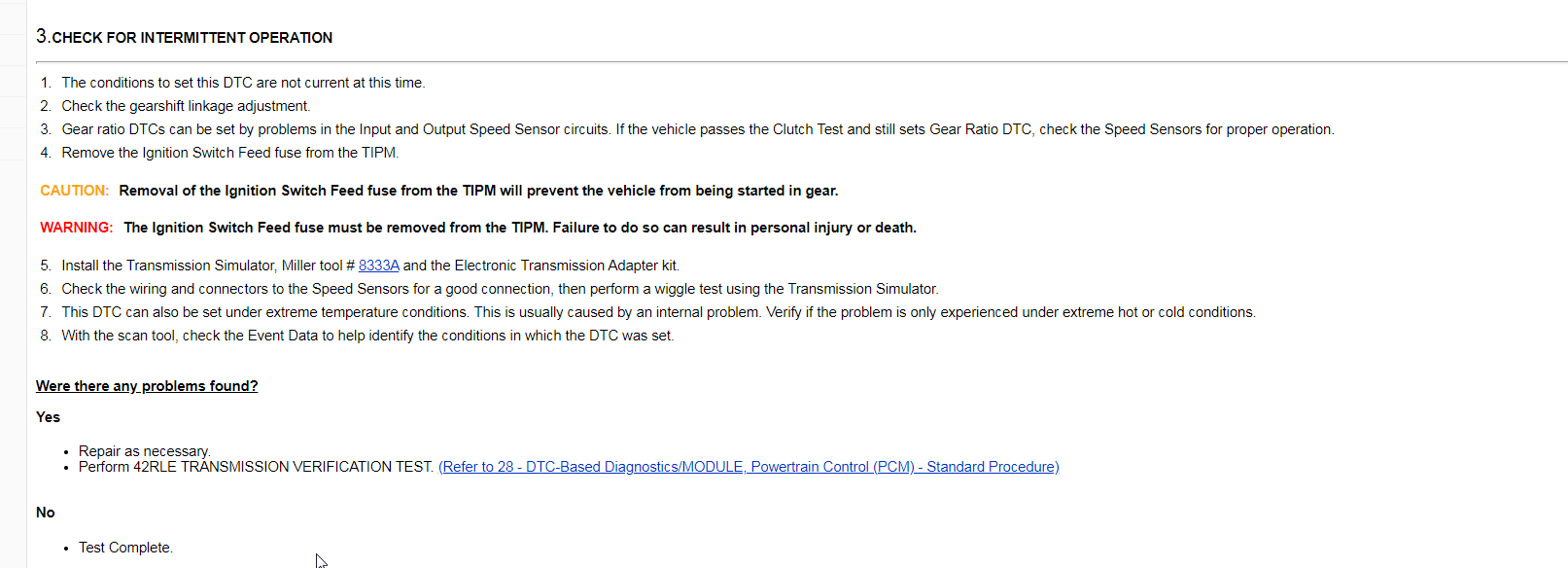

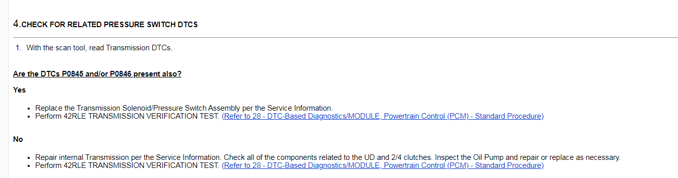

Yeah. That is about what I thought. However, this code is more of a secondary code so we need to look for the others that will shed more light on this for us. It looks like this is 1 of 6 codes. More than likely you have some transmission fluid pressure codes or other control issue codes. Unfortunately, based on my experience with these transmission, this code, and what you are describing, we are going to need to go into the transmission and rebuild it or replace it.
However, lets get the rest of the codes first because it could just be a valvebody issue.
