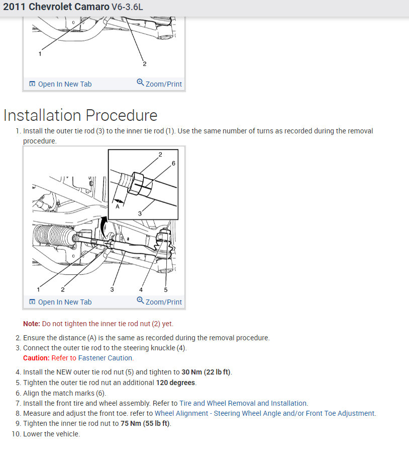

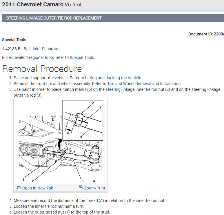

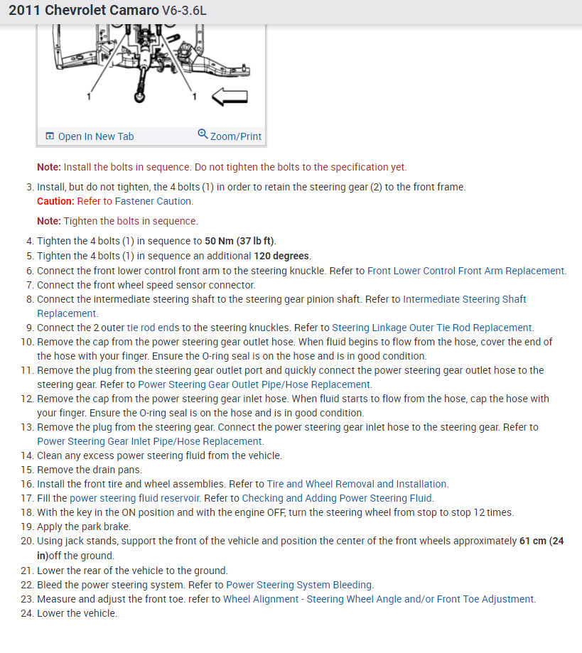

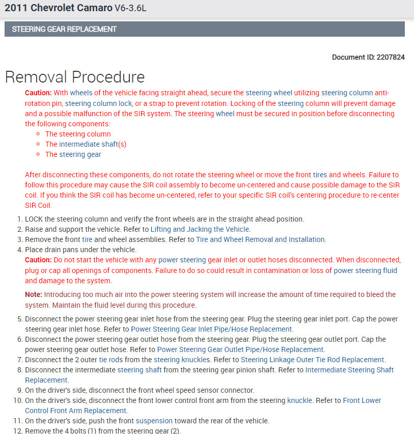

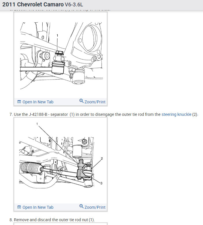

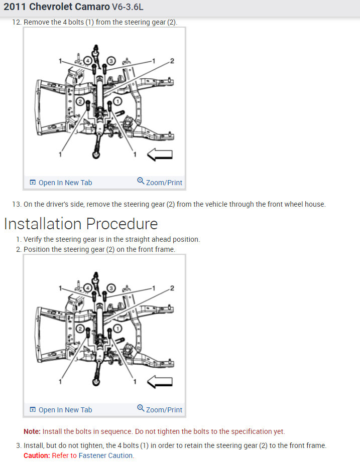

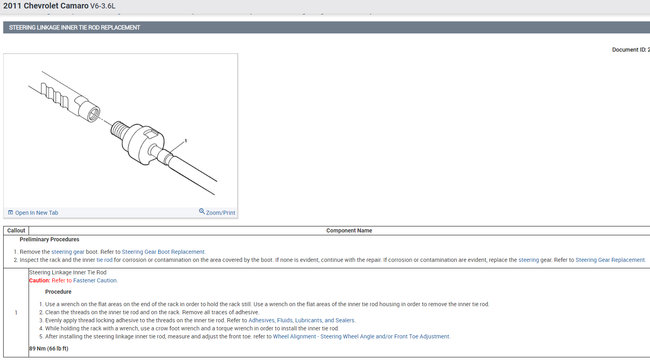

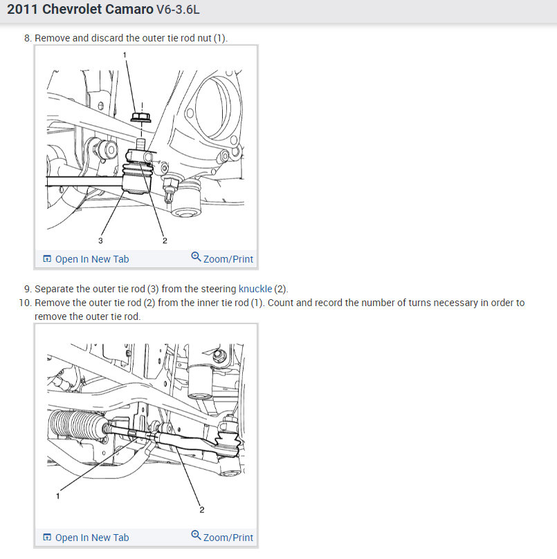

This sound could be from the steering rack or tie rod.
This could be due to a loose bolts that keeps the steering gear in place or a defective tie rod.
Raise the vehicle and secure it on stands then do an inspection of the steering components. Including the steering rack and the tie rod ends.
Typically a loose or broken component will create the type of noise your are experiencing.
Make sure that the steering gear is bolted securely to the subframe. Also look for any worn out bushings or loose linkage.
