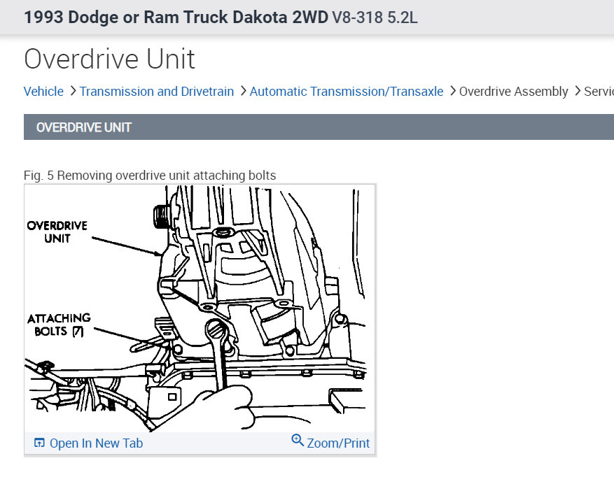

When at operating temperature transmission drops out of overdrive
135,000 MILES • 5.2L • V8 • 2WD • AUTOMATIC
JAMES BARRY MANEY

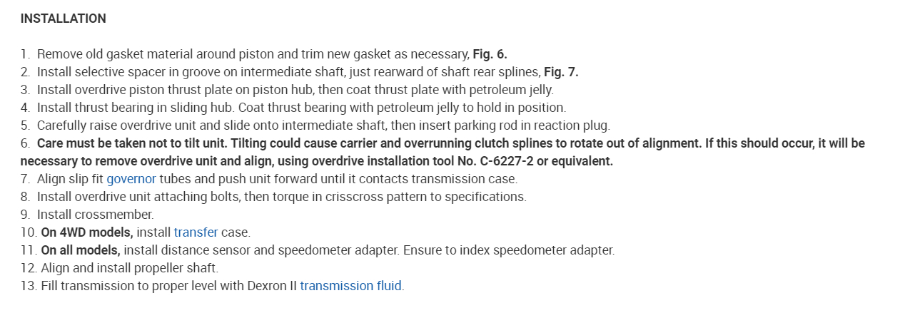

The transmission drops out of overdrive when you let it cool off it starts working again.
Jun 5, 2022 at 12:07 PM
  • 55,837 POSTS

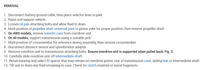

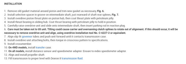

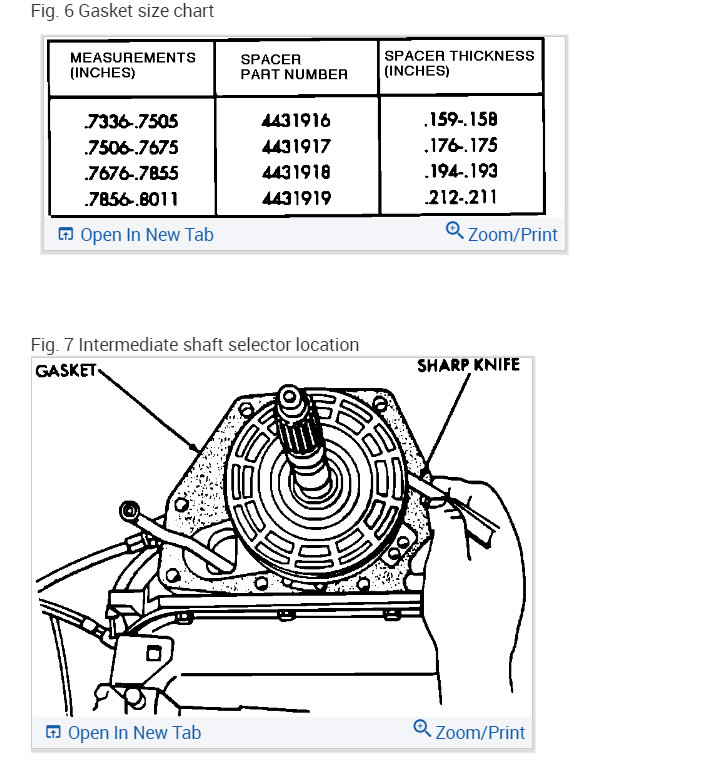

What happens is the overdrive unit itself wears out which bolts to the rear of the transmission. You will need to raise the truck up and remove the driveshaft first. Here is a guide to help you get started with instructions in the diagrams below to show you how to remove the overdrive unit:

Thanks ken L I will try it! Do you know if this unit is available at a parts outlet?
Jun 6, 2022 at 12:25 PM
  • 55,837 POSTS
I am not sure I think a transmission shop will need to rebuild the unit.
