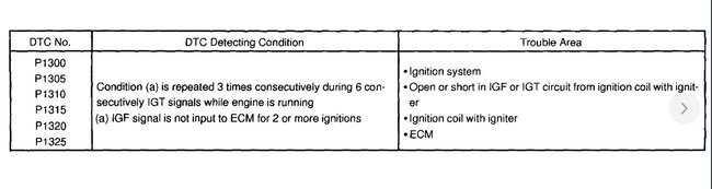

My check engine light flashes and runs okay until I give it gas then it sputters out and has no horsepower. fixed plugs and coil packs and also the top catalytic converter and it is still doing the same. help anyone?

The codes were p1310. I looked it up and it says to replace the number 3 coil pack?
Mar 23, 2019 at 4:33 PM (Merged)

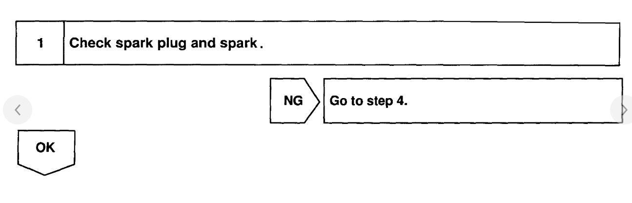

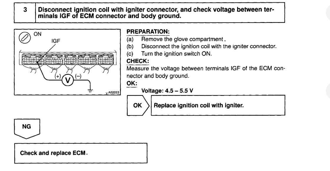

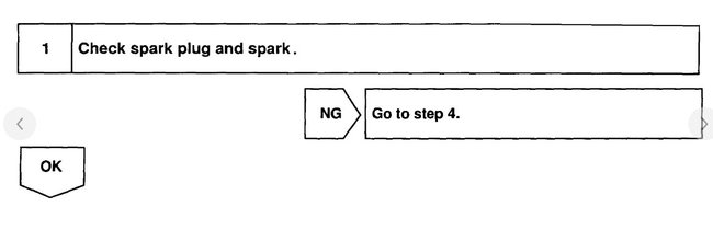

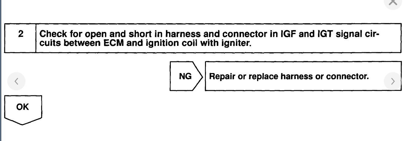

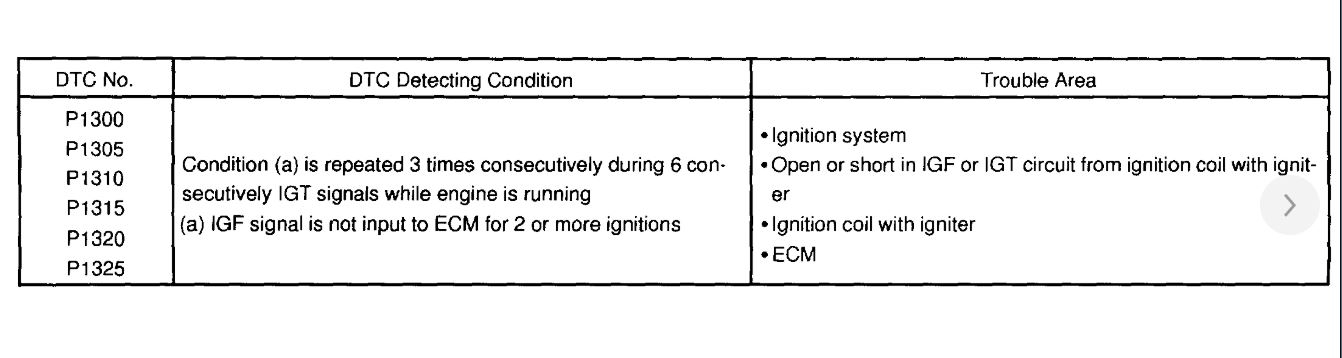

Good evening,
Codes do not tell you to replace anything. they tell you the area of failure. Diagnostics have to be done and repairs made.
The code is for coils. It could be wiring or the coil.
I attached a chart and description for you to view.
CIRCUIT DESCRIPTION
A Direct Ignition System (DIS) has been adopted. The DIS improves the ignition timing accuracy, reduces high-voltage loss, and enhances the the overall reliability of the ignition system by eliminating the distributor. The DIS is a 1-cylinder ignition system which ignites one cylinder with one ignition coil. In the a 1-cylinder ignition system, the one spark plug is connected to the end of the secondary winding. High voltage generated in the secondary winding is applied directly to the spark plug. The spark of the spark plug pass from the center electrode to the ground electrode.
The ECM determines ignition timing and outputs the ignition signals (IGT) for each cylinder. Based on IGT signals, the power transistors in the igniter cuts off the current to the primary coil in the ignition coil is supplied to the spark plug that are connected to the end of the secondary coil. At the same time, the igniter also sends an ignition confirmation signal (IGF) as a fail-safe measure to the ECM.
