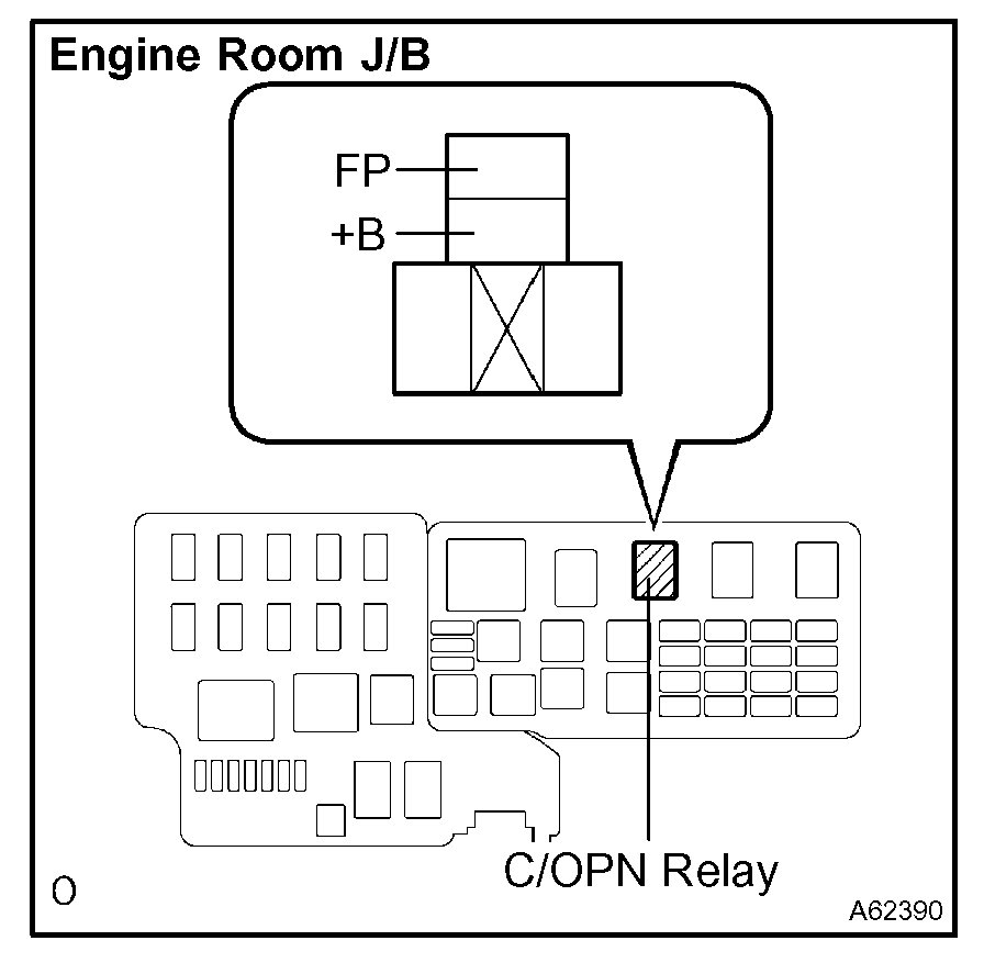

replaced plugs coils and car will not accelerate.
bogs badly hills, i cant even get up it and i can only go about 8 -10 mph. car idles okay no misses no check engine light.

What you are describing sounds like a weak fuel pump. With that, we need to check fuel pressure.
Here is a link that explains in general how it is done:
Here are the directions specific to your vehicle for testing. The attached pics correlate with the directions.

b. When not using the hand-held tester:
Check fuel pump operation.
1. Remove the C/OPN relay from the engine room J/B.
2. Using a service wire, connect terminals FP and +B of the engine room J/B.
NOTE: Pay close attention to the terminal connecting position to avoid a malfunction.
3. Turn the ignition switch ON, and check that the fuel pump operates.
NOTE: Do not start the engine.
c. Check that there are no fuel leaks after doing maintenance anywhere on the fuel system.
d. Turn the ignition switch OFF.
e. Remove the service wire from the engine room J/B.
f. Install the C/OPN relay to the engine room J/B.

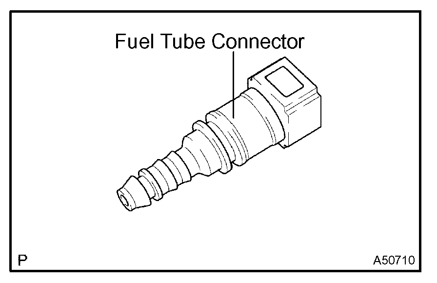

2. CHECK FUEL PRESSURE
pic 2
a. Check that the battery positive voltage is above 12 V.
b. Disconnect the negative (-) terminal cable from the battery.
c. Purchase a new fuel tube and take out the fuel tube connector from its pipe.
Fuel tube: Part No. 23801-20190

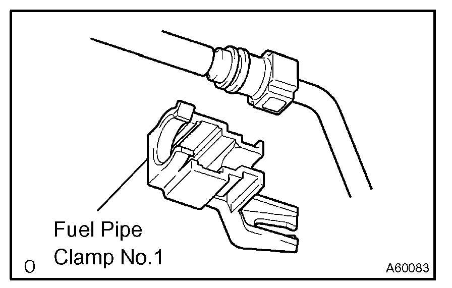

d. Remove the fuel pipe clamp from the fuel tube connector.

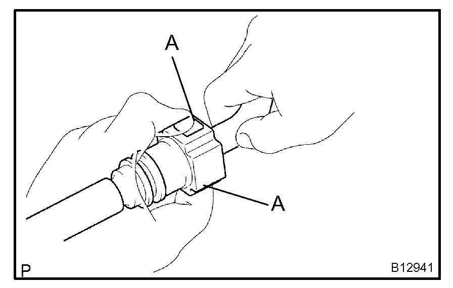

e. Disconnect the fuel tube connector from the fuel pipe by pinching part A with your fingers, as shown in the illustration.
CAUTION:
- Always read the precautions before disconnecting the fuel tube connector (quick type).
- The fuel pipe line may spray fuel as a result of retained pressure that remains in it. Do not allow fuel to be sprayed in the engine compartment.

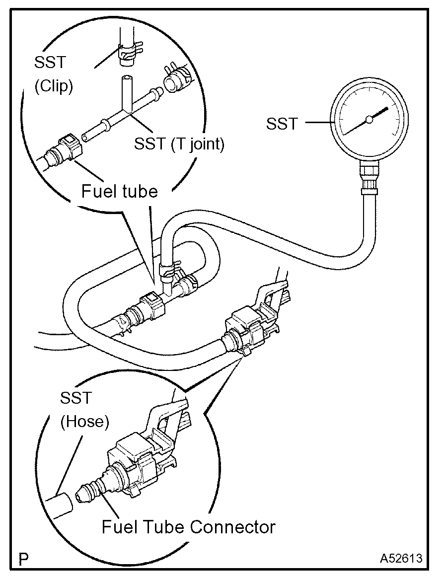

f. Install SST (pressure gauge) and fuel tube connector using SST as shown in the illustration.
SST 09268-41047 (90467-13001, 95336-08070), 09268-45014 (09268-41200, 09268-41220, 09268-41250)
g. Wipe off any gasoline.
h. Reconnect the negative (-) battery cable.
i. When using hand-held tester:
Operate the fuel pump (see step 1 (a)).
j. When not using hand-held tester:
Operate the fuel pump (see step 1 (b)).
k. Measure the fuel pressure.
Fuel pressure: 304 to 343 kPa (3.1 to 3.5 kgf/sq.cm, 44 to 50 psi)
If the pressure is high, replace the fuel pressure regulator.
If the pressure is low, check the fuel hoses and connections, fuel pump, fuel filter and fuel pressure regulator.
