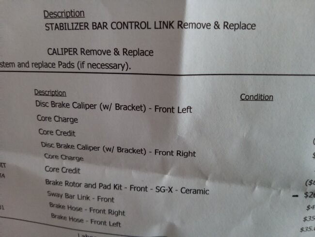

Looks like I had a few other safety problems. See attached shop list. But I guess I could have passed on the brakes. Where I'll be traveling there's a few rural hills to climb. Most roads are flat.

The parts I see listed can be justified at the mileage you listed, but it is also possible they can still be okay at that mileage, so it's a judgement call unless something is obviously wrong. Anti-sway bar links are a commonly replaced part. They usually aren't very expensive and replacing them does not require an alignment.
In the 1980s it was common to rebuild brake calipers as part of a normal brake job. A pair of rebuild kits cost about ten dollars. Professionally rebuilt calipers from an auto parts store ran around $100.00 each. Today calipers cause less trouble, but when they are replaced, the rebuilt ones from the parts store can cost as little as $20.00. It doesn't make economic sense to rebuild calipers at the shop anymore.
Brake rotors have also come down a real lot in cost. We don't have to charge for the time it used to take to machine old rotors, and pay for the consumables, (cutting bits, silencer belts). We could save over a half hour of labor time that we had to charge for. New rotors today cost less and save all that labor cost.
The only thing I should mention is you may develop a brake pedal pulsation within the next few months. When we make parts out of cast iron, we set them aside for 90 days to "age" before they get their final machining. Most new rotors today come from China. There's nothing wrong with the quality, but when the Chinese make them, they cast them, machine them, pack them, ship them, then they age on your vehicle. Minor warping is very common, but a light machining will take care of that. Most auto parts stores or repair shops involved with these rotors will do that machining for free. That warping usually only happens once, usually within three months. It is even somewhat common on many new vehicles.
