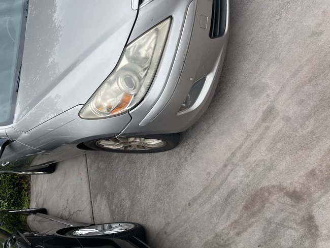

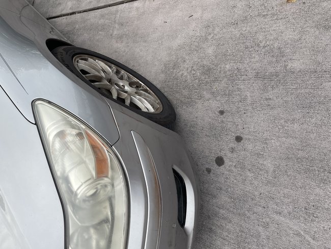

What can cause both front wheels to be tilted out from bottom or tilted in from top?
2009 HYUNDAI GENESIS
215,000 MILES • V8 • 2WD • AUTOMATIC
BHAMDOC1973
  • 2,007 POSTS
The car drives good no shaking, steering is off center though, tires are good.
Aug 17, 2022 at 9:09 AM
SQM
  • 6,383 POSTS
It looks like the camber is off.
If it just happened all of a sudden then it could be due to hitting a curb or even a large pothole.
You will need to have the alignment done on this. As this will wear the inner part of the tire fast.
Let me know of any questions.
Aug 17, 2022 at 1:58 PM
