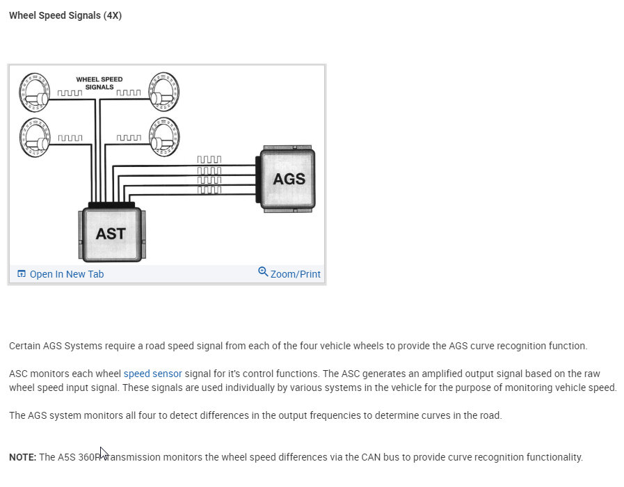

Scanner shows 3 of the 4 rear correctly while driving while the court reads 0, cleaned it, nothing. replaced it still nothing, keep getting these codes.
20 wheel speed sensor, front right transmits no signal.
5a brief power interruption.
battery had to be jumped, but still even so the fourth should at least show speed.
Sep 16, 2019 at 4:52 AM
If you are not getting a signal from that sensor then this is clearly the cause of the lights.
If the sensor is replaced, then you need to test the system by spinning the wheel with a meter on the sensor to see if the sensor is generating a signal. If not, then you have a wiring, sensor, or tone wheel issue. Here is a guide that walks you through this. If this all test okay and you are getting a signal, then the module may be your issue.
https://www.2carpros.com/articles/abs-wheel-speed-sensor-test
Give this a read and let me know what you think. Thanks
