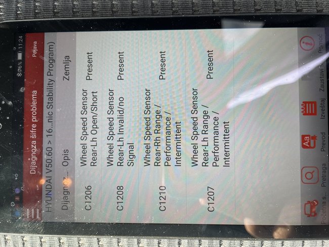

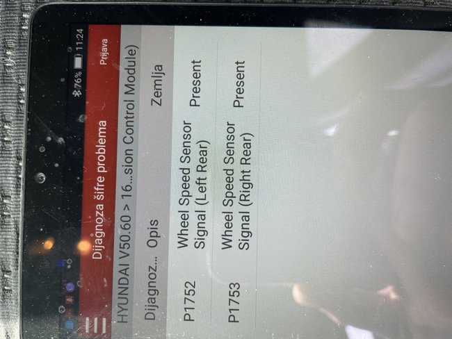

Rear right wheel speed sen­sor - an er­ror oc­curred, but af­ter two sen­sor re­place­ments, the prob­lem re­curred, the in­stal­la­tion was checked... What to do next?

Since you have already installed the wheel speed sensor with the same result. It is likely a wiring or a module issue.
Do you know which ABS code you have?
Was it C1211?
I have attached the troubleshooting steps for code C1211 below. This shows the possible causes and steps to diagnose the issue.
https://www.2carpros.com/articles/abs-warning-light-on-easy-repair-guide

I still haven't been able to solve the problem…
Installation changed, sensors also, after a few days of driving, there is a problem again.
It appeared after I went through the water, I began to doubt the master who changed the installation. I'll have to check with another service.

Try going thru the trouble shooting steps that I uploaded on the response.
This could be a wiring or module issue and will require checking of few items to pinpoint it.
Let me know if you are able to follow the guide and what you might discover.
