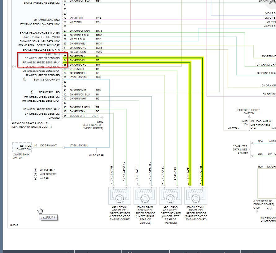

When I drive my vehicle the ABS light is on and after a short time my emergency brake light comes on and will not let the transmission shift but if I shut it off while going about 20 mph and restart it and rev it to about 1,500 rpm shift from neutral to drive it will kick into a higher gear and stay in that gear until I start the process again. Sometimes it will shift like nothing is wrong for some time then lock it into gear at some point while I'm driving or stopped. One of my wheel speed sensors has a broken wire and when I used OBD tool code 501 came up with code 700. Could a wheel speed sensor be the problem?

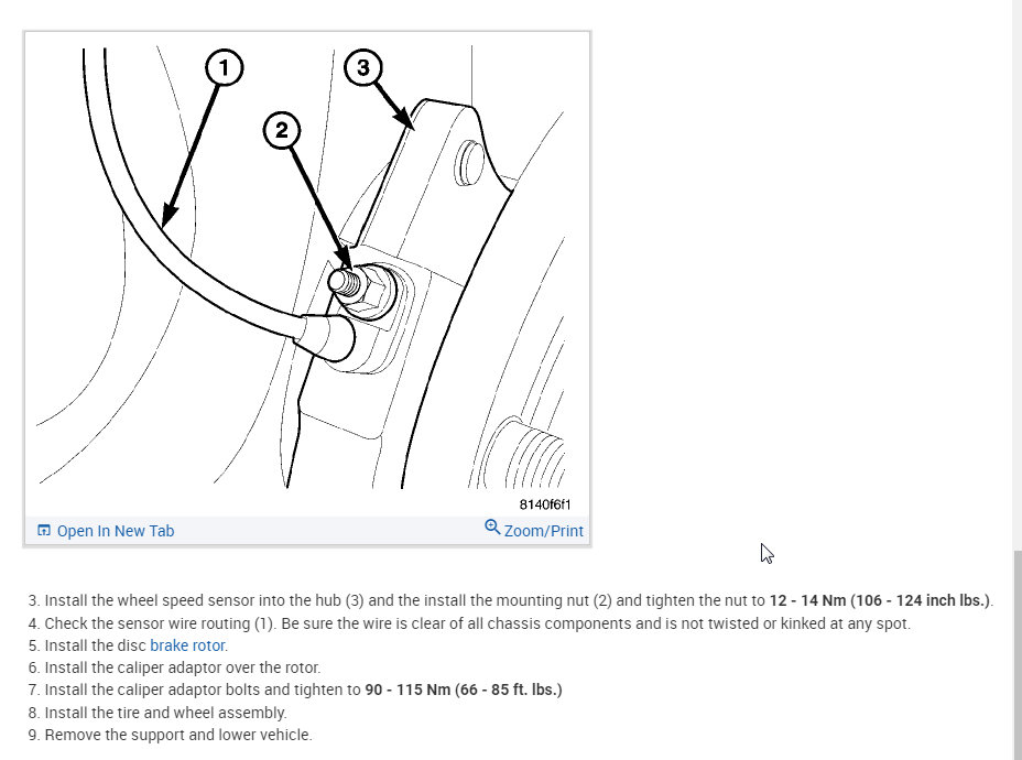

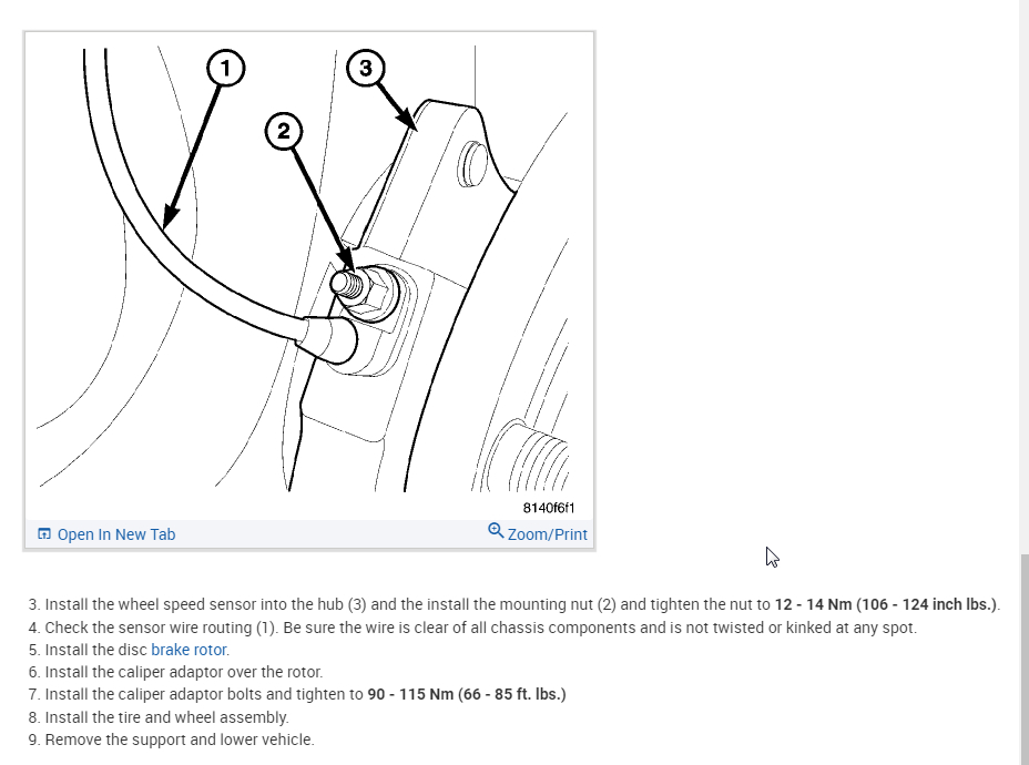

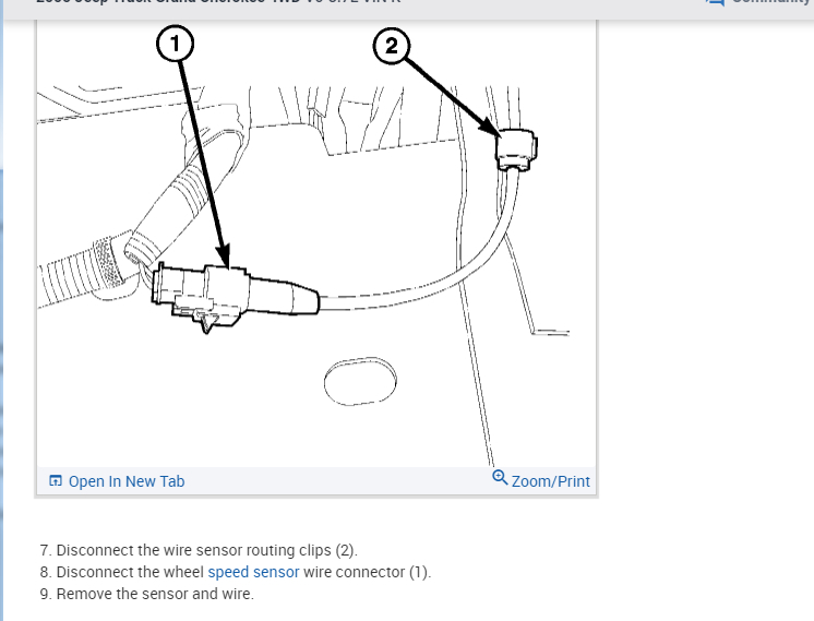

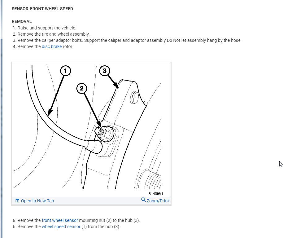

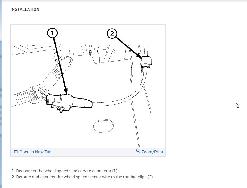

Short answer, yes.
I attached the process on how to replace the wheel speed sensor. Clearly we could have another issue but we need to start with replacing that speed sensor and then retesting the system.
Basically the wheel speed is needed to determine if a tire is slipping for ABS operation. When we don't get a good signal from one of them, it sets the ABS light and brake light. The fact that a wire is broken is where we need to start.
Let us know what you find.
https://www.2carpros.com/articles/abs-wheel-speed-sensor-test

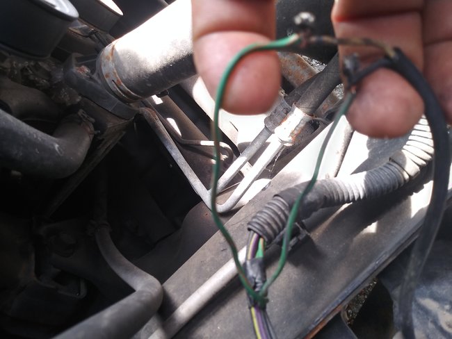

Okay update: I ordered the wrong wheel speed sensors so the rear wheel speed sensors have been replaced and I'm waiting on the front ones. But I have a question that maybe I overlooked the answer to. Does it matter which wire I connect the new connector to? since the old one was ripped out I don't really know how to put the new one in, I just assumed that red was hot black was negative or neutral.
Jun 5, 2020 at 11:14 AM
Good question. Yes this does matter. However, we don't want to splice together these wires because they are part of the ABS system. It can be done but we need to cut and solder.
Can you get a picture of where the wire was ripped off and maybe a close up picture of the actual wires and we can figure out if a wiring repair is possible or we need to get that harness from the module to the sensor?

I think there's plenty of wire and I already bought the new connector, so I'm going to try it. regardless I just need to know which wire is positive and which one is negative. there's an orange and green and a purple and green.

Another thing I forgot to mention is the person I bought it from said they twisted those 2 wires together thinking it would complete the circuit. I have checked fuses but I don't know if there is a relay or something more expensive that they might have ruined. Do you have a checklist that I can reference?
Jun 6, 2020 at 2:21 AM

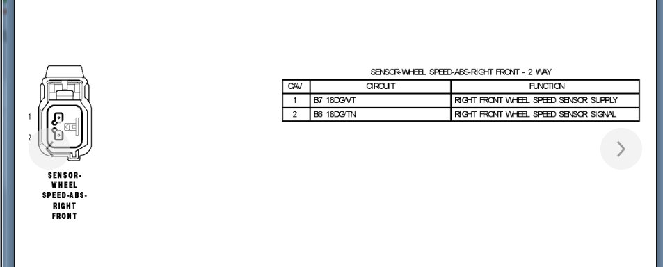

Okay. Here is the wiring diagram and just to level set, there is no positive and negative on this speed sensor. There is a sense signal and sense supply.
The supply wire (dark green and purple) is basically where the ABS module supplies the voltage needed by the wheel speed sensor. The signal return (dark green and tan or maybe orange) is the return from the sensor telling the ABS how fast it is spinning.
These wires need to be connected to the connector pins on the connector or the ABS will not get the correct signal.
I included the wiring diagram and the connector view so that you get the wires on the correct pins in the connector.
As for twisting the wires together, that is just going to tell the ABS module that the sensor is shorted and most likely did no damage. There are no fuses or relays for this as it is a direct input to the ABS. Clearly they didn't know what they were doing so I am sure your repair will be fine. Just make sure you solder the wires together and not use a butt connector because that will not hold up and can distort your signal.
The reason I said we don't want to make wiring repairs on this is because you are adding the possibility of added resistance. This is going to distort your signal back to the ABS which means the ABS is going to think this wheel is traveling a different speed because the other wheels don't have this. However, if you solder them in you should be fine.
