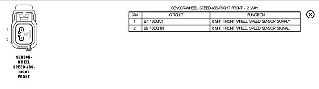

Are the wheel speed sensors active or passive on this vehicle? Active sensors receive battery voltage when the ignition is on and return a signal. Passive sensors are magnetic and generate current to return the signal. I need to know which this vehicle uses in order to determine the proper test procedure with a multi-meter. I am not sure what you found confusing about the original question.

Yes these are active hall effect sensor that use a small amount of voltage to work (2 wire sensor) The sensors convert wheel speed into a small digital signal. The ABM sends 12 volts to the sensors. The sensor has an internal magneto resistance bridge that alters the voltage and amperage of the signal circuit. This voltage and amperage is changed by magnetic induction when the toothed tone wheel passes the wheel speed sensor. This digital signal is sent to the ABM. The ABM measures the voltage and amperage of the digital signal for each wheel.
