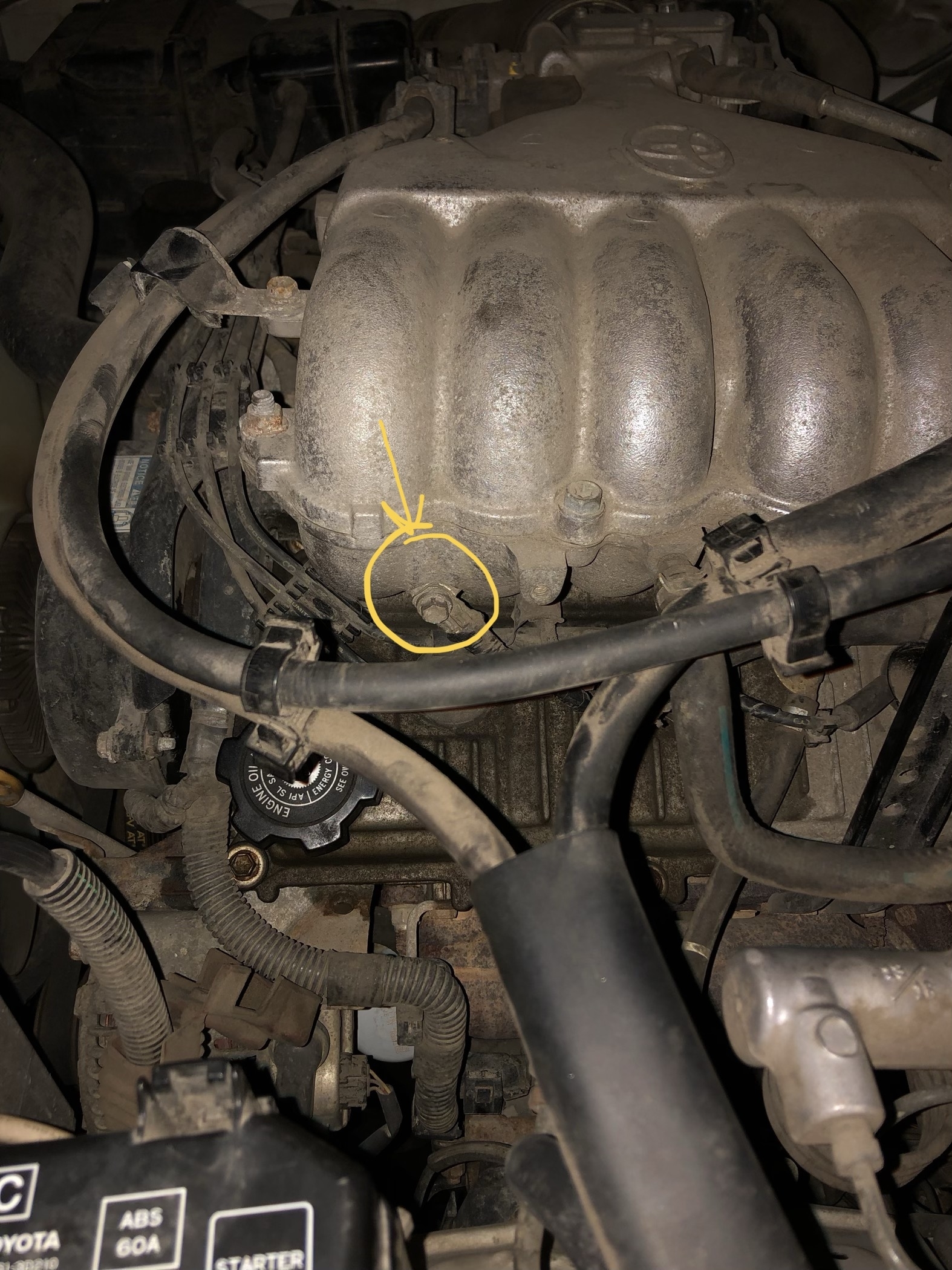

My engine was misfiring. So I ran an OBD test and it said cylinder five was misfiring. I changed all the spark plugs and now my check engine light is on with seven new codes. Four of which are Wheel Speed Senor Malfunctions. One for each wheel. The other three new codes are emissions. It seems hard to believe that all of my wheel speed sensors would malfunction at the same time unless I hit something and shorted the system. Any help on this matter would be greatly appreciated.

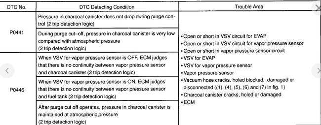

C0200
C0215
C0210
I forget the last one but it was the fourth wheel
Also
P0441
P0442
P0446
I disconnected the air intake hose for easier access to the passenger side spark plugs. I didn’t disconnect any other hoses, but moved them out of the way to get my socket through.
I did loosen some wires that were in the way of cylinder number 1. I tightened them back down when I was done. I’m attaching a picture of those wires.

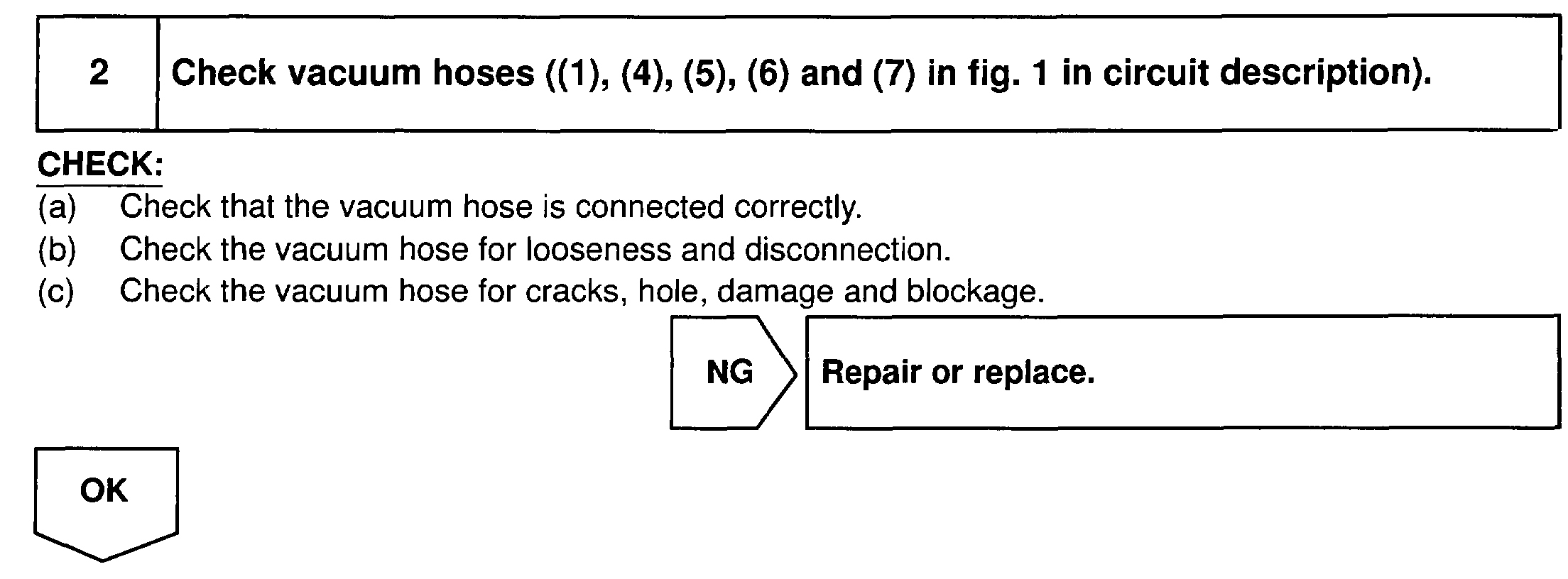

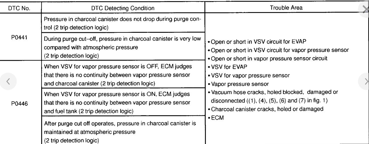

The EVAP codes I feel sure are related to either a disconnected vacuum hose, plugged hose, or an electrical component is disconnected. Also, the wire you show in the picture looks like a ground. Make sure it is clean and tight.

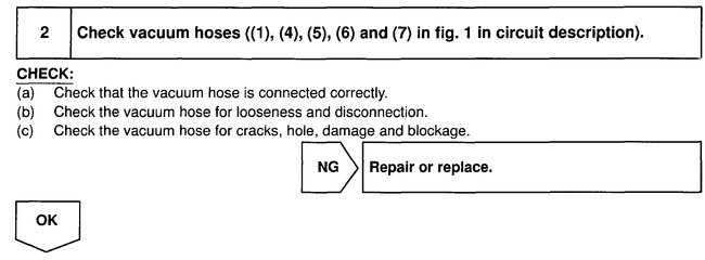

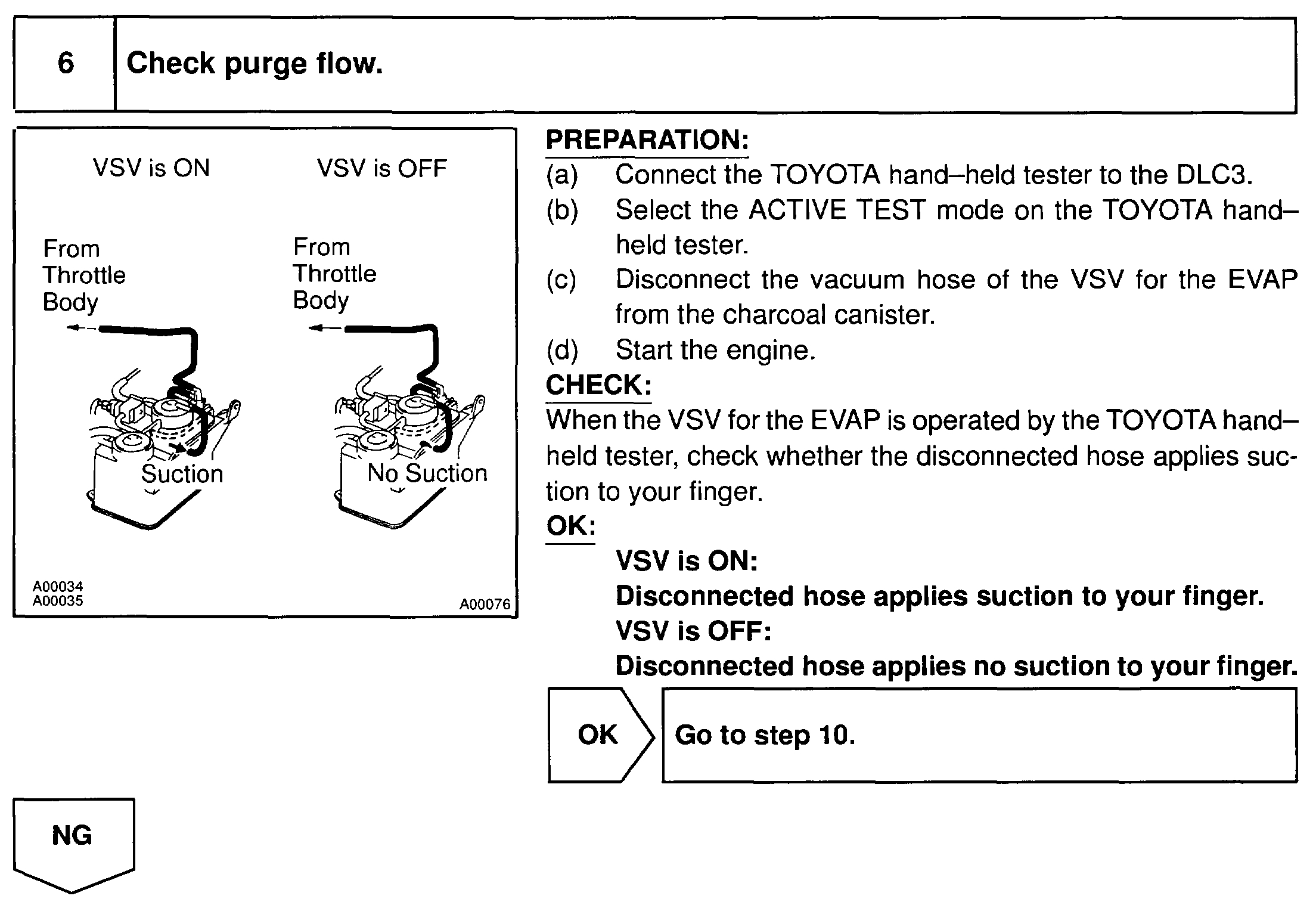

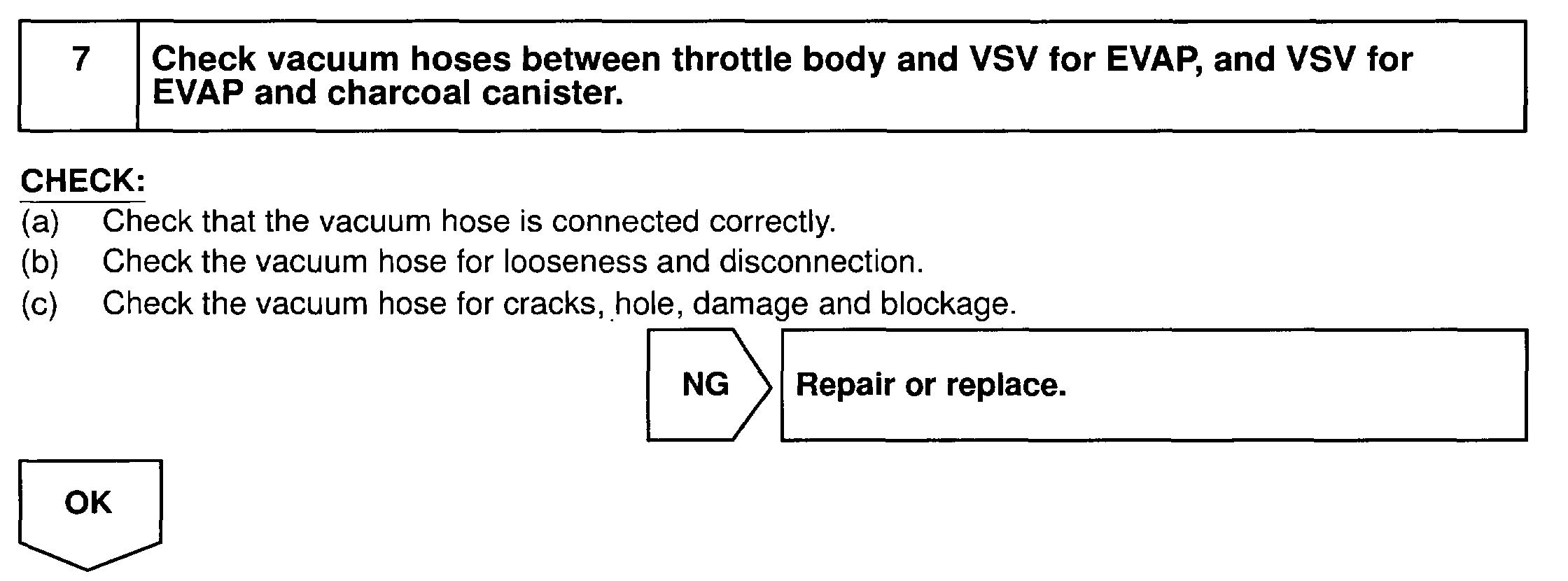

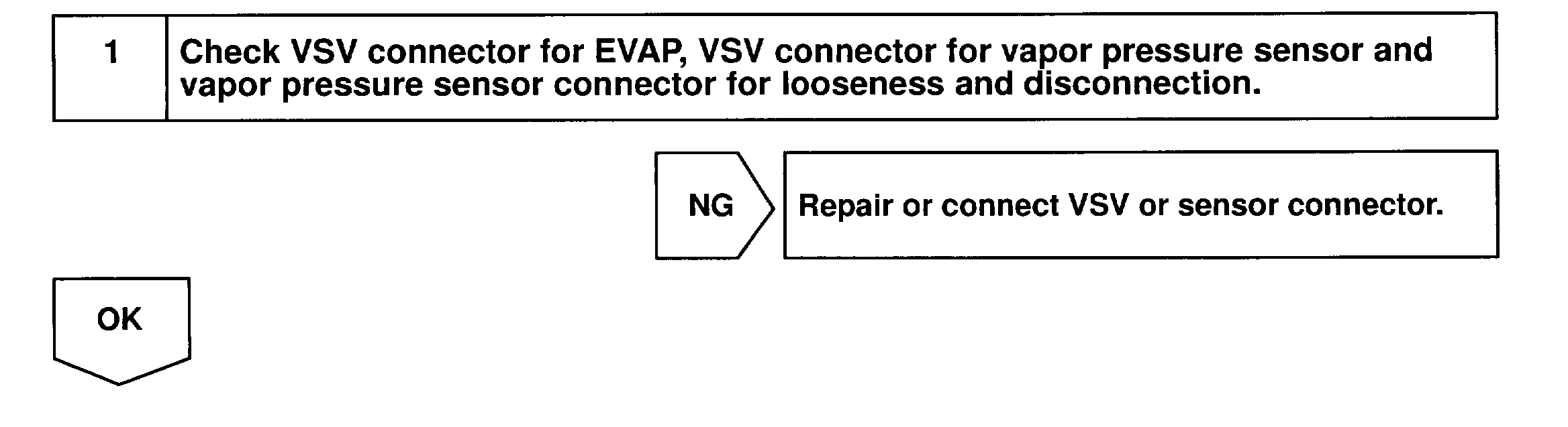

Take a look at the first pic. It indicates possible causes. You will see that vacuum or a disconnect wire can be the cause. Pictures 2 - 5 discuss diagnosis for vacuum/electrical.

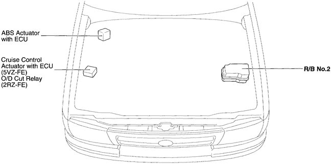

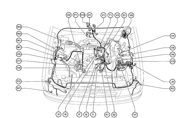

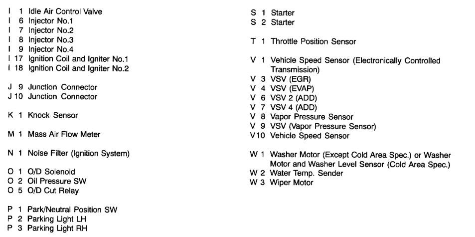

Picture 6 and 7 show component locations under the hood. Notice the components I am suggesting to check are right in the area you were working. Picture 6 shows locations of different components. Pic 7 is a legend of the parts listed. You need to check VSV components 3,4,6,7,8,9. Any of these can cause the EVAP trouble codes.

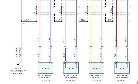

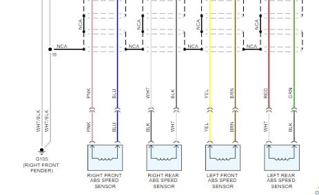

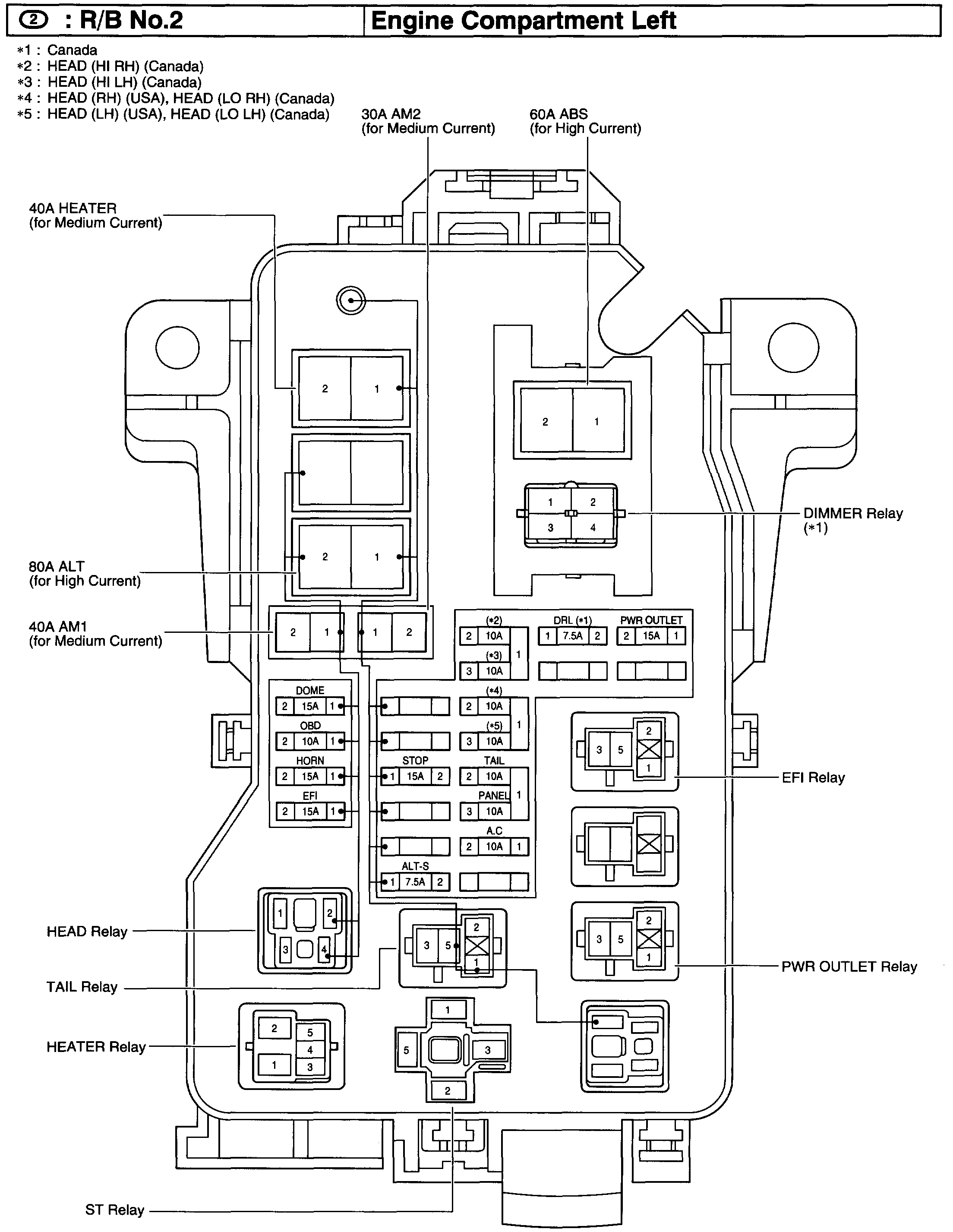

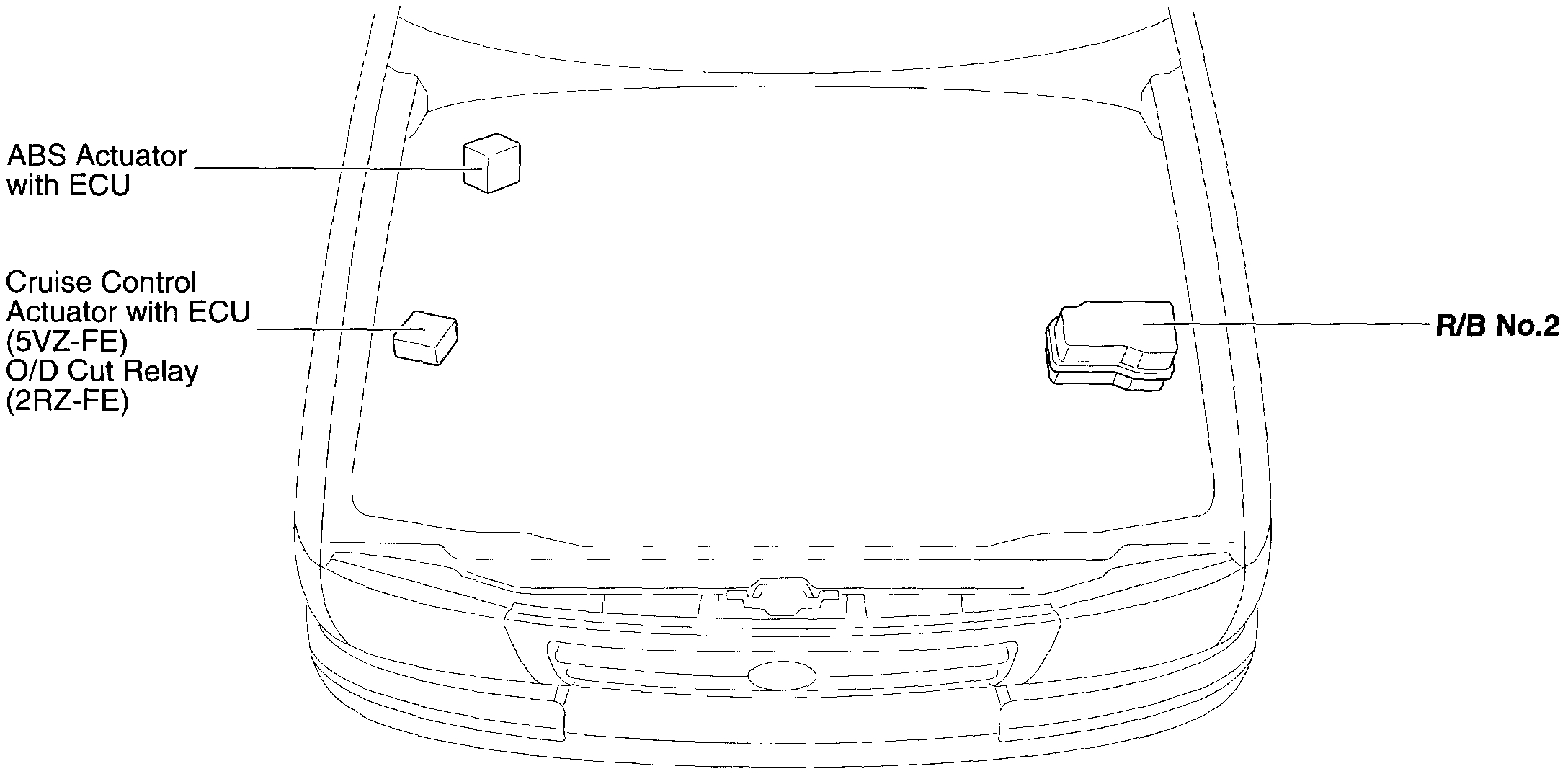

Next is the ABS. There is one common ground for all wheels which is provided through the abs actuator with ECU. Now, the ground ls located on the right front fender. There will be two white wires with a black tracer. See schematic in piture 8. Check to make sure that wasn't damaged while working on the vehicle. Also, check the ABS 60 amp fuse in the under hood fuse box. Pictures 9 and 10 are included for you to see the location of the ABS fuse and the ABS actuator with ECU location.
Since these new codes showed up all at once, the aforementioned things are the first things I suspect. Start with these and let me know the results.
