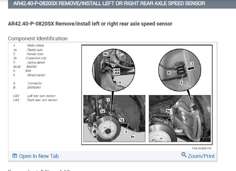

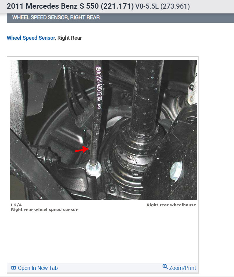

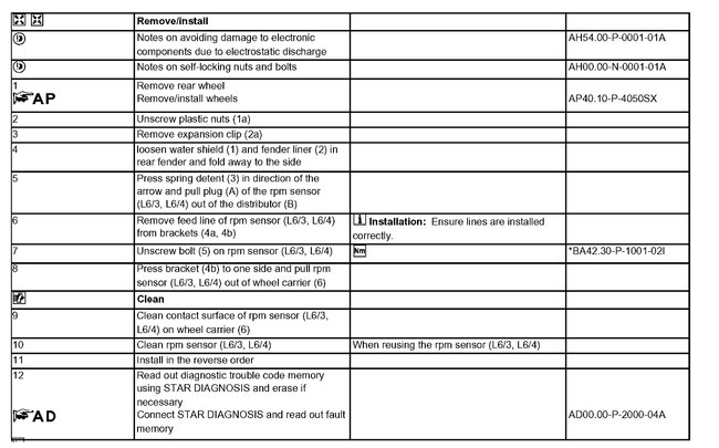

All lights on the dash of course, have a code 511700, is it usually the sensor? I scanned it and drove, and it is not reading, the others are. Also, the voltage is available on all 4.
Jul 5, 2022 at 1:11 AM
  • 55,433 POSTS

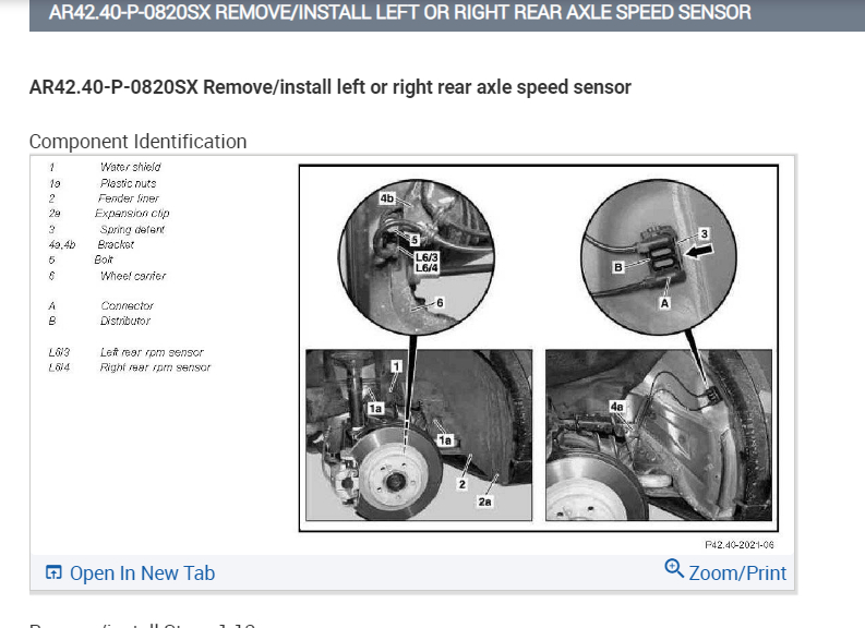

Yes, I would replace the wheel speed sensor, whichever one the code is telling you too, we don't have this code in the states, so it won't tell us which one it is, but here are instructions to replace the right rear in the diagrams below. Check out the diagrams (below). Let us know what happens and please upload pictures or videos of the problem.

Am in the states, it's right front not rear.

Go it, Check out the diagrams (below). Please let us know if you need anything else to get the problem fixed.

Replaced sensor with OEM and all good.
