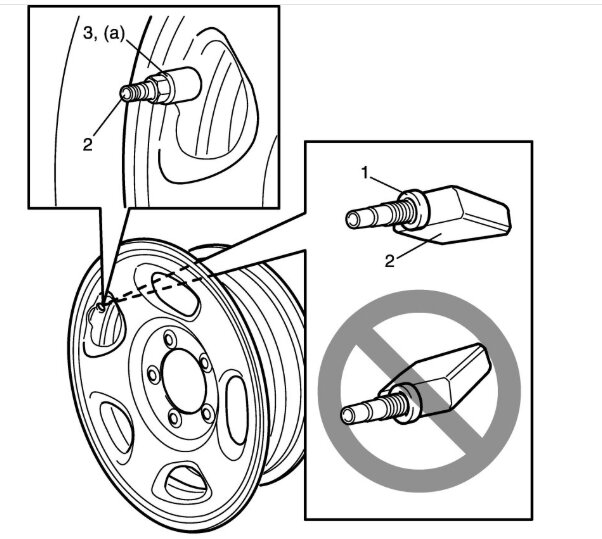

I was robbed in flat house tire place on plain field NJ. Three workers positioned themselves on front and passenger tires and the owner deceptively punctured a tiny hole in a real tire resulting in a flat on highway 22. I wanted to buy a used tire. They scraped the radio magnetic strips off my two front tires. The electronic suspension is not working and says when i turn. The tire lamp is on all the time. I cannot fix it and cannot find online the wheel chips that communicate with the ECU. Can you help?

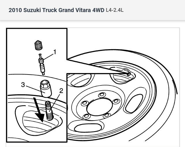

The tire pressure sensor is part of the valve stem on the wheel. The sensor is on the inside of the wheel. To access it, the tire needs to be dismounted. (see pics below)
The OEM part number for the sensor is 4313054J22. Searching for Suzuki 4313054J22 on Google will bring up options.
Let me know if this helps.

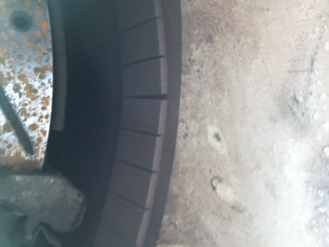

SOPHIE BRUNO
  • 27 POSTS
Hello friends,
I am now attempting to upload photo onl cips hat mak suspension adjust height and stabilize shocks on turns.
Respectfully,
Sophie Bruno.
Jan 19, 2025 at 11:23 AM
  • 54,837 POSTS
Those are wheel weights to help balance the tire, thanks for the image it helped.
