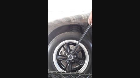

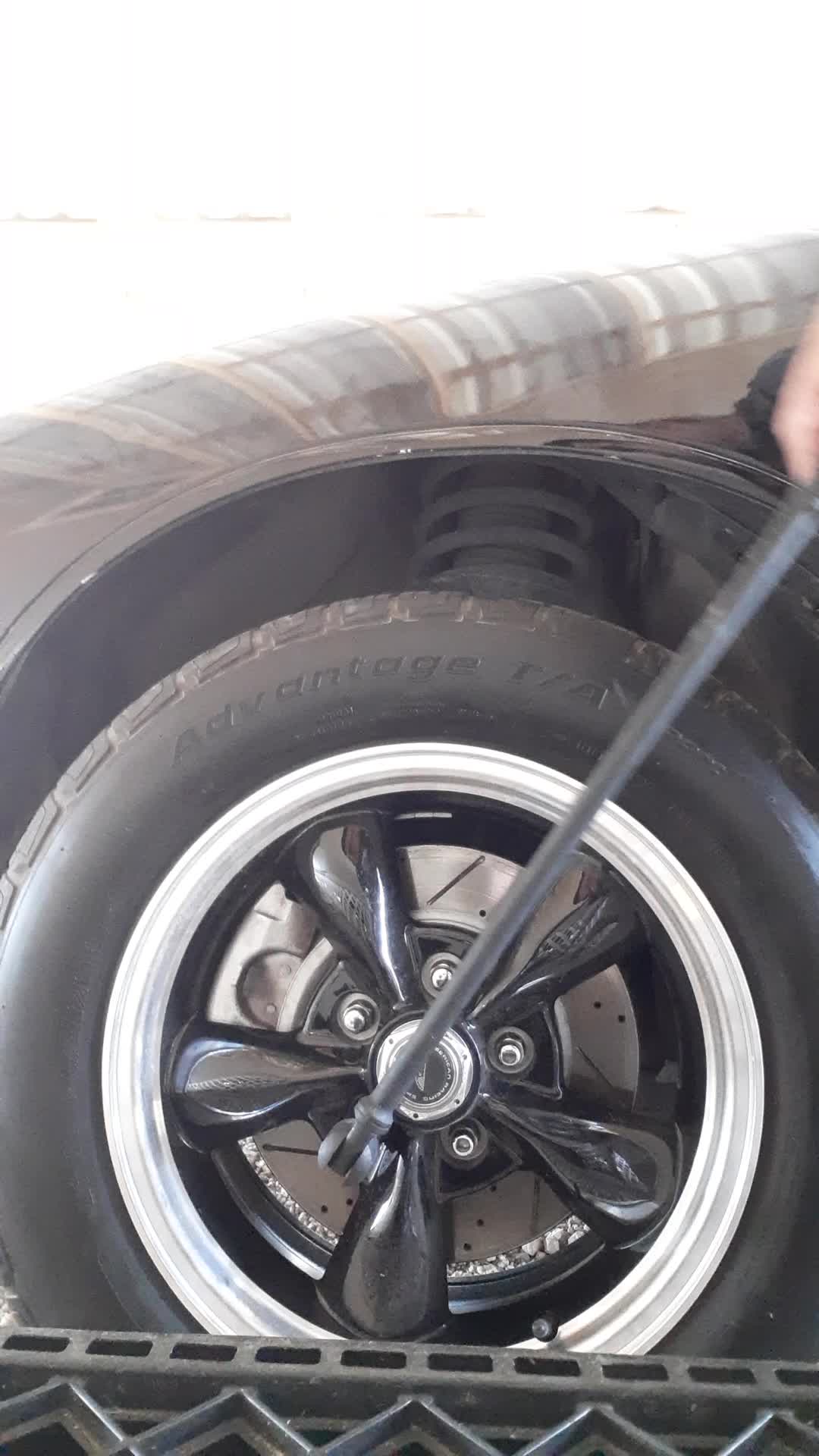

When I was tightening the lug nuts, I could make the wheel move quite a bit with the breaker bar. Is this normal, or what could be the cause?

Does the vehicle drive okay? If so, I suspect that is the movement from the suspension and steering system.
You could have some slack in the tie rods or even a little in the wheel bearing/hub. No matter what, I would suggest putting the front wheels on jack stands and shacking down the front wheels. You do this by putting your hands on the tire at 3 and 9 o'clock as if it were a clock and push and pull with opposite hands. There should be no loose feeling and this is checking the tie rods. Then do the same at 12 and 6 o'clock to check the upper and lower ball joints.
If these are tight then it is normal. Thanks for getting the video. That really helped.

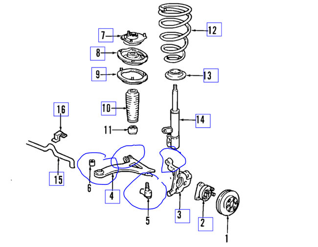

No, that is not normal. You have an issue there.
https://www.2carpros.com/articles/popping-noise
You need to check the ball joints as well as the control arms for movement.
https://www.2carpros.com/articles/how-to-release-a-ball-joint
You need someone to do what you are doing and you go under with a bright flash light and look for the movement.
I attached a blow up of the suspension for you and circled the common areas of wear.
