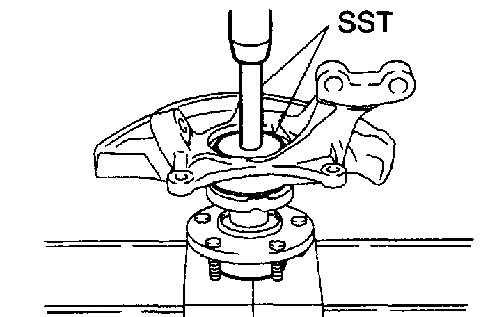

Okay, my vehicle has ABS speed sensor mounting on side on rear knuckle and not on the hub assembly. So there is two differentials, ones a bolt on assembly and a two piece assembly without the ABS plug on them. so which hub do i need, the two piece or the one piece that has four bolts?
Jan 31, 2019 at 2:23 PM
  • 110,248 POSTS
First, I hope I'm answering this correctly. You mention rear and then knuckle which is on the front. So I think you are referring to the front ABS sensor on the rear of the steering knuckle. If that is wrong, please let me know. Also, the hub bearing is a pressed in bearing on this vehicle. It isn't a hub bearing assembly that bolts on.
So, there is only one type of hub assembly for this vehicle. The sensor bolts to the rear of the steering knuckle. The sensor has a non removable wire attached to it that plugs in to the vehicle's wiring harness. The sensor itself is removable from the steering knuckle.

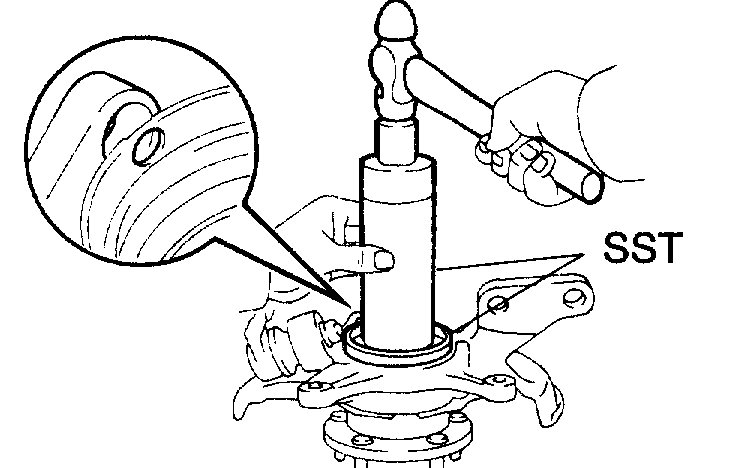

With that in mind, here are directions for replacing the hub assembly. The attached pictures correlate with these directions.

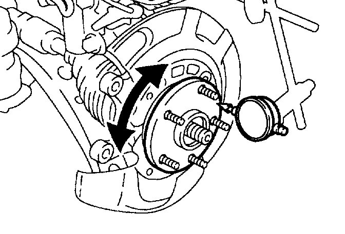

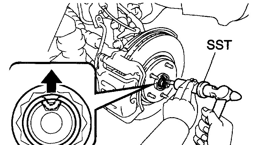

2. REMOVE FRONT AXLE HUB LH NUT
a. Using SST and a hammer, unstake the staked part of the lock nut.
SST 09930-00010
b. While applying the brakes, remove the lock nut.

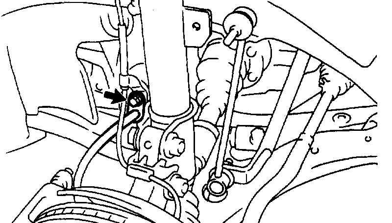

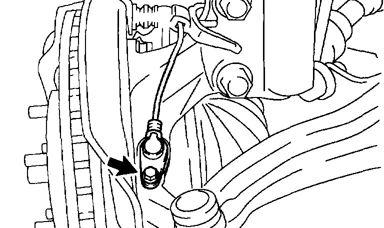

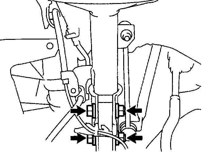

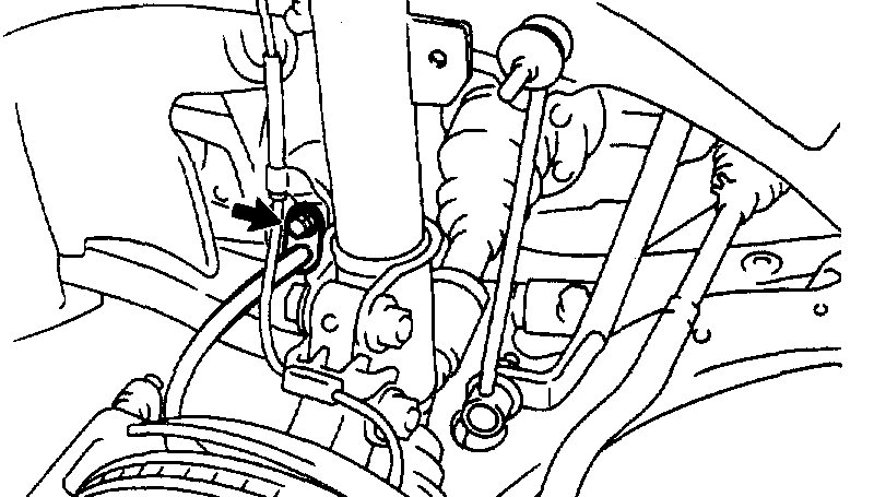

3. SEPARATE SPEED SENSOR FRONT LH
Picture 2
a. Remove the bolt, separate the sensor wire and flexible hose from the shock absorber.
Picture 3

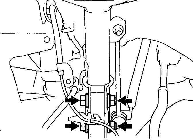

b. Remove the bolt and separate the speed sensor from the steering knuckle.

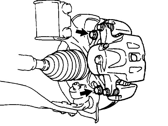

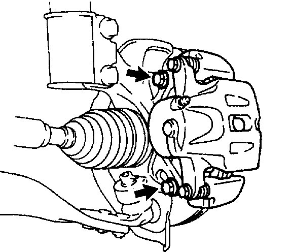

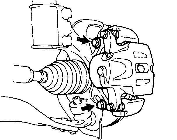

4. SEPARATE FRONT DISC BRAKE CALIPER ASSY LH
a. Remove the 2 bolts, separate the brake caliper from the drive shaft.

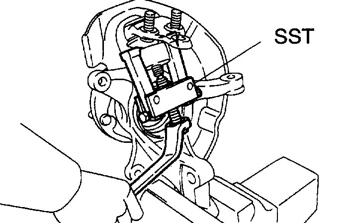

5. REMOVE FRONT DISC
Picture 5

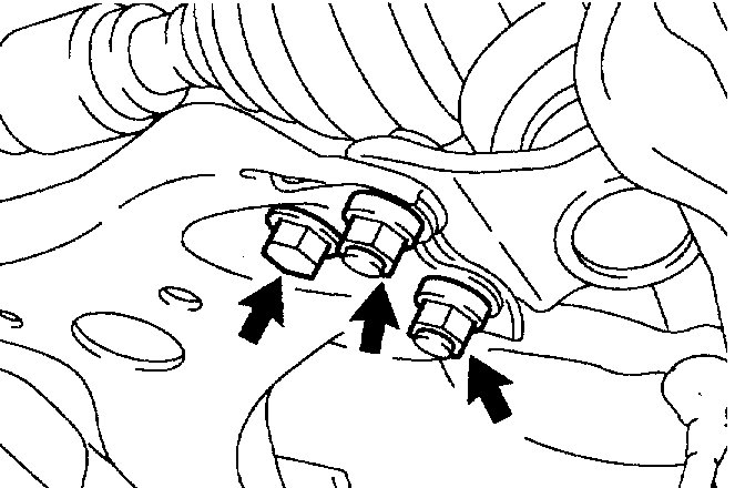

7. SEPARATE FRONT SUSPENSION ARM SUB-ASSY LOWER NO. 1 LH
a. Remove the bolt and 2 nuts, and separate the lower suspension arm from the lower ball joint.
8. REMOVE FRONT AXLE ASSY LH
a. Using a plastic hammer, separate the drive shaft from the axle hub.
NOTICE: Be careful not to damage the boot and ABS speed sensor rotor.
b. Remove the 2 bolts, nuts and steering knuckle with the axle hub.

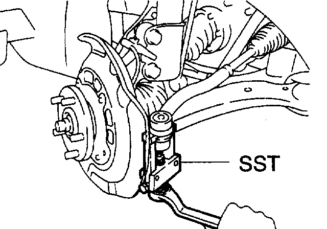

9. REMOVE LOWER BALL JOINT ASSY FRONT LH
Picture 7
a. Remove the cotter pin and nut.
Picture 8
b. Using SST, remove the ball joint.
SST 09628-62011

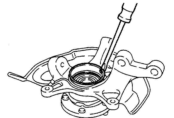

10. REMOVE FRONT WHEEL BEARING DUST DEFLECTOR NO. 1 LH
a. Using a screwdriver, remove the dust deflector.
Picture 10

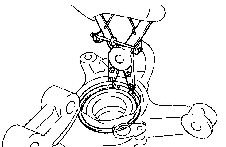

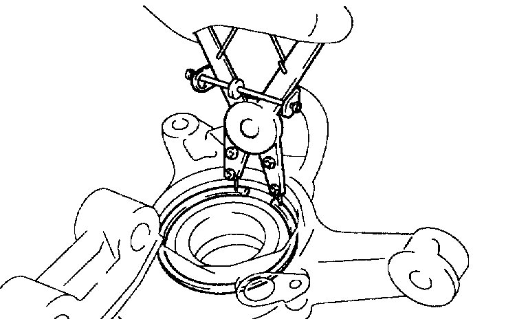

11. REMOVE FRONT AXLE HUB LH HOLE SNAP RING
a. Using a snap ring plier, remove the snap ring.

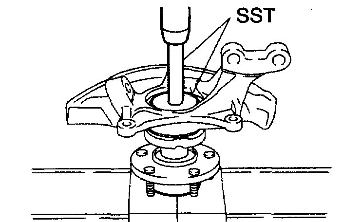

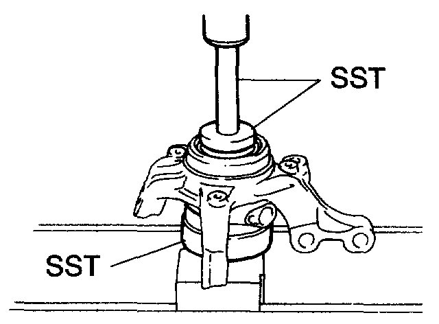

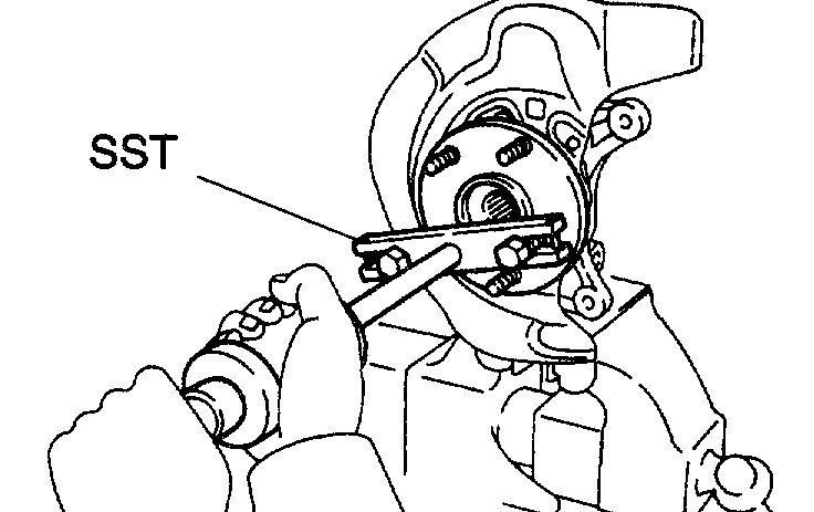

12. REMOVE FRONT AXLE HUB SUB-ASSY LH
Picture 11
a. Using SST, remove the axle hub.
SST 09520-00031

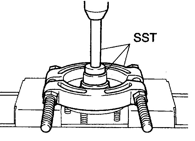

Picture 12
b. Using SST and a press, remove the inner race (outside) from the axle hub.
SST 09950-00020, 09950-60010 (09951-00410), 09950-70010 (09951-07100)

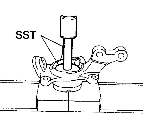

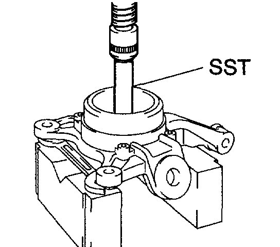

14. REMOVE FRONT AXLE HUB LH BEARING
a. Place the inner race (outside) on the bearing.
Picture 13
b. Using SST and a press, press the bearing until it contacts with the SST.
SST 09527-17011, 09950-60010 (09951-00600), 09950-70010 (09951-07100)
Picture 14
c. Using a spanner to make the steering knuckle horizontal, fix it to the V block as shown in the illustration.
NOTICE: Be sure the steering knuckle is horizontally positioned.
d. Using SST and a press, remove the bearing.
SST 09950-60010 (09951-00600), 09950-70010 (09951-07100)

17. INSTALL FRONT AXLE HUB SUB-ASSY LH
a. Using SST and a press, install the axle hub.
SST 09608-32010, 09950-60020 (09951-00680), 09950-70010 (09951-07100)
Picture 17

22. INSTALL FRONT SUSPENSION ARM SUB-ASSY LOWER NO. 1 LH
a. Connect the lower arm and ball joint with the 2 nuts and bolt.
Torque: 127 Nm (1,300 kgf-cm, 94 ft. lbs.)

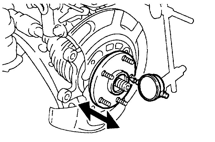

29. INSPECT BEARING BACKLASH
a. Using a dial indicator, check the backlash near the center of the axle hub.
Maximum: 0.05 mm (0.0020 inch)
If the backlash exceeds the maximum, replace the bearing.
