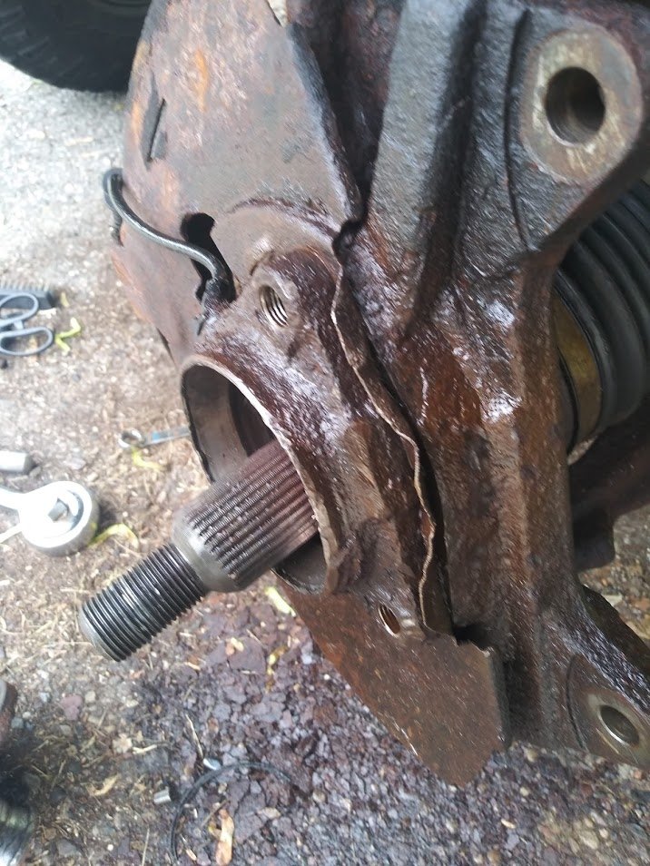

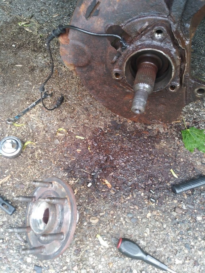

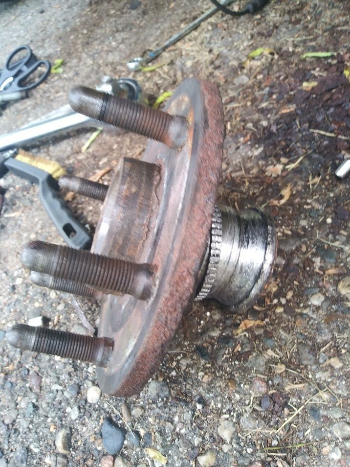

So I was working on my truck today replacing the driver side wheel hub, upon removing the brake caliper and rotor I find the wheel hub had broken in half (see attached pictures). The hub part that bolts to the knuckle is rusted and or seized on and I can't get it off. any ideas? I tried heat, a screwdriver and hammer, sledge. Nothing seems to work. Thank you.

You will need an air hammer and a lot of patience. That part of the bearing seizes into the hub and takes a while to get it out. The air hammer provides enough power to work it loose and remove it.
You will need an air compressor, air hose and a good quality air hammer with a good chisel bit.

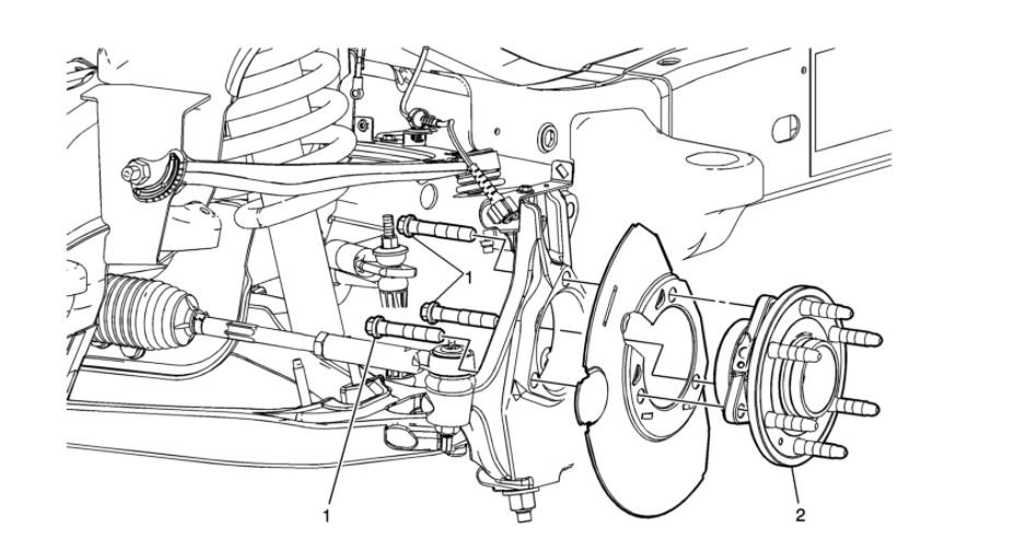

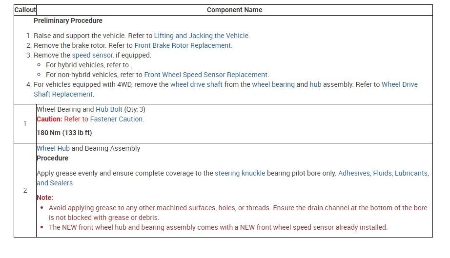

I also attached the procedure and a picture for you as well.
https://www.2carpros.com/articles/bearing-hub-replacement
