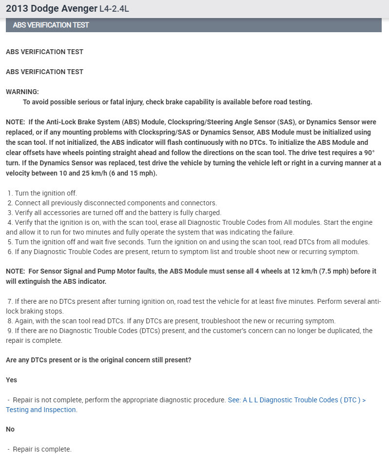

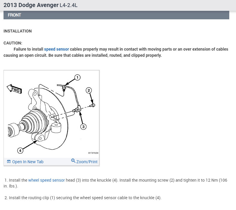

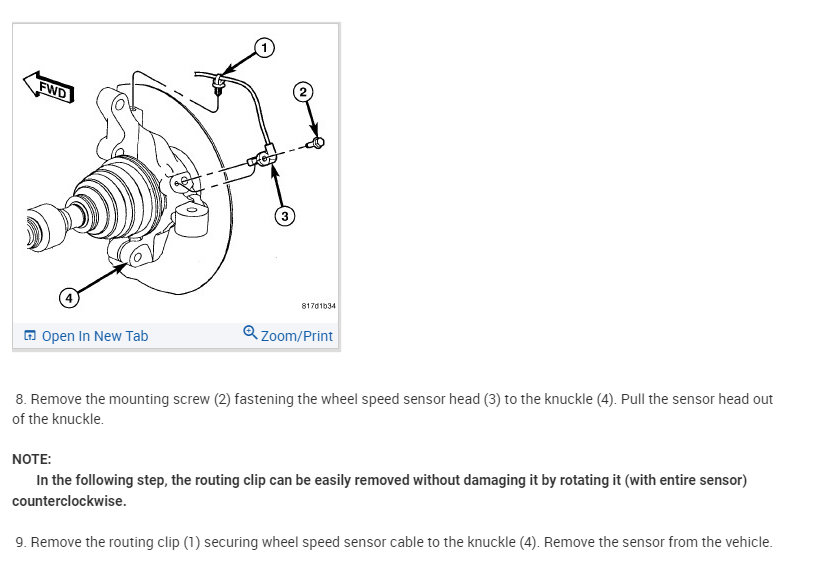

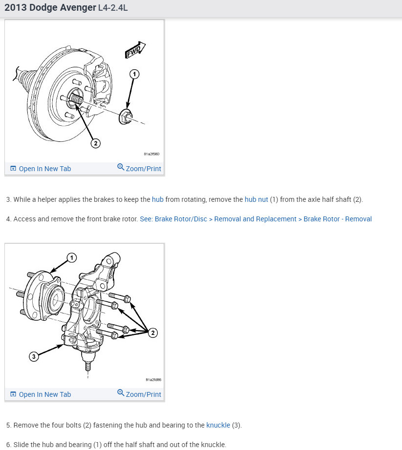

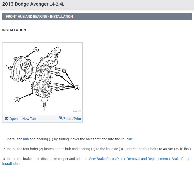

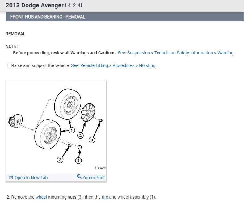

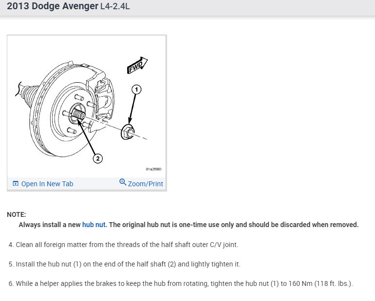

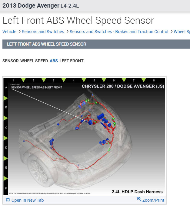

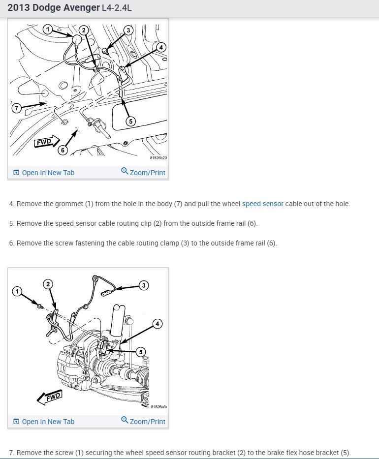

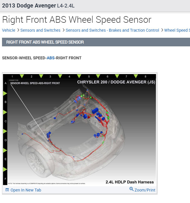

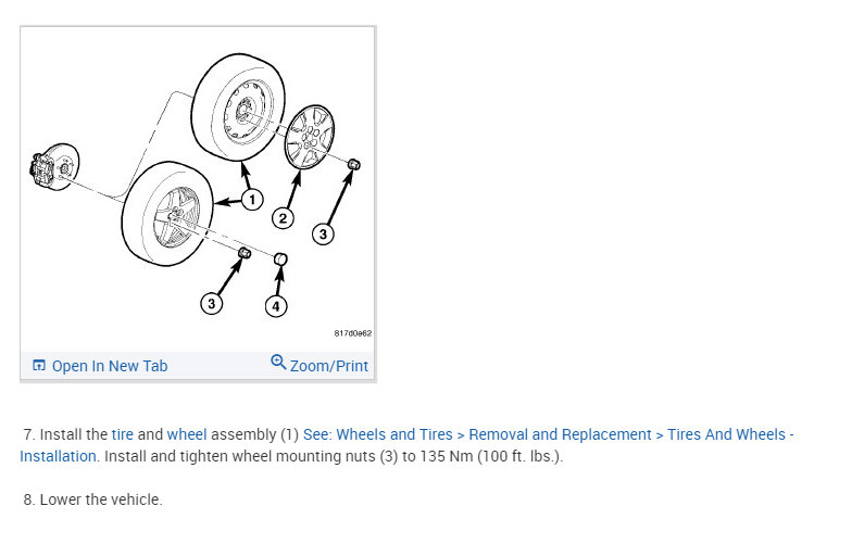

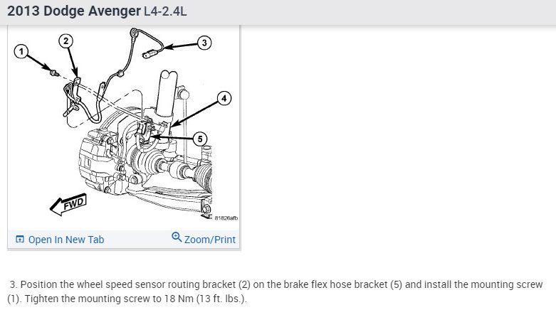

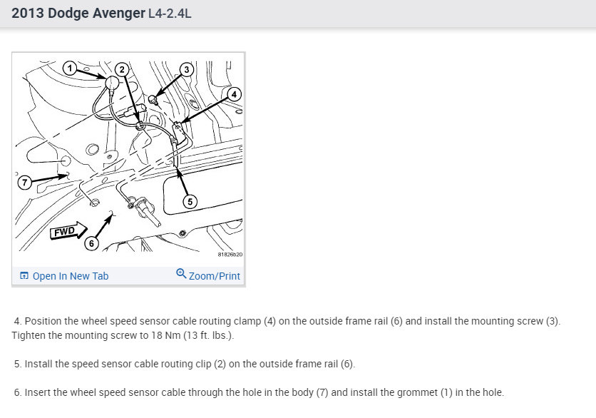

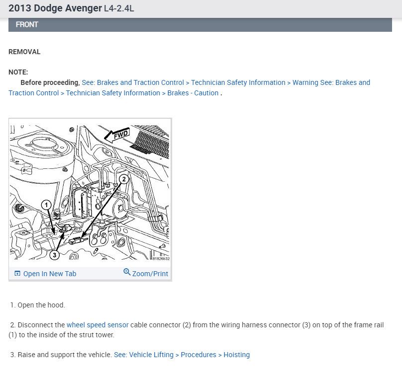

A friend of mine wants me to change his wheel hub assembly and speed sensor on his vehicle listed above, SE is there any way I can receive some schematics, so I know what I'm looking at. I've done this before on other vehicles but never worked on this make and model before.
Feb 16, 2022 at 3:24 AM
SQM
  • 6,383 POSTS
The hub assembly can be replaced using basic hand tools. It will make it easier to use an impact to remove the axle nut as it usually requires a good amount of force to remove.
Here is a helpful guide:
https://www.2carpros.com/articles/bearing-hub-replacement

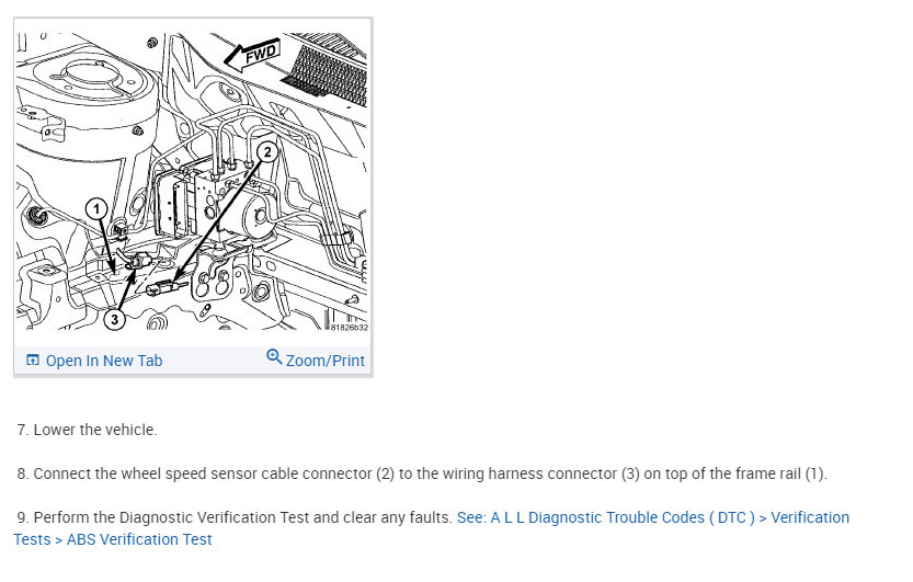

Also after replacing the wheel speed sensor, it does require to perform a verification test to make sure the sensor is functional.
I have attached below the complete replacement procedure of the hub assembly as well as the wheel speed sensor below. I have also included the ABS verification test procedure as well.
