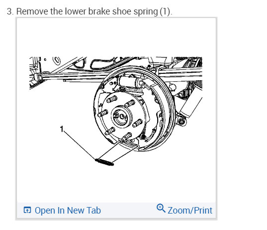

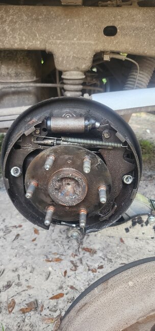

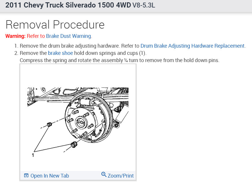

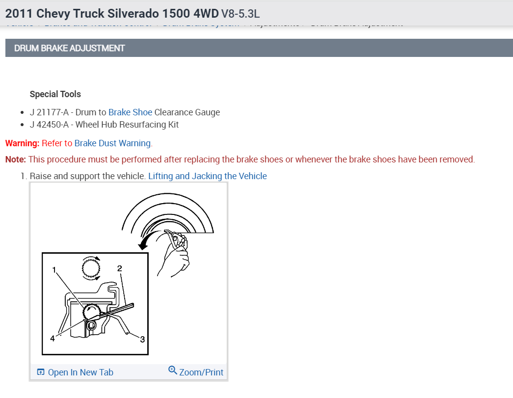

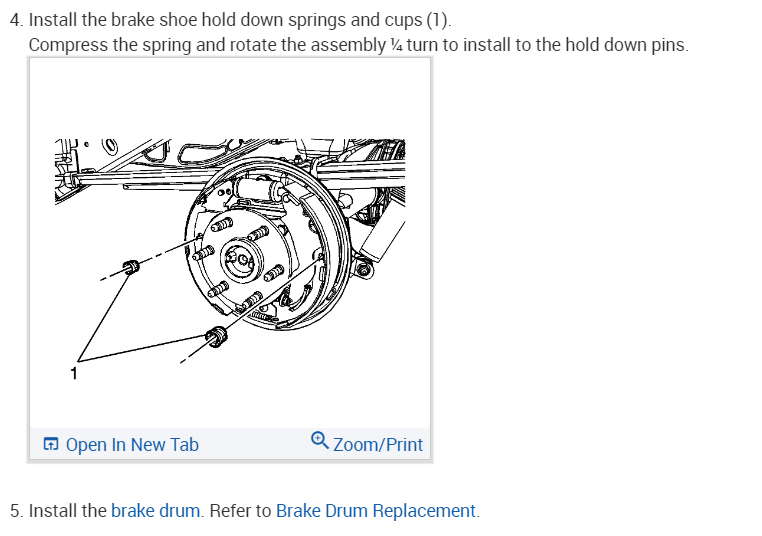

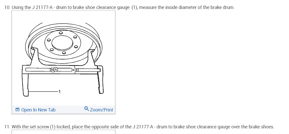

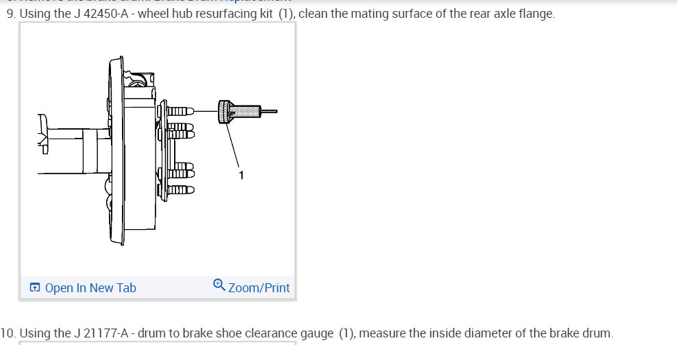

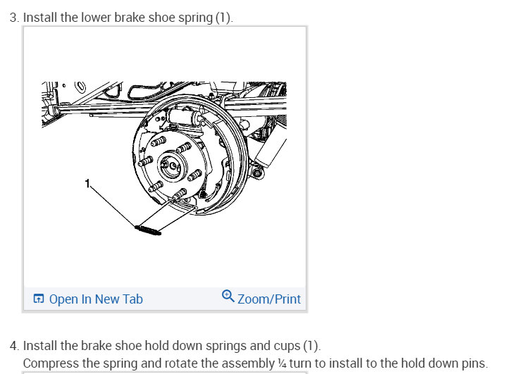

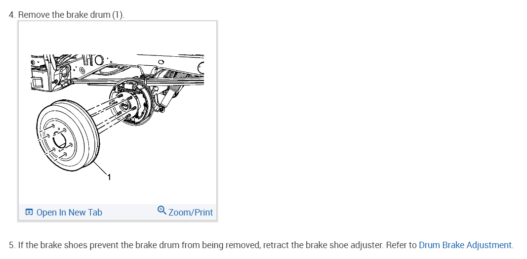

The wheel cylinder in my truck listed above continues to pop out and I don't know why. I added some pictures. Any suggestions?

Image never loaded, so here it is.

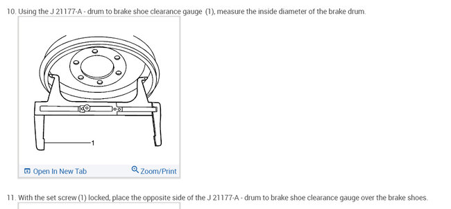

Thanks for the image. I would replace the rear brake shoes and drums; this happens because they are out of spec.
Here are the shoes for $49.00:
https://amzn.to/3KP7cfs
And the drums for $59.00:
https://amzn.to/45A3aj5

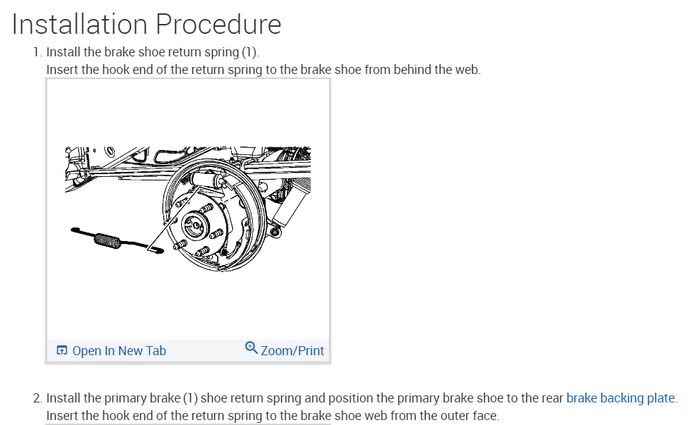

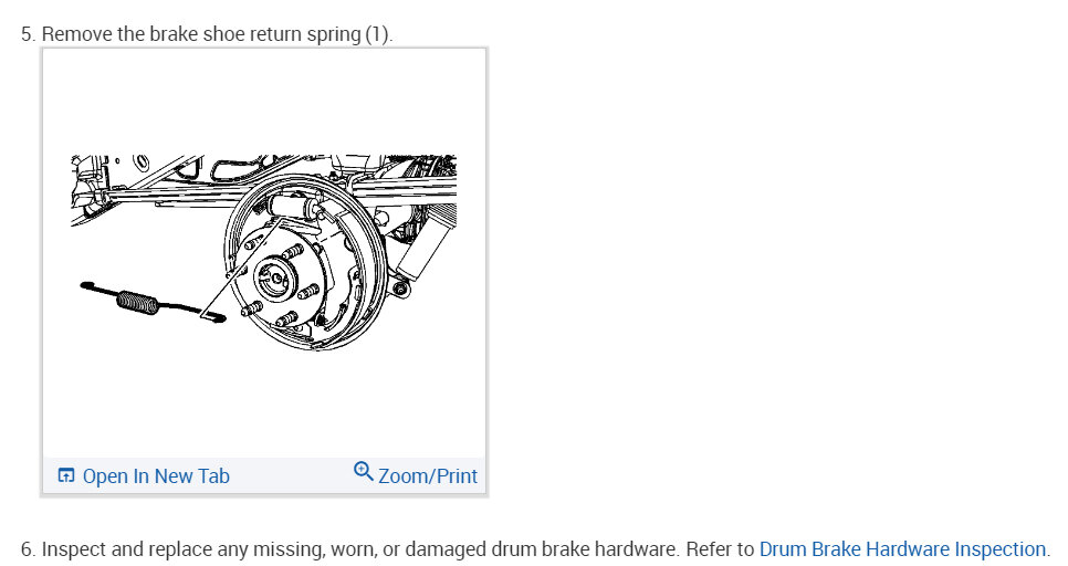

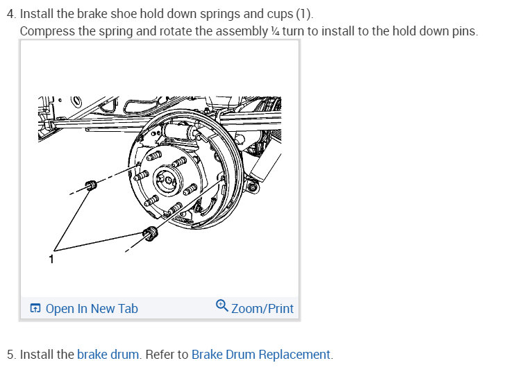

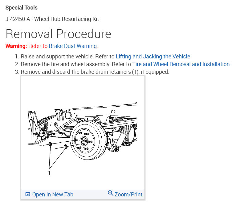

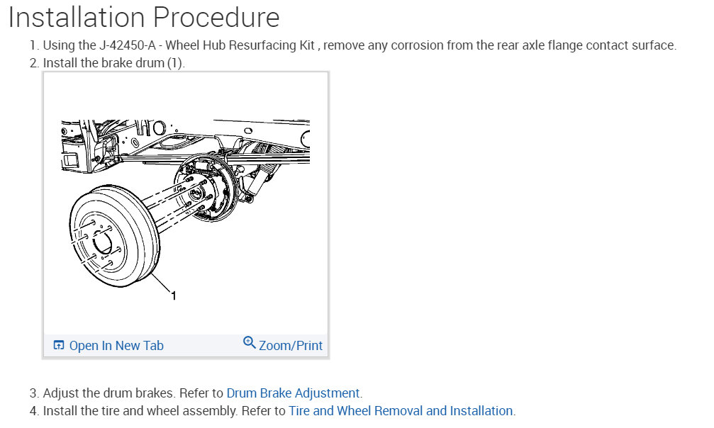

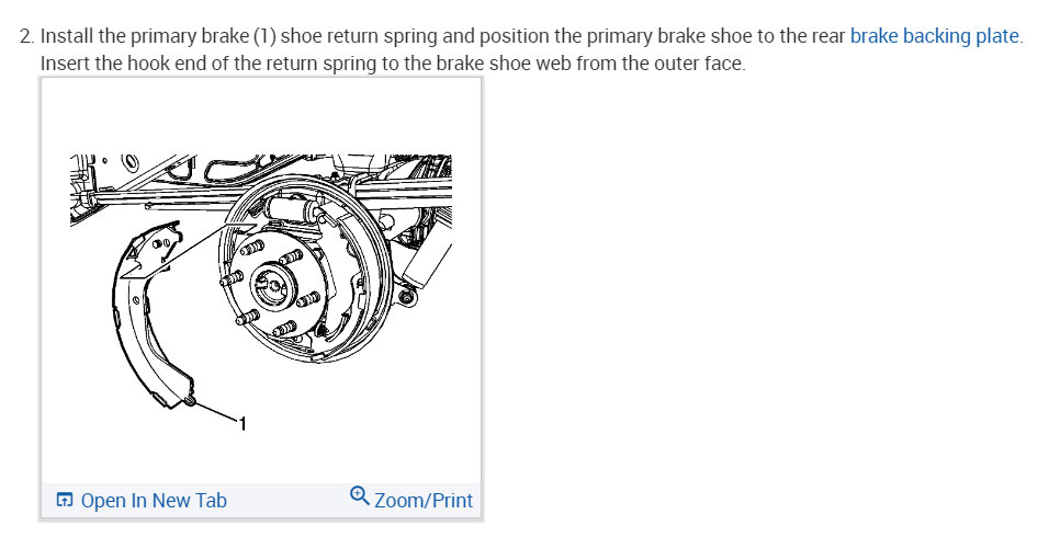

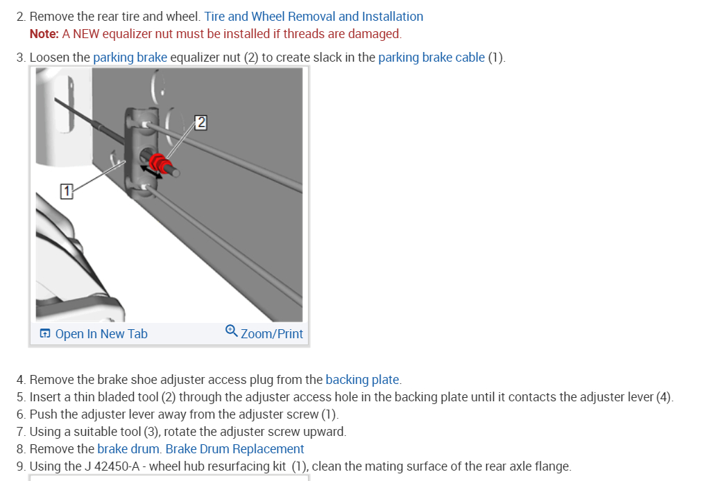

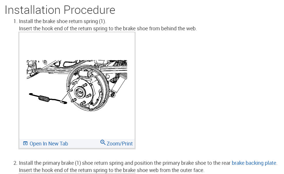

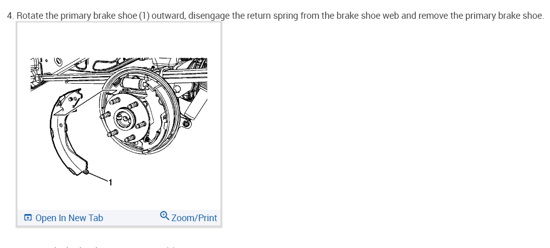

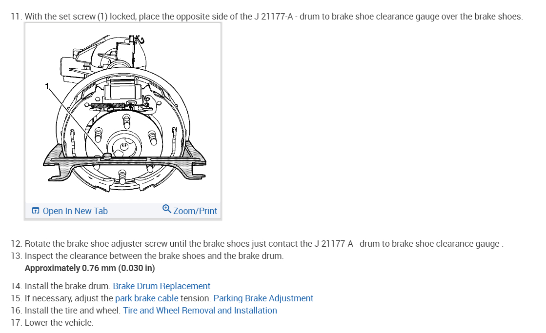

Here is a generic guide to help you step by step with instructions in the diagrams below to show you how on your car:
https://www.2carpros.com/articles/how-to-replace-rear-brake-shoes-and-drums
Check out the images (below). Please let us know if you need anything else to get the problem fixed.

Thank you for replying, but that's a bigger problem because those are new brakes, I put on a month ago and everything I did matches the guide.

You may have the incorrect wheel cylinder installed? If the shoes and drums are new this is the only thing I can think of.
