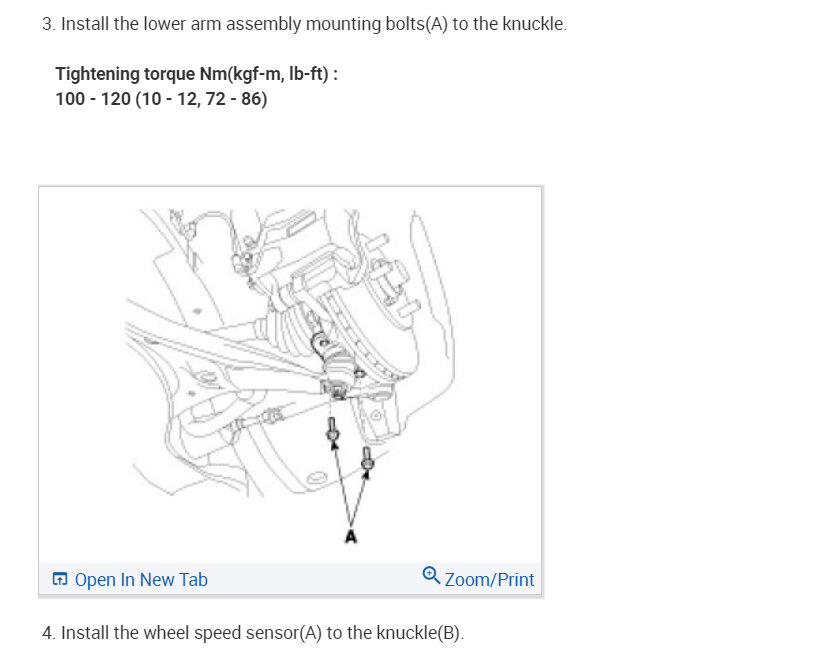

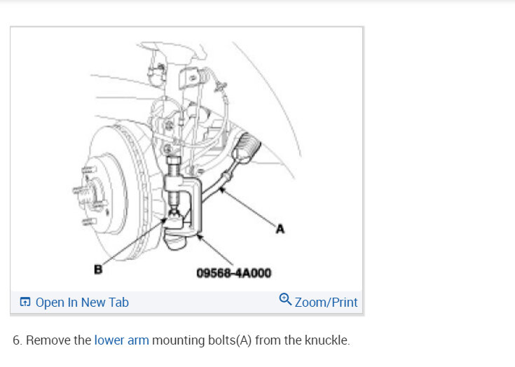

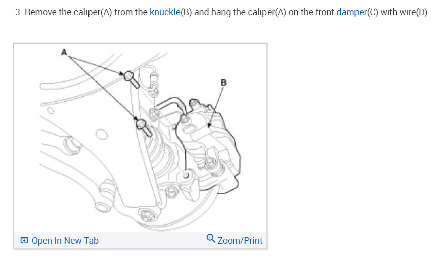

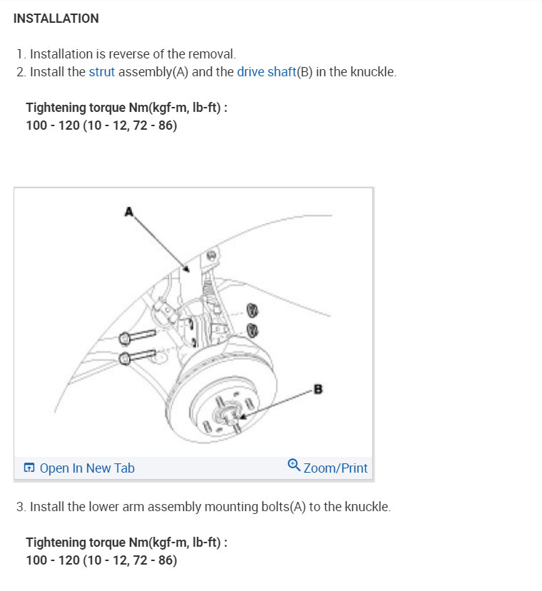

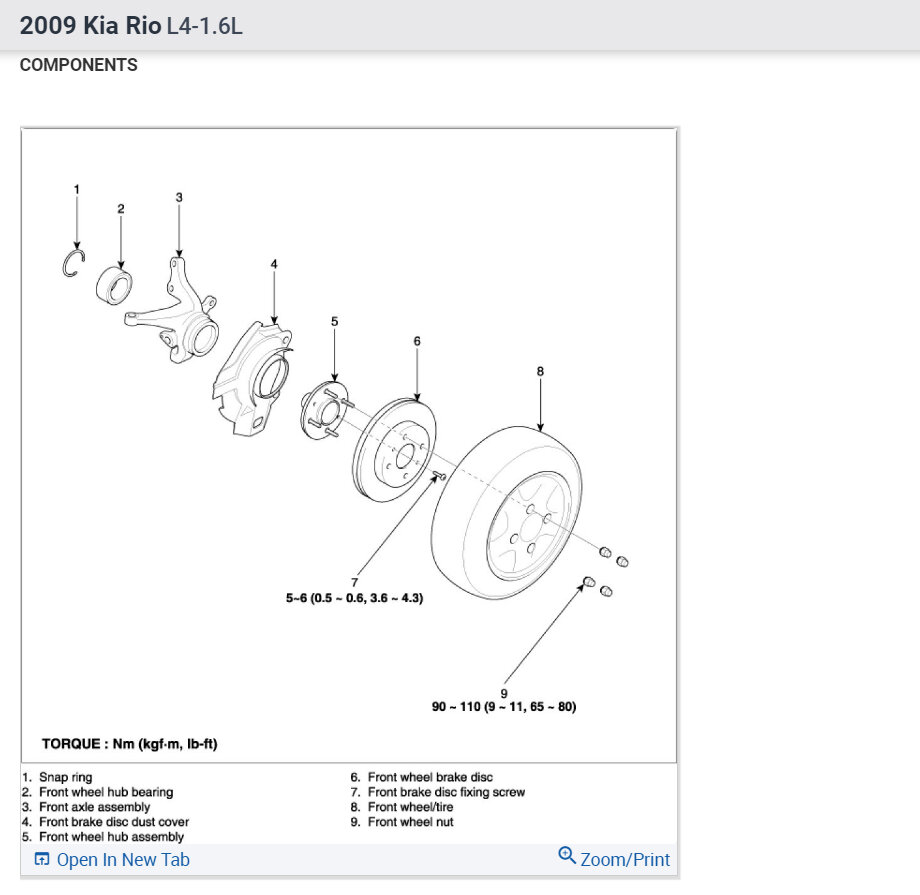

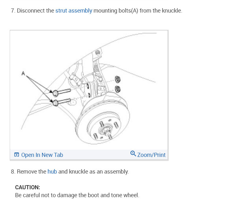

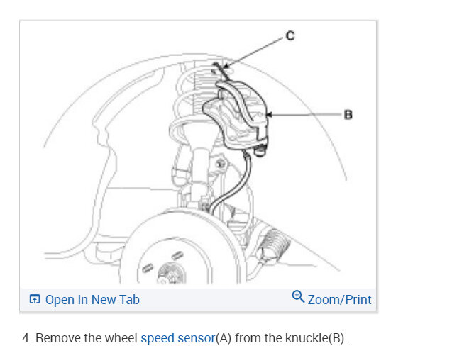

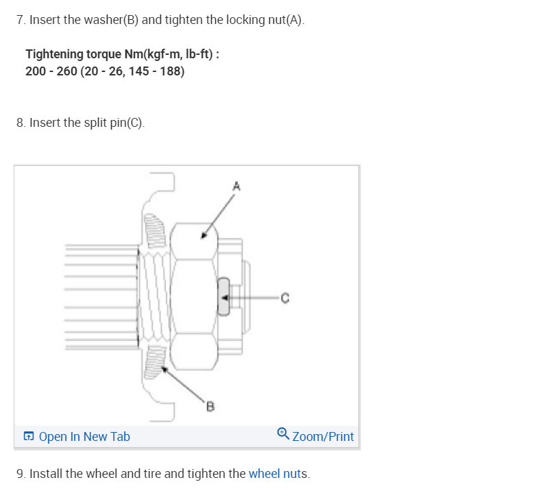

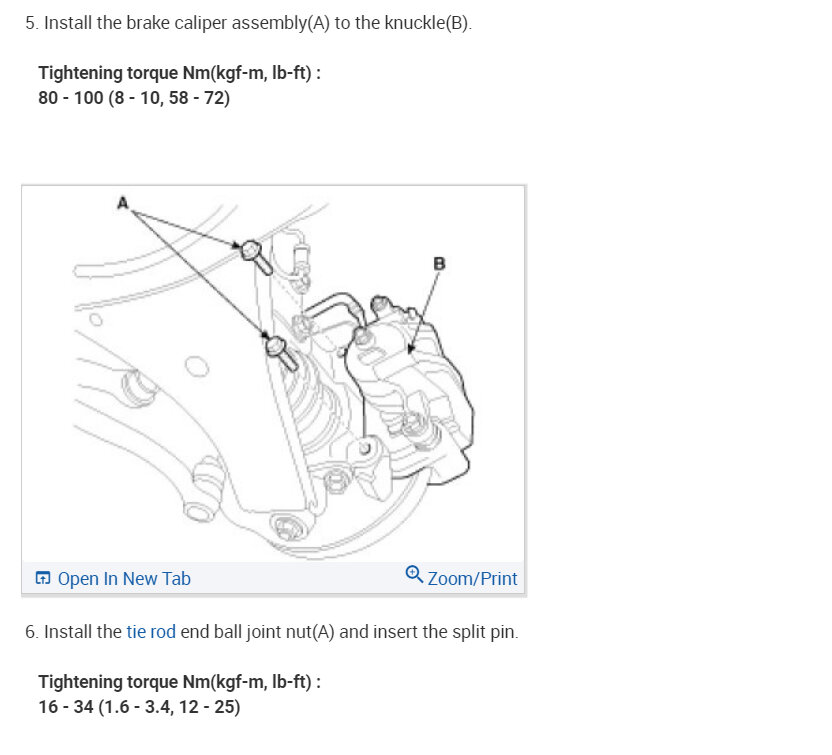

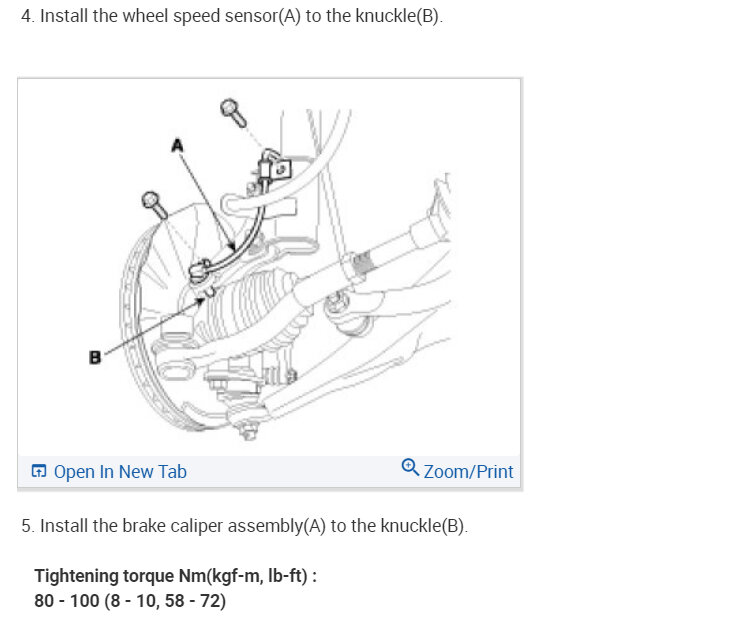

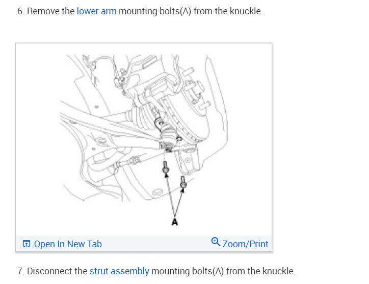

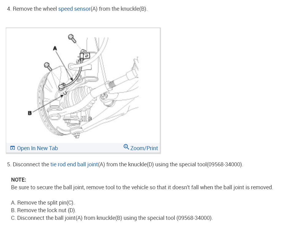

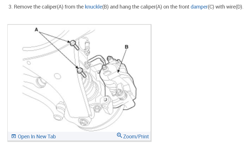

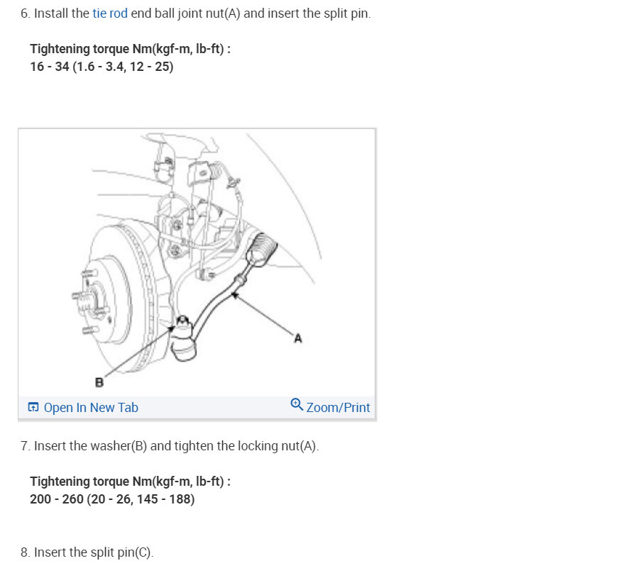

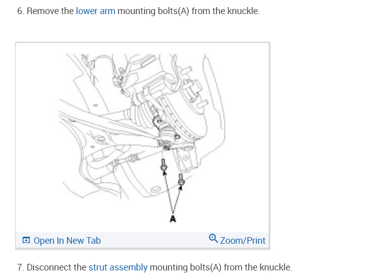

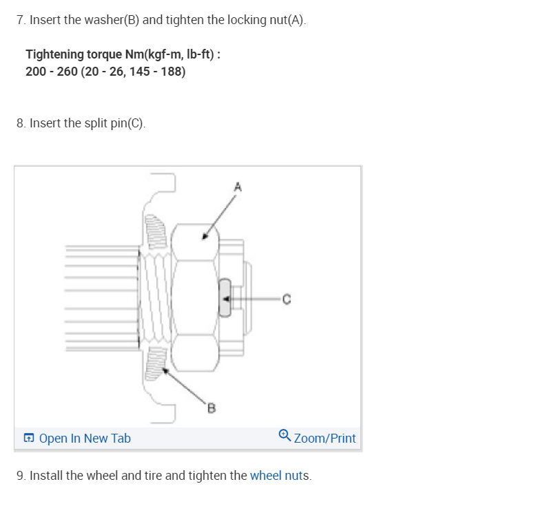

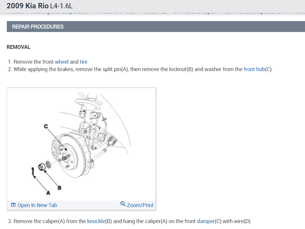

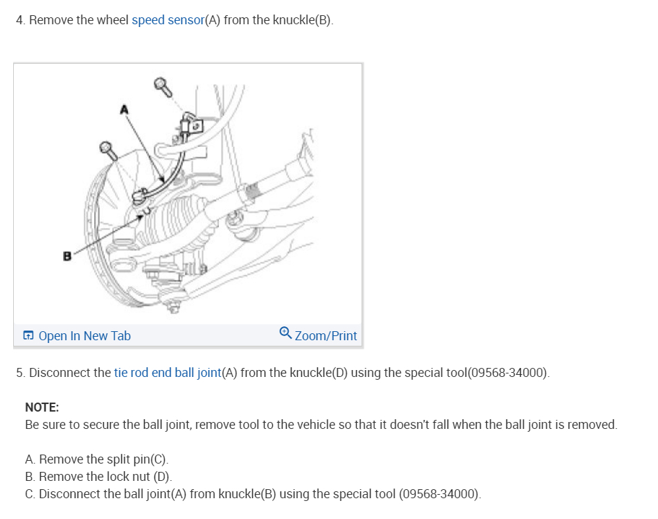

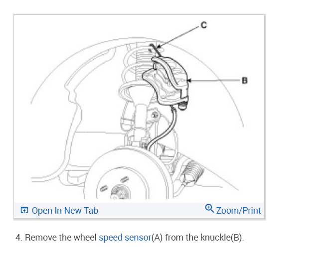

My son changed my wheel bearing on front driver's side do they need to be pressed? What exactly does that mean? It's making kind of a whirling noise now?
May 6, 2023 at 7:27 AM
  • 55,249 POSTS

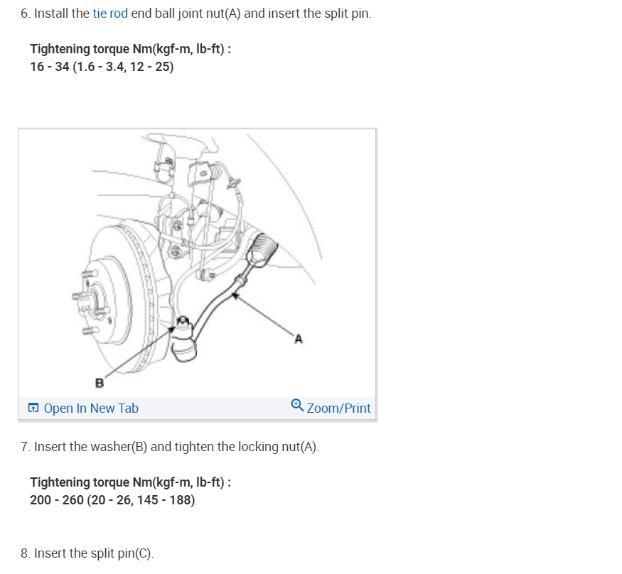

Yep, this is common, here is a video of the job being done on a similar car so you can see what he is talking about also I have included the instructions for your car in the images below.
