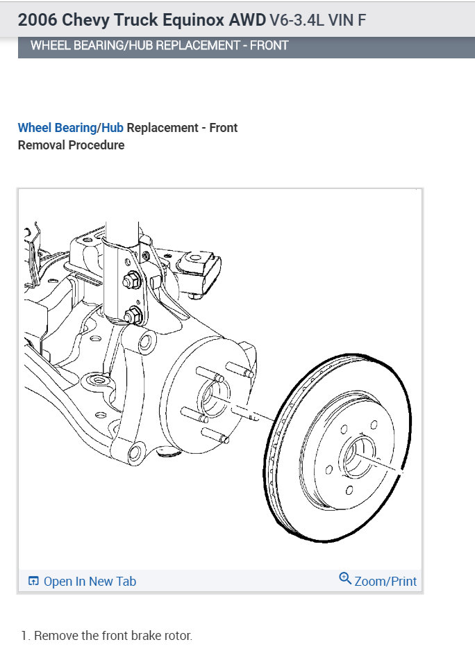

Everything from bolts to the hub bearing are stuck. they have so much rust build on that not only am I having a hard time with the bolts but the bearing is also stuck. I haven't been able to get them off and is stressing. Can someone give me a trick to take them off please?

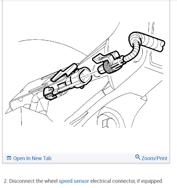

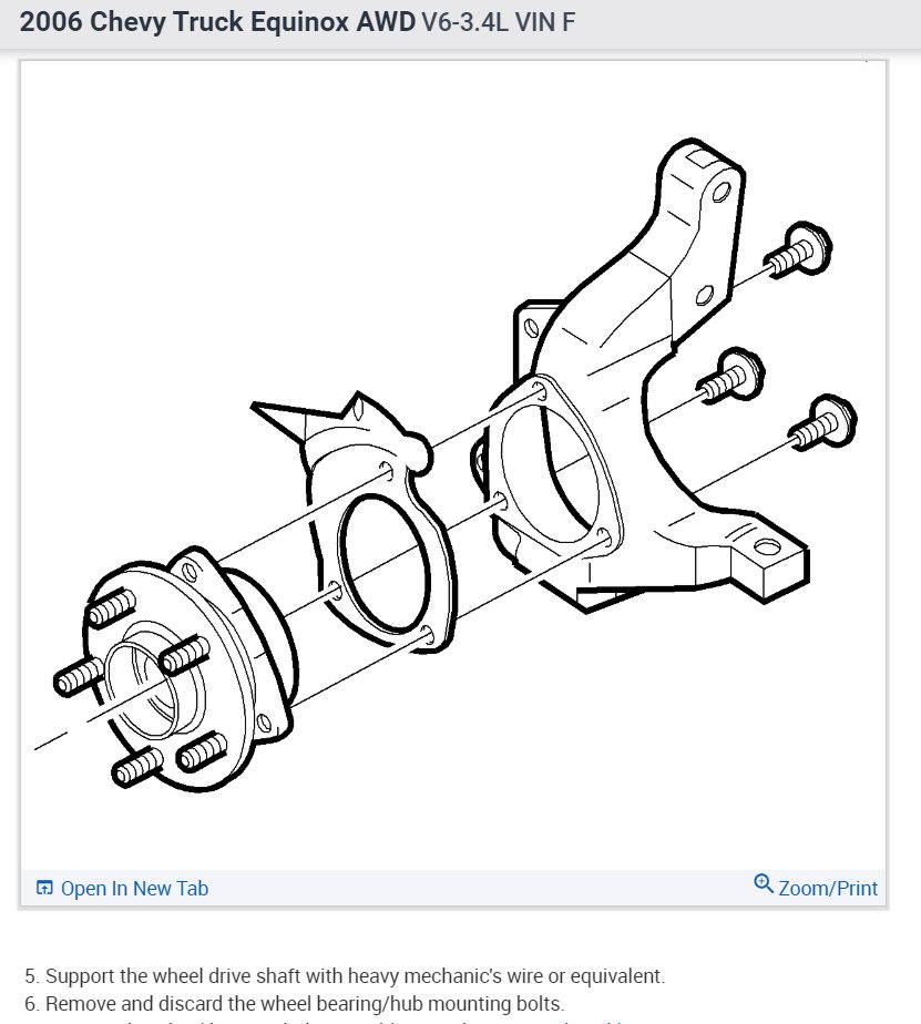

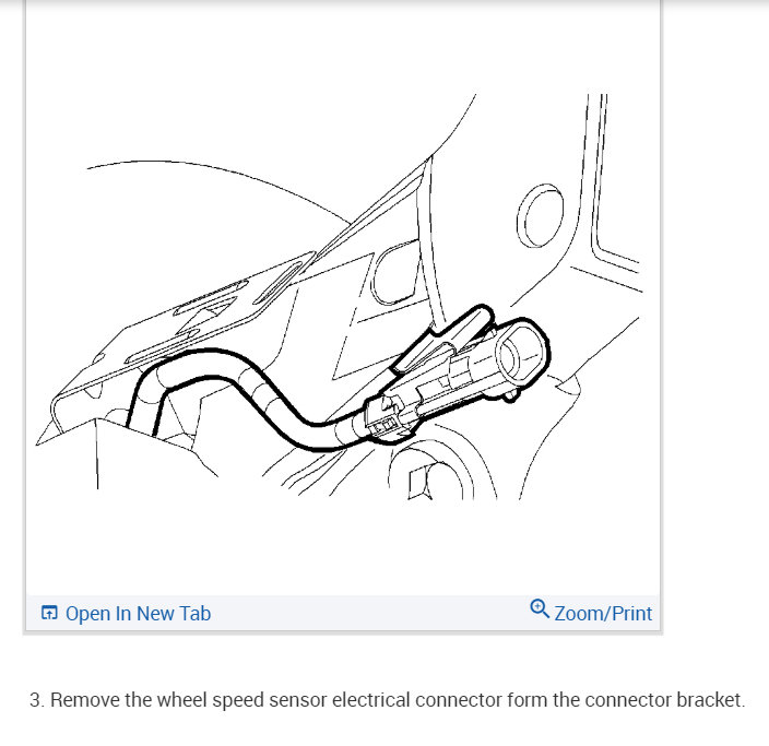

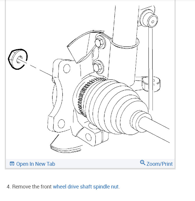

Here is how the job is done correctly in the diagrams below. Please let us know if you need anything else to get the problem fixed.
