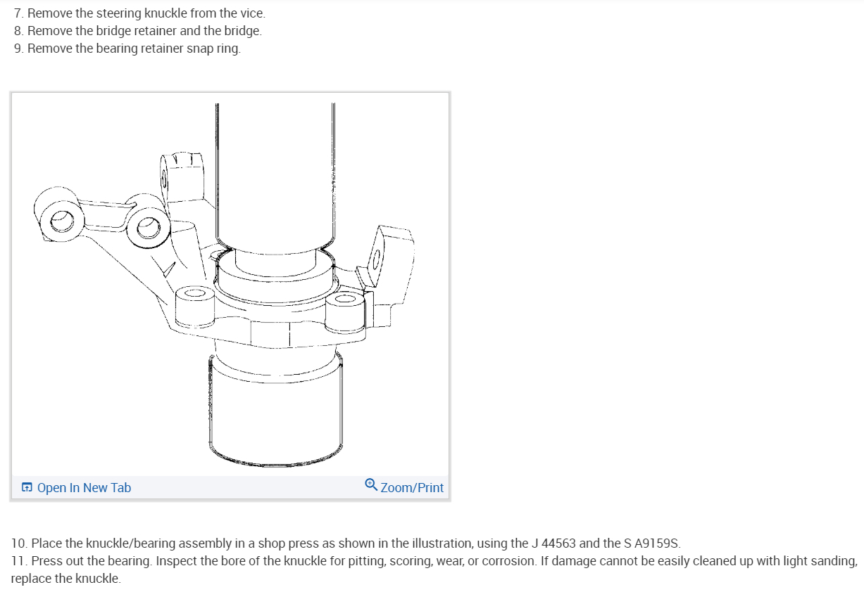

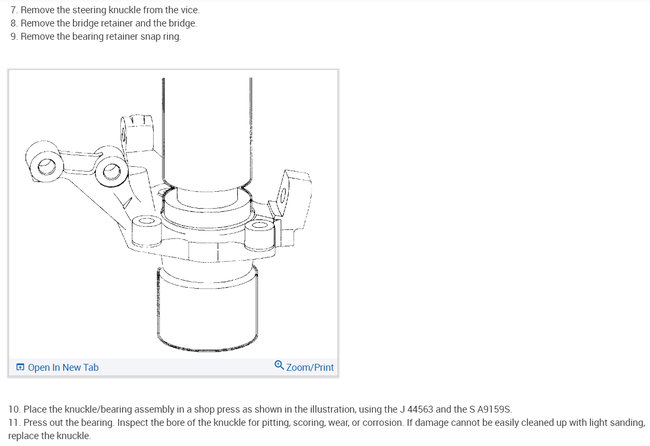

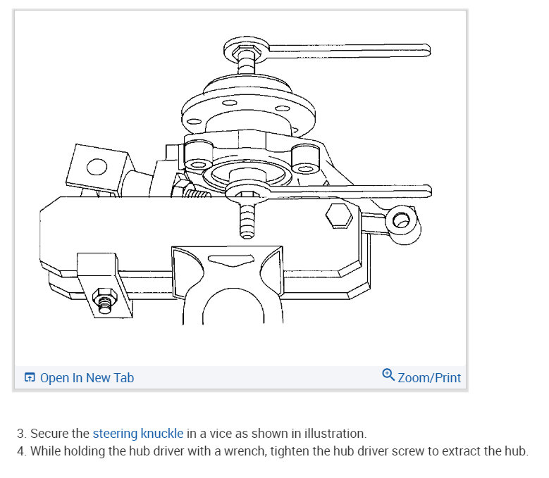

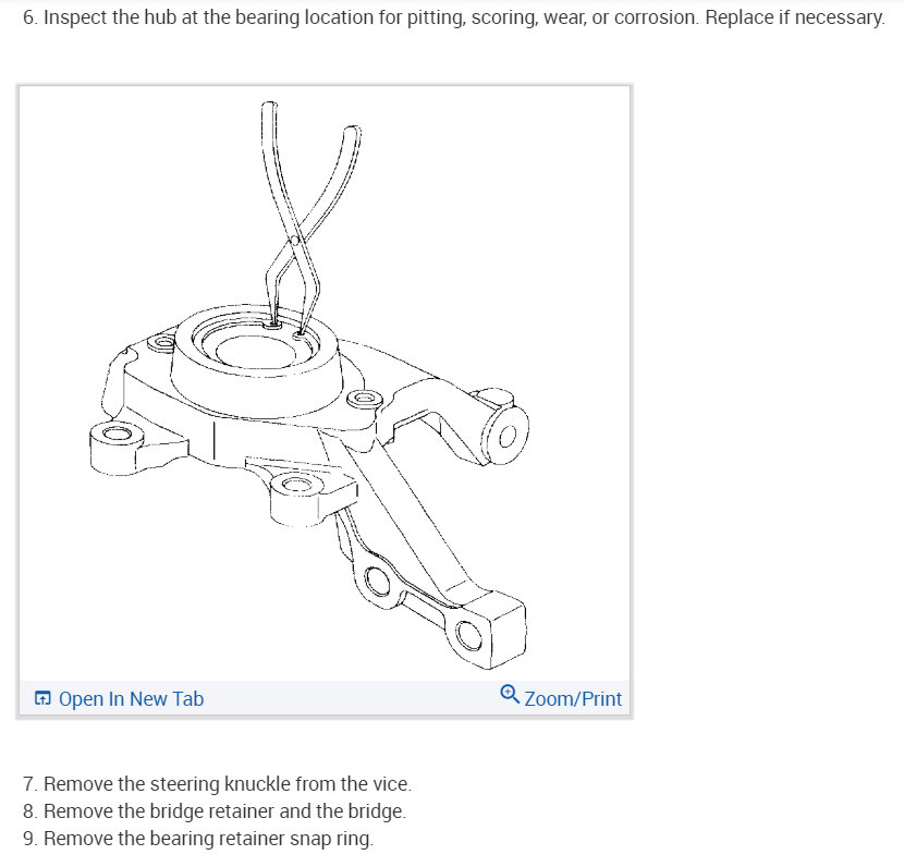

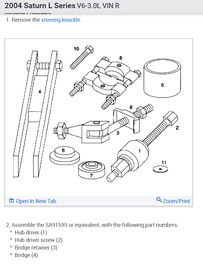

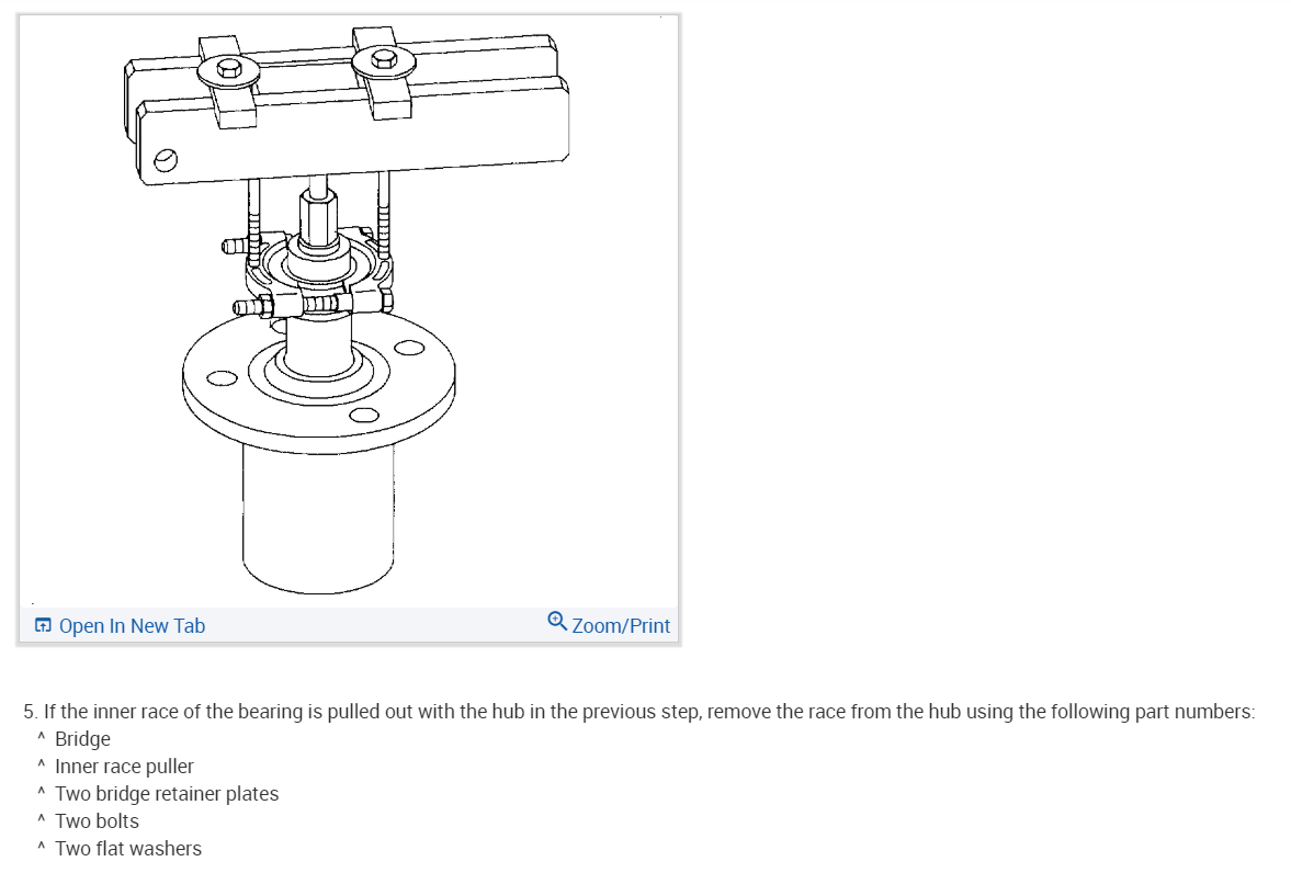

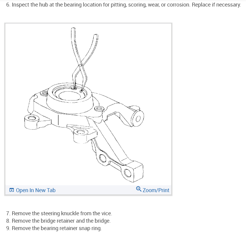

Hello I am trying to replace my drivers wheel bearing.I have the new hub n bearing already.can you tell me if the new bearing will havecto be pressed into the knuckle or not. I hope not anyways. I would appreciate your help thank you ahead of time Sincerely Richard
Jun 25, 2019 at 5:48 AM
  • 55,433 POSTS
It is the press type. here is a video of the job being done on a similar car (rear) which is the same as the front with diagrams below to show you how on your car:
https://youtu.be/_FzmmBoa4Tg
