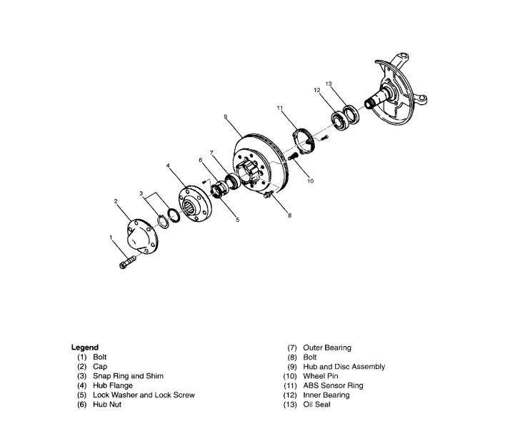

I need to replace rotors and wheel bearings.
Oct 19, 2019 at 10:39 AM
Hello again.

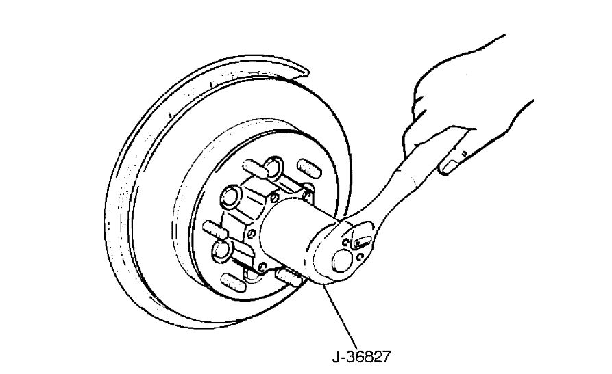

Now we are on the right track.
I posted the procedure below and pictures are attached.
DISASSEMBLY
1. Before disassembly, select the 2WD position with the 4WD switch.
2. Jack up the front of vehicle and support frame with jack stands.
3. Remove the disc brake caliper assembly and hang it on the frame with wires.
4. Remove bolt.
5. Remove cap.
6. Remove snap ring and shim.
7. Remove hub flange.
8. Remove lock washer and lock screw.
9. Use wrench J-36827, remove hub nut.
10. Remove hub and disc assembly.
11. Remove ABS sensor ring.
12. Remove outer bearing.
13. Remove oil seal.
14. Remove inner bearing.

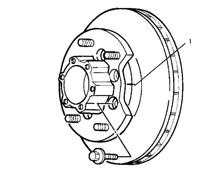

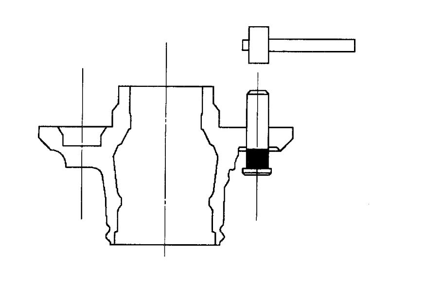

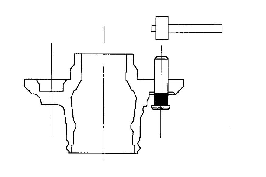

15. Remove bolt, if necessary, replace the wheel pin in the following manner.
- Apply a scribe mark (1) to disc to hub.
- Clamp the hub and disc assembly in a vise, using protective pads. Remove the 6 disc-to-hub retaining bolts.

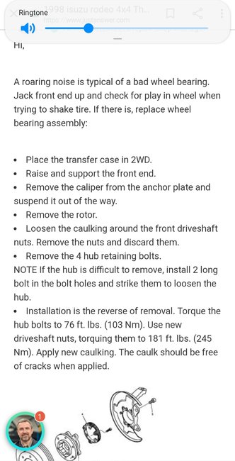

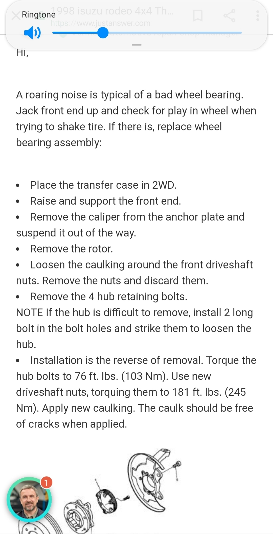

The one I have is.
Oct 19, 2019 at 1:31 PM
BRANDON MARTIN
  • 21 POSTS
It says something about losing caulking.
Oct 19, 2019 at 1:32 PM
That is the grease for the bearing in the hub.
Oct 19, 2019 at 1:49 PM
BRANDON MARTIN
  • 21 POSTS
It got me very confused because I was thinking caulking is not for this.
Oct 19, 2019 at 1:53 PM
Correct.
