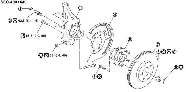

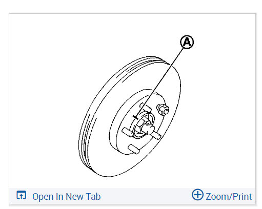

I'm hearing a rumble on my front driver-side wheel and wondered if there were any diagrams or advice to swap the bearing out.

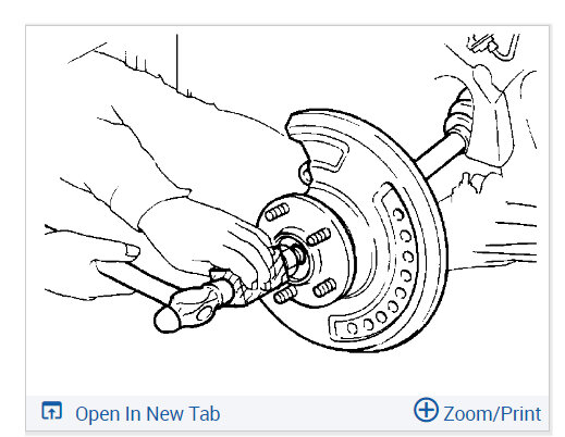

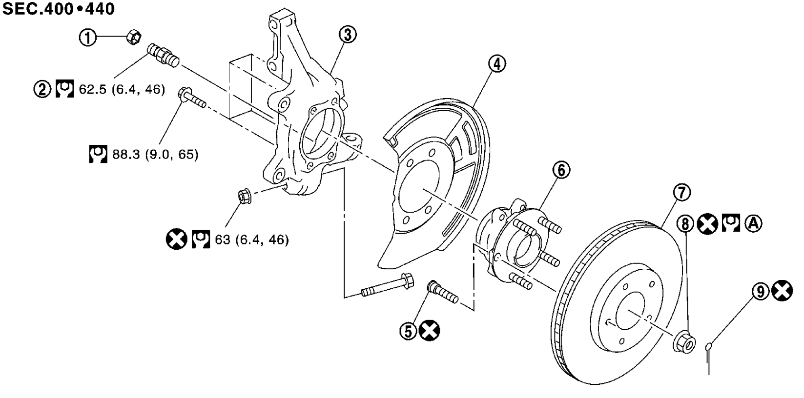

Sure, here is how to change out the bearing hub with torque specs. Please check out the images below as well. Instead of using a special tool to help undo the CV axle nut just leave the car on the ground and then loosen the nut and raise the car after that.
FRONT WHEEL HUB AND KNUCKLE
Removal and Installation

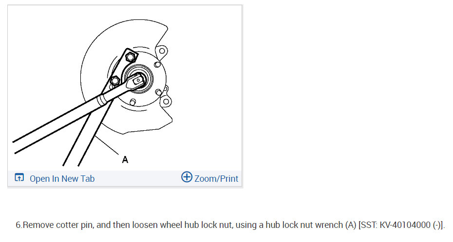

6.Remove cotter pin, and then loosen wheel hub lock nut, using a hub lock nut wrench (A) [SST: KV-40104000 (-)].
7.Patch wheel hub lock nut with a piece of wood. Hammer the wood to disengage wheel hub assembly from drive shaft.

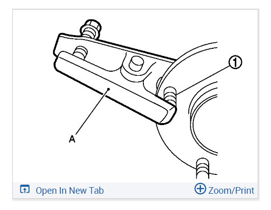

15.Remove hub bolts (1) from wheel hub assembly, using the ball joint remover (A) (commercial service tool).
CAUTION:
- Remove hub bolt only when necessary.
- Never hammer the hub bolt to avoid impact to the wheel hub assembly.
- Pull out the hub bolt in a direction perpendicular to the wheel hub assembly.

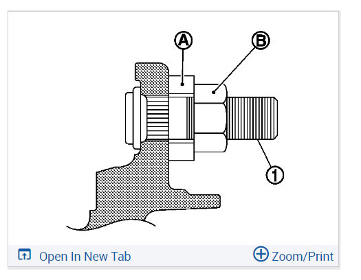

- Place a washer (A) as shown in the figure to install the hub bolts (1) by using the tightening force of the nut (B).
CAUTION:
- Check that there is no clearance between wheel hub assembly, and hub bolt.
- Never reuse hub bolt.

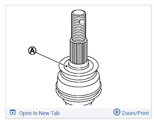

- Clean the matching surface of drive shaft, wheel hub assembly.
And then apply paste [service parts (440037S000)] to surface (A)
of joint sub-assembly of drive shaft.
CAUTION:
Apply paste to cover entire flat surface of joint sub-assembly of drive shaft.
Amount paste: 1.0 - 3.0 g (0.04 - 0.10 oz)
- Use the following torque range for tightening the wheel hub lock nut.
CAUTION:
- Since the drive shaft is assembled by press-fitting, use the tightening torque range for the wheel hub lock nut.
- Be sure to use torque wrench to tighten the wheel hub lock nut. Never use a power tool.

Check out the images (below). Let us know if you need anything else.

Yes, I finally got around to it last weekend and everything went smoothly thanks to your advice.
